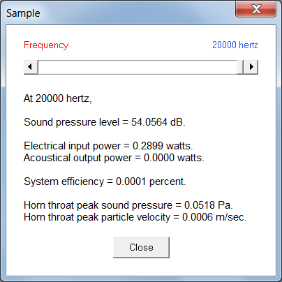

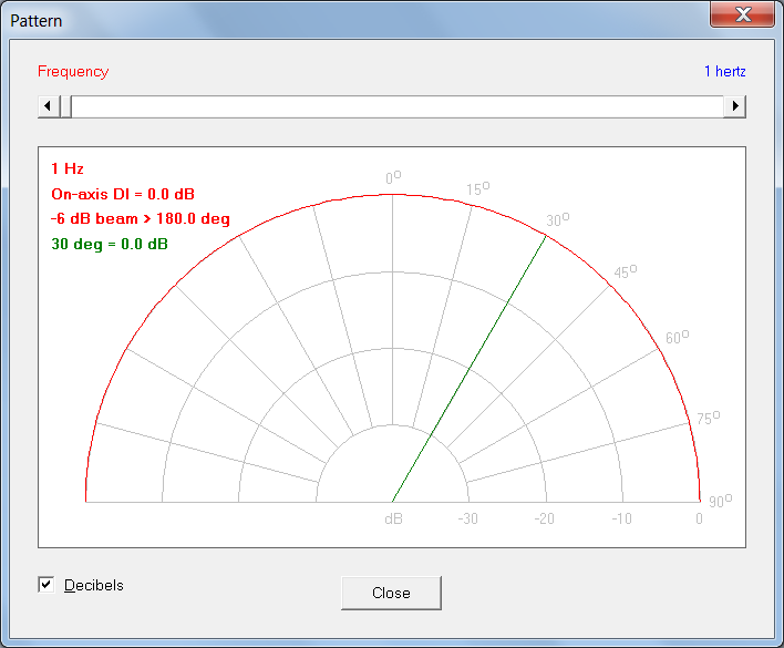

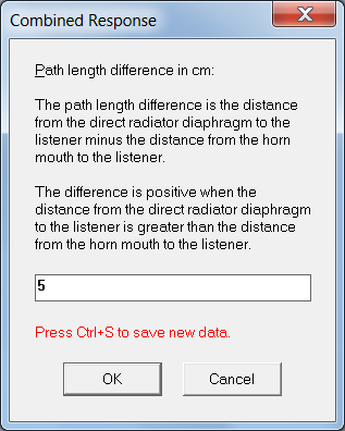

Hornresp Update 3410-140302
Hi Everyone,
CHANGE 1
The combined response 'path length difference' parameter value is now saved as part of the Hornresp.dat file permanent data record.
CHANGE 2
The Sample tool slider range is now 1 - 20000Hz rather than 0 - 19999Hz.
The Pattern tool slider range is now 1 - 20000Hz rather than 0 - 20000Hz.
CHANGE 3
Minor amendments have been made to the Loudspeaker and Filter wizard descriptions in the Help file.
Kind regards,
David

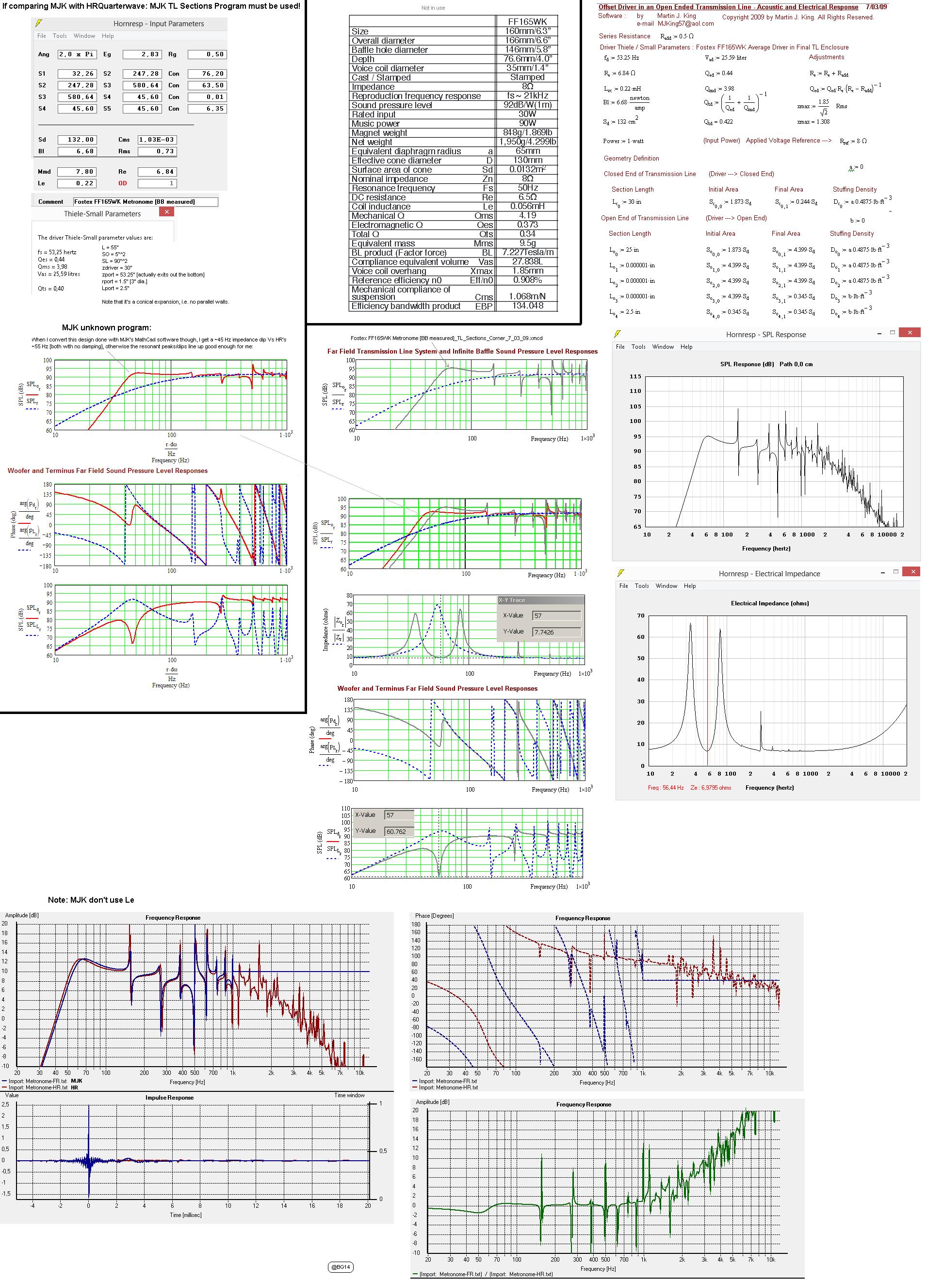

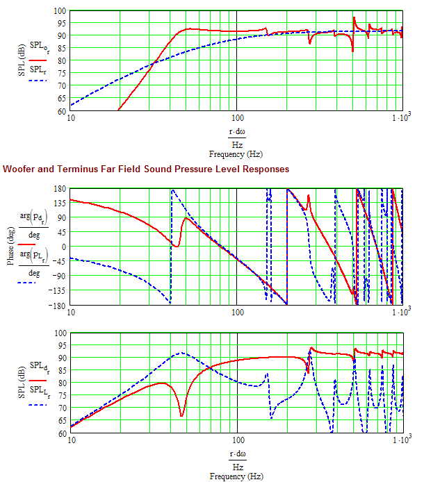

Greets!
Set out to make a Metronome design tutorial using HR to post here: http://www.diyaudio.com/forums/full-range/252162-modelling-metronome-hornresp.html
When I convert this design done with MJK's MathCad software though, I get a ~45 Hz impedance dip Vs HR’s ~55 Hz [both with no damping], otherwise the resonant peaks/dips line up good enough for me:
L = 55"
SO = 5"^2
SL = 90"^2
zdriver = 30"
zport = 53.25" [actually exits out the bottom]
rport = 1.5" [3" dia.]
Lport = 2.5"
Note that it’s a conical expansion, i.e. no parallel walls.
TIA,
GM
Hi GM,
Both Hornresp and AkAbak show the dip at ~55Hz.
It would seem that the design being simulated in Martin King's software must differ in some way from the design being simulated in Hornresp and AkAbak.
Kind regards,
David
Hi GM,
Kind regards,
David

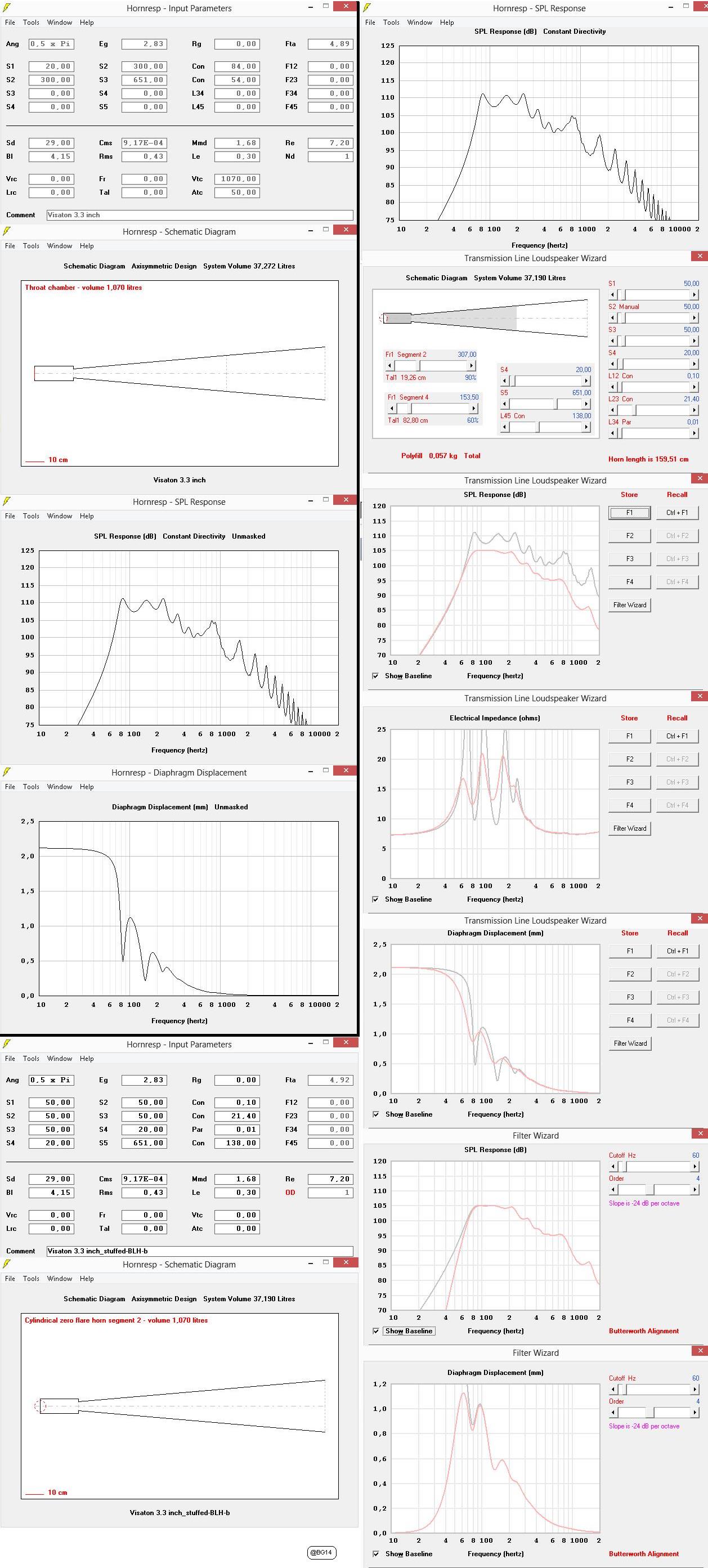

Hi David
I did try to sim a BLH with a small 3.3 inch speaker, I did also try to include damping because this is common in a BLH to damp reflections, but when I try it it do nothing on the graph.
Maybe there is a problem there?
Software go really professional I see, congratulations for keep the simplicity also.

Hi GM,
Kind regards,
David
Greets!
Yeah, I got that far, but was wondering from the math used how the harmonic structure could line up with a ~10 Hz difference fundamental.
GM
Hi Kees,
Absorbent filling material can only be included in an offset driver or tapped horn Loudspeaker Wizard simulation. You will need to convert your backloaded horn to an equivalent offset driver configuration as shown by bjorno, if you wish to add damping to the horn.
I am currently looking at how much work would be involved in extending the Hornresp absorbent filling functionality to all horn types, not just offset driver and tapped horns.
Kind regards,
David
Hi GM,
It seems to have something to do with how the design was modelled in the MJK software. As bjorno has shown, the MJK fundamental frequency moves much closer to the Hornresp result when the MJK model is changed.
Kind regards,
David
