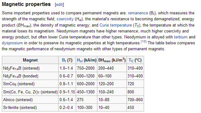

the magnet technology was very good.I thought the most old speakers has not so strong magnet because of technologie was not so good as in these days...........
That was why they got good performance from very low power inputs.
The ONLY reason to go to ceramic magnets is to SAVE money.
I replaced my Richard Allan Pavanne with the Tannoy Berkley.
I was very surprised to "hear" that the high efficiency Tannoy needed quite a bit more power/voltage than the Pavanne for the same sound output.
Taken from
Neodymium magnet - Wikipedia, the free encyclopedia
I tried to put this table in bbcode in here, but failed, does anybody know how to do it? It used to work just like HTML by just changing > to ] etc, but I have not luck with this method.

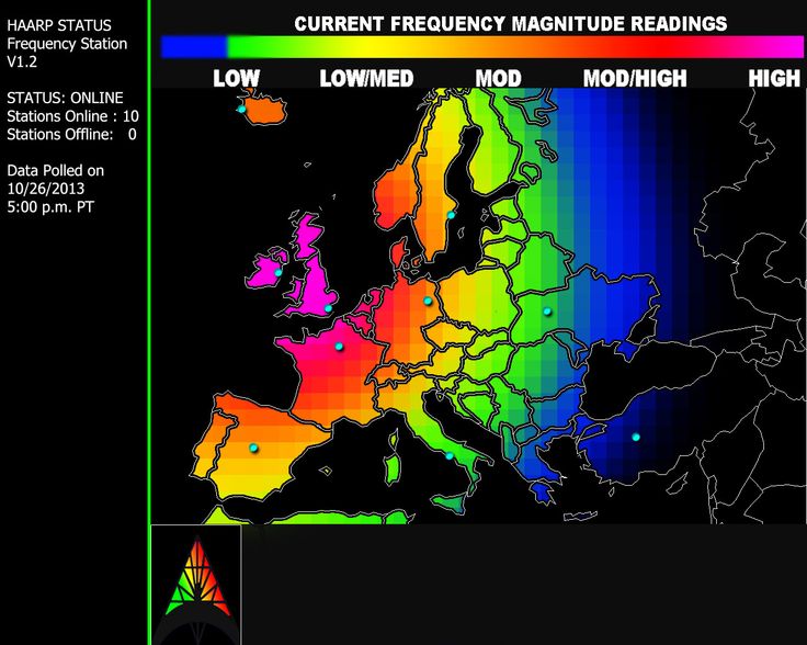

It is offtopic but!
This do work, the Haarp is pointed on England, see there the wether, and here, we have the softest stormy wether ever.
I did mention that on weatherspace and twitter and the photo is gone!!!. that photo is included in post.
http://www.theweatherspace.com/haarpstatus-europe/
regards
kees

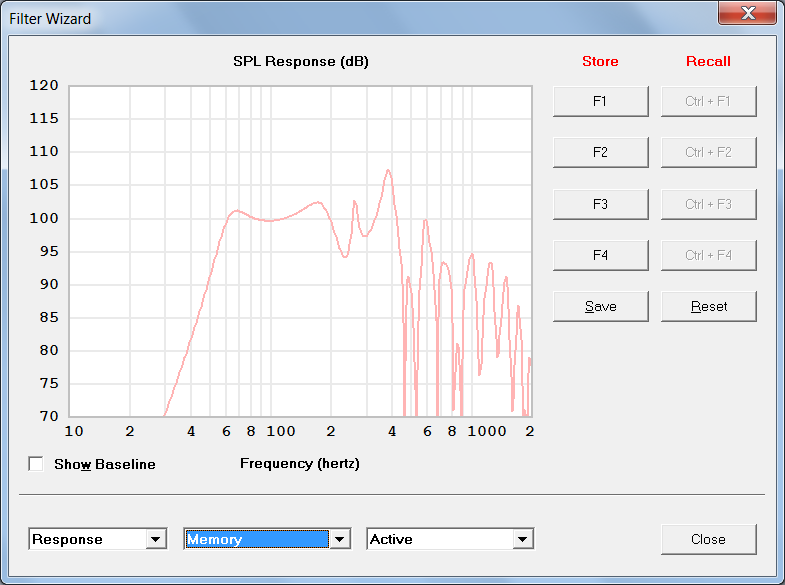

Hornresp Update 3400-140212
Hi Everyone,
CHANGE 1
Loudspeaker Wizard absorbent filling material values are now saved as part of the permanent data record. Existing Hornresp.dat data files will be automatically updated to the new format - no action is required by the user.
CHANGE 2
Filter Wizard settings can now be saved as part of the permanent data record. Existing Hornresp.dat data files will be automatically updated to the new format - no action is required by the user.
Click the Save button in the Filter Wizard Memory window to permanently save the current settings. Click the Reset button in the Memory window to reset current settings back to the saved settings. Press the F5 function key to restore all controls to their initial default settings.
The F1 to F4 and Ctrl+F1 to Ctrl+F4 temporary memory Store and Recall functionality now applies to all filter types, not just to passive filters.
CHANGE 3
The combined response system efficiency bug described in Post #4179 has now been fixed. My thanks to Sabbelbacke for reporting the problem.
NOTE
It is recommended that users study the Loudspeaker and Filter Wizard sections in the Hornresp Help file to fully understand the features now available in these tools.
