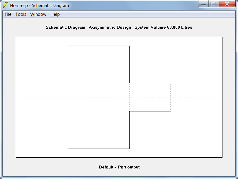

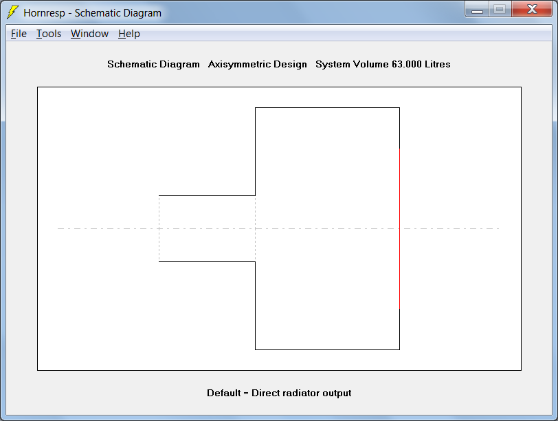

Isn't the default output the direct output, and output 2 the port output?Weltersys, no the choises are "default", "output 2" and "combined".
No default output is port output.

My mistake, remembered wrong.No default output is port output.
Hi Art,
I think your memory is probably fine 🙂.
The default output is determined by how the system is specified in Hornresp.
Attachment 1 - Direct radiator output is the default.
Attachment 2 - Port output is the default.
Kind regards,
David

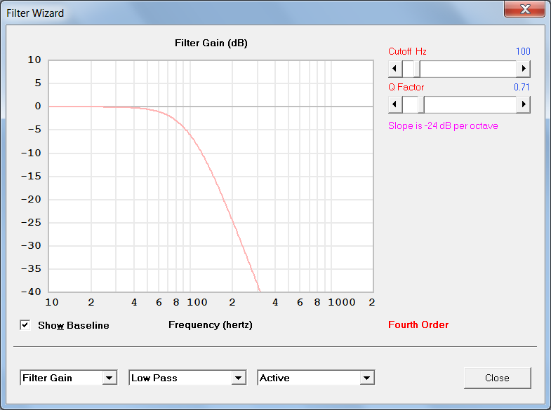

Hornresp Update 3340-140120
Hi Everyone,
Having already spent many more hours working on the Filter Wizard than originally planned, despite my best intentions I reluctantly came to the conclusion that adding a few extra hours at this late stage couldn’t possibly make matters any worse 🙂. Accordingly, the changes described below have been implemented. The Filter Wizard now has 8563 lines of code equivalent to 143 pages when printed out. So much for my lack of interest in filters...
The logic and code controlling the wizard user interface is now quite complex. I have tested every scenario and condition I can think of, but no doubt I will have overlooked something. Could you please let me know if you find any bugs or notice any inconsistencies in the operation of the wizard - thanks.
CHANGE 1
Filter Wizard settings are retained between calls when the wizard is exited by pressing the Close button. Settings are not retained if the wizard is exited by clicking the 'X' control box or by pressing the Esc key .
CHANGE 2
Two additional generalised active filter options have been included. They are called simply 'Second Order' and 'Fourth Order', and enable second and fourth order low pass, high pass and band pass filters to be specified using cutoff frequency and quality factor as inputs (see Attachment 1).
Notes:
When a Q Factor of 0.71 is specified, the Filter Wizard actually uses the more precise value of 1 / (2 ^ 0.5) in the calculations.
A second order filter with Q = 0.50 is equivalent to a second order Linkwitz-Riley filter.
A second order filter with Q = 0.71 is equivalent to a second order Butterworth filter.
A fourth order filter with Q = 0.71 is equivalent to a fourth order Linkwitz-Riley filter.

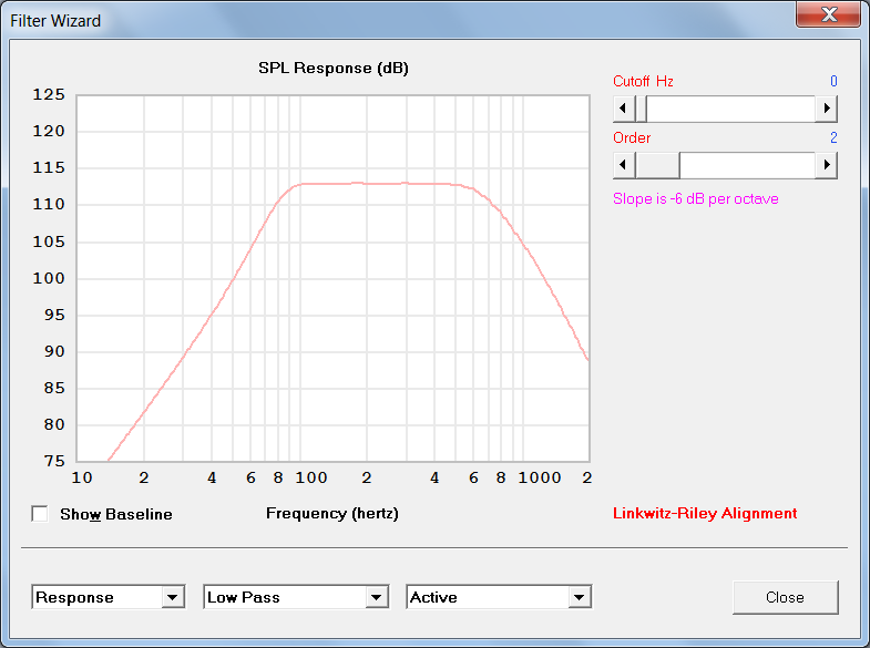

CHANGE 3
When the Filter Wizard active filter alignment label was double-clicked to switch from First Order Butterworth to Second Order Linkwitz-Riley, the slope label did not change from -6 dB per octave to -12 dB per octave (see Attachment 2). This bug has now been fixed.

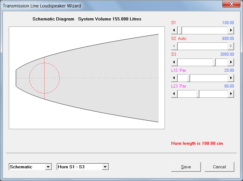

I made a simulation of a TL successfully dampening the first third of the cabinet. However, simulating a MLTL cannot be done since there are not enough sections :-(.
Hi Mårten,
Am I correct in assuming that in your design above, ideally you would like to be able to partially fill segment 2 with absorbent material, from S2 to the red line?
Kind regards,
David
You are correct David.

In fact there is. Quite often I do parabolic designs with offset driver. The angle of the first section is the same as the second section. It would be nice to be able to tell Hornresp that two or more sections should have the same expansion rate, and let Hornresp decide the areas between these sections.
Hi Mårten,
Double-click on the red 'S2 Manual' slider label. In 'S2 Auto' mode the flare rates of segments 1 and 2 become the same, and the value of L12 can be changed without altering the overall flare rate or length.
There is no need to specify more than two segments in an offset driver design if the segments are to have the same expansion rate.
