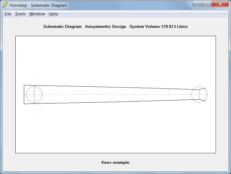

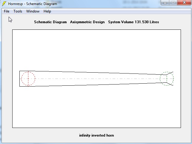

Hi Kees,
It was 43.1 degrees Celsius here yesterday - heatwave conditions 🙂.
Don't use the Uni width flare setting if you want parallel sides - see the following post:
http://www.diyaudio.com/forums/subwoofers/119854-hornresp-403.html#post3765069
For the purposes of the simulation, assume that the final vertical opening as shown in your SketchUp drawing is the horn mouth S4. This means that S4 will be larger than 182 sq cm and that the axial path length L34 from S3 to S4 will curve through 90 degrees, and be considerably longer than 0.1 cm.
Your simulation schematic should look more like the one shown in the attached example screenprint.

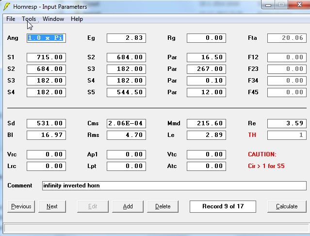

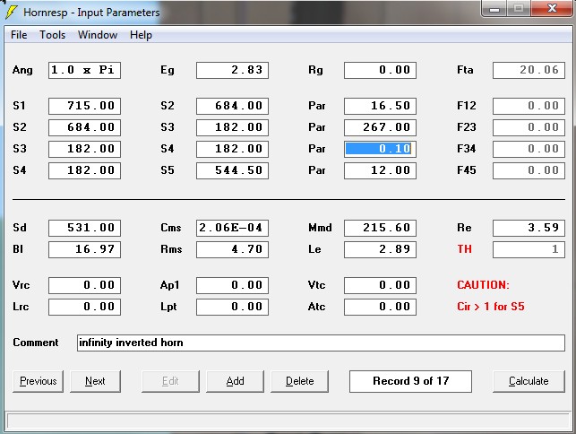

I hope it is not so cold there,
I have again strange outcomes, and I do not now excactly why, there also so much digits after the comma (0.1mm)
see in txt file the width who needs to be 16.50 cm but change over in S2 to S3 and go again to 16.50 cm in S4, it needs 16.50 all over the length, it did not, with con flare the width is oke whole length 16.50 cm x 2 see con-uni-test.zip..
Another question is, when S4 is very short and end in the middle of the speaker do i need to measure there for calculated surface? (see picture.) opening in the half of the speaker I did measure as 182 square cm, the bigger opening of the rest I see as just opening for speaker other half who is outside the horn like on hornresp schematic.
Kind regards,
David

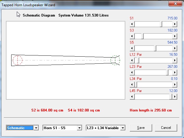

Hi Kees,
Kind regards,
David

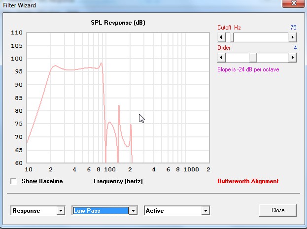

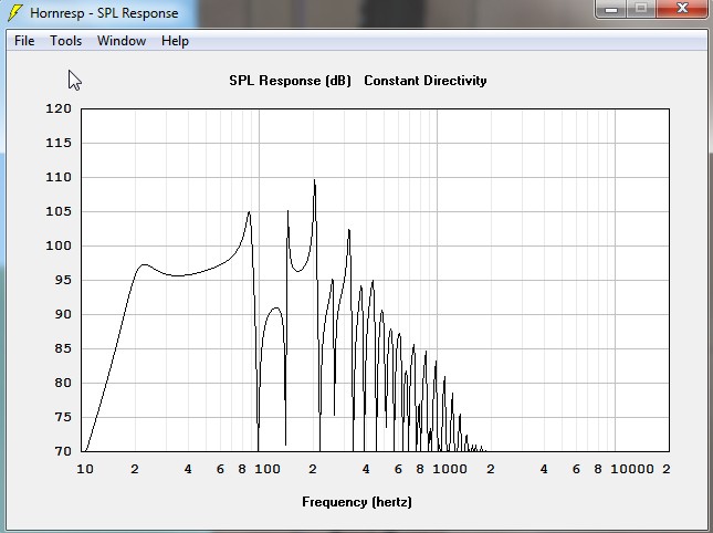

Wauw 43 degrees. euhh no that is also to extreme, here it is now 9 degrees and sun, very nice work or walk weather.
Much people here say use uni export for tapped horns with same width boxes, also for T-TQWT, others say different things. I do now when using conical I get good numbers with export same width, but what I have to do precisely I have afcourse believe the program writer because he is the master and professor here.
The last example you did give, I have tryed already and it give no change in respons except it is more efficienty, I have S4 coupled to center of speaker, I think I go build this one for test, it is promising respons to 20 Hz and it is small.. I have now use this as you did offer in your last post, as on picture you can see the hornresp output as this is how the box is drawn, looks nice now om hornresp only I get error, see picture.
After this test tapped horn is next, with a wideband little horn from 70 Hz to 20 Khz.
How easy can I fool hornresp giving good respons but not in reality>? is this possible, nice question is'n it.
Thanks for your respond and enjoy warm weather, or not? hot hot, where do you live? america has a little ice-age..
regards.
Response with a 24 dB oct low pass filter, this box want active amp, not a problem I get a very nice all-fet amp single ended drivers. I do not now however is there a need for stereo subwoofers? everything above 100 hz is mono? still? after introduction of digital superaudio, I think to go stereo so deepness and hall effect is present.
