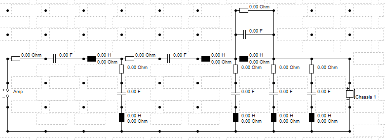

Yes, in your design, it´s possible. One could:
1 highpass up to 2. order
1 lowpass up to 2. order
or 1 highpass up to 4.order
or 1 lowpass up to 4. order
Notch, HF uprising is not possible, in Jean-Michel´s scheme, it is (but there the lowpass is missing). Combinig both would give more possibility (2 x 4.order filtering plus 2 x Imp EQ, Notch and HF-EQ, allpass alltogether are still not possible, but you have do draw the line somewhere...).
One suggestion: if each series LRC-branch in David's template could optionally be changed to a parallel RLC circuit, we could get quite a bit more flexibility.
Hi Bjørn,
Thanks for the suggestion. It would complicate things a bit, but it might just be manageable.
Kind regards,
David
Hi Sabbelbacke,
I agree that the line has to be drawn somewhere 🙂.
Perhaps the inclusion of Bjørn's suggestion would be a sensible compromise.
Kind regards,
David

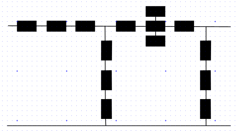

In this Case, if every "slot" is changeable between R/C/L, then this would cover most cases:
Of course, if you go this far, you are not far away from the total flexible matrix-soultion, where you are free to do anything 🙂

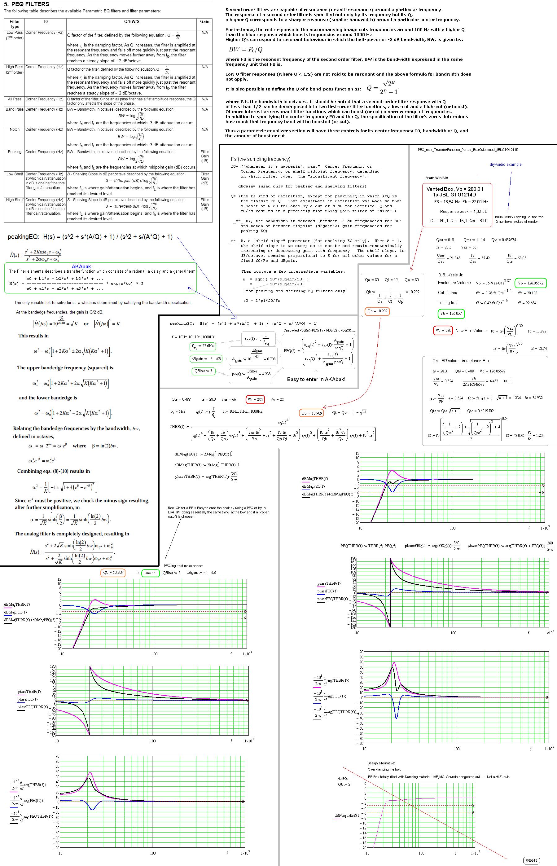

that would suffice.Not necessarily. The calculations can be almost the same, the active part can simply be fed to a constant impedance instead of the changing one on a real speaker.
How about implenenting a plugin interface at Rg and Re, so every filter one desires can be flunged in there, let´s build some VST Interface, this way David doesn´t have to do the filterstuff himself an we can even implement FIR Filtering (hihi, just playing with my mind, just kidding).
i tryed bjorno's method but i can get it to work.
the way i do it now is to get aprrox the same excursion curve in winisd(around near fb),and simulate a hpf (and eq) to see if excursion is below the first peak after the first dip.🙄
edit /to make it clear.
Hi epa,
Sounds like AkAbak would be easier than that. 🙂
i'm not sur but doesn't akabak do a passive filter?
if not that would indeed be easyer,tnx.
also how do you get a parametric eq in akabak?
Hi, AkAbak do passive or active filters. Here is a suggestion of a PEQ that should be entered into AkAbak like for an HPF or LPF active filter using Laplace transform:
