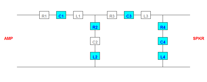

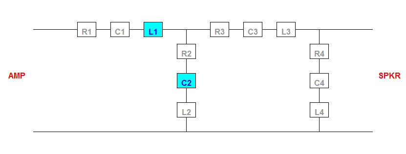

With regard to Jean-Michel's comment, would it be sufficient to be able to specify a passive filter in accordance with the attached network template, with only those components actually required being included?
If so, then a real time 'Filter Wizard' could be quite a nice thing to have... 🙂.
R = resistor, C =capacitor, L = inductor.
Kind regards,
David

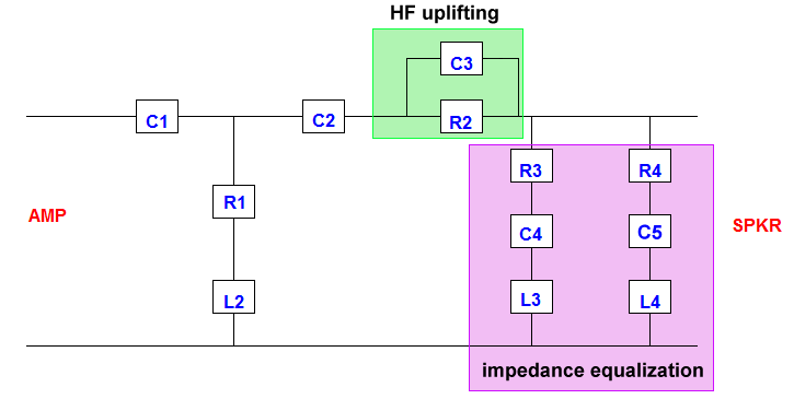

If we limit the choice to a high pass filter, with a few more components than in your schematics we can also provide impedance equalization and HF uplifting.
(I put 2 RLC impedance equalizors but one could eventually be enough, even if with horns there is often more than 2 peaks of impedance).
Hi Jean-Michel,
Thanks for the feedback.
If I understand correctly, the two HF uplift components are the only ones missing from my template (if we assume that only one RLC impedance equaliser is required).
Would the template still be worth having even if HF uplifting was not allowed for?
Kind regards,
David

Hi Everyone,
Thanks for all your filter comments. If anything was to be done in Hornresp, the functionality would be confined to passive filters comprised of pure resistors, capacitors and inductors, and most probably be restricted to networks that can be specified within the 12 component template previously posted.
So don't get too excited... 🙂.
Kind regards,
David
Hi Jean-Michel,
Kind regards,
David
Hello David,
Your template will be definitevely worth.
Eventually for every RLC circuit a wizzard could be opened at demand in order to introduce the resonance frequency and Q...
Circuit Theory/RLC Circuits - Wikibooks, open books for an open world
Best regards from Paris, France
Jean-Michel Le Cléac'h

Hi Jean-Michel,
Thanks for confirming that the 12 component template would still be of some value.
The filter tool would show the SPL response and the diaphragm displacement resulting from having a filter network between the amplifier output and the loudspeaker input. The tool would accept R, C and L component values as specified by the user, but not deal with resonance frequency and Q values.
Kind regards,
