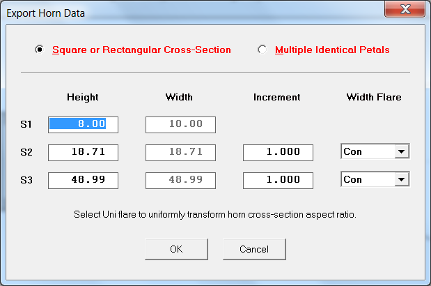

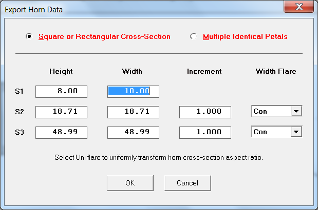

Many thanks for the example - the problem was confined to negative flare parabolic horn segments only. The bug has now been fixed - Product Number 2910-120902 refers.
The latest release also includes a change to the schematic diagram horn data export functionality. Previously the width of a rectangular cross-section could only be specified indirectly by entering the height (see attachment 1). Now either the height or width dimension can be entered directly (see attachment 2) .

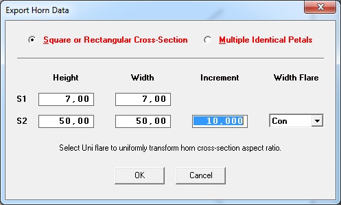

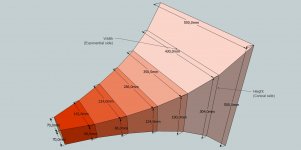

Am I doing this correctly?
I'm guessing the increments are on the axis going through the center of the horn?!
Hi Daniel,
You are correct in your thinking.
Starting with S1 = 49, S2 = 2500 and L12(Exp) = 60 , I get a slightly different result to yours, but nothing to worry about.
Length...Height...Width
0...........70........70
100........67.......142
200........85.......213
300........123.....285
400........189.....357
500........303.....428
600........500.....500
Kind regards,
David

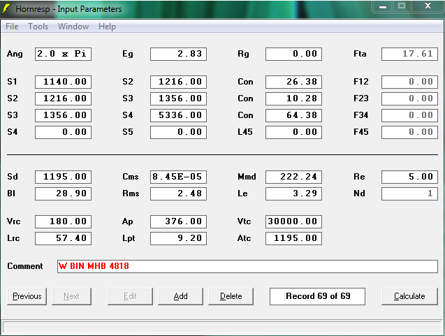

I want to use this cabinet to match speaker i have.
I want guidance for hornresp input.
I have done but i think i need some guidance specially for ATC.
Please tell me if my hornresp inputs are correct or not?
So i need master's( David McBean) guidance if possible.

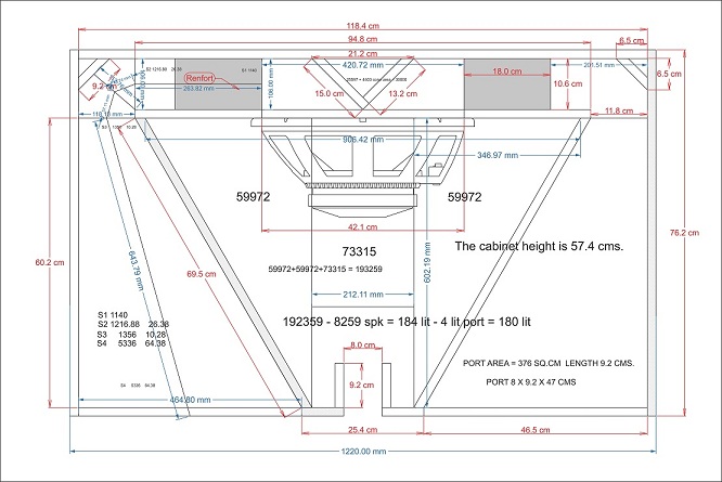

Thanks Dan,
I calculated the area marked as Vtc.
The calculation is as under
42.07 width till horn starts
10.6 height
57.4 depth of the box.
so it calculated as 42.07 x 10.6 x 57.4 = 25597 + added speaker volume 4403.
So i rounded as 30000.
The triangle volume i adjusted towards round cutout of plywood .
Pl. correct me.
