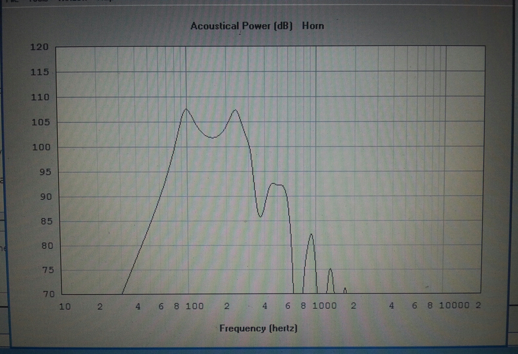

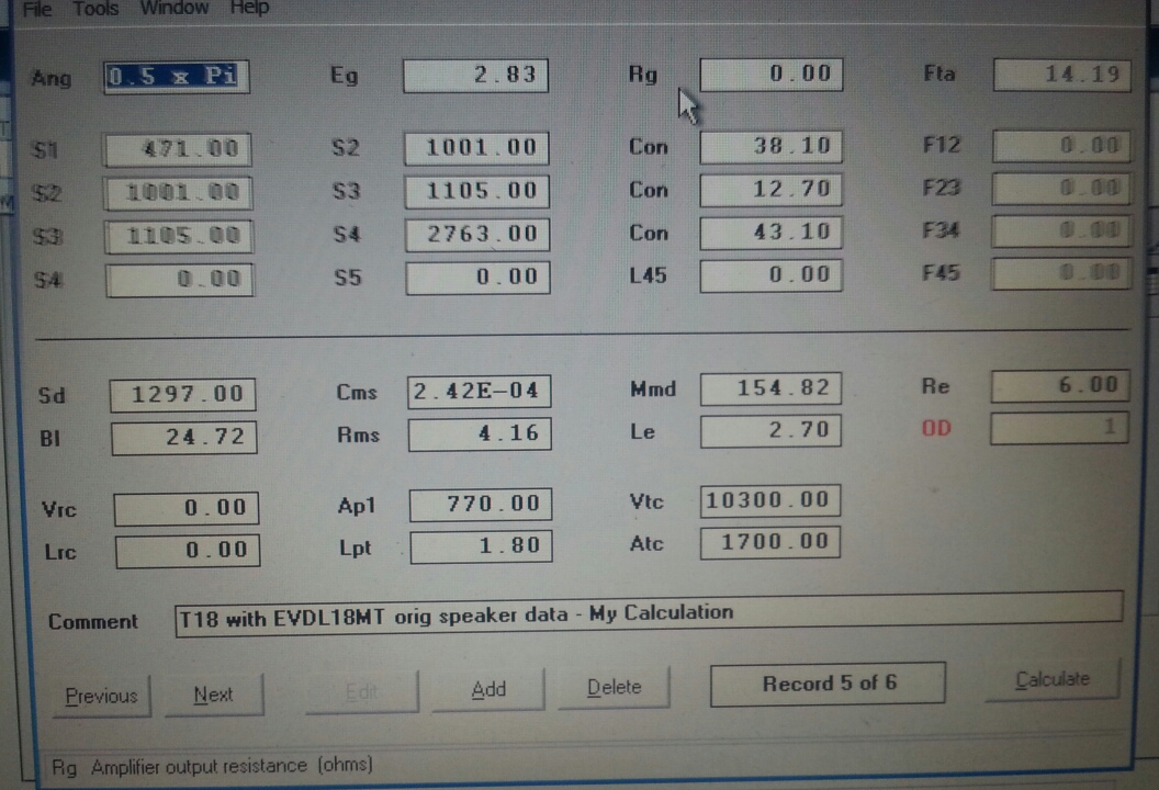

These are the inputs to hornresp and the SPL wihich is not what i expect of EV-T18s
are the inputs provided correct..??
Well, one reason is you need to use the tapped horn driver [TH] option, not offset [OD]............. Sorry, don't have time ATM to check the rest.

Any gurus who can tell if the inputs provided are correct, especially for the volume, Vtc, AP1, Atc, Lpt and s1-s2, and or shoul it be sim as tapped.

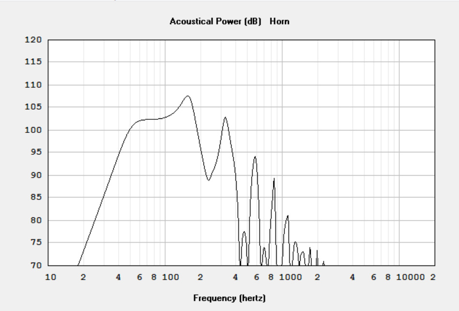

response of my posted input screen, with dayton pa 460 driver, 2 pi, 2.83v
far better than the posted chart (assuming posted is 2 pi)

we have told you exactly what to fix with your screen.
you did not copy VTC right. add a 0 to your result (you curently have 10.3 liters, not 103 liters).
change to TH
Change con segments to PAR

But T18 has a big Chamber of about i suppose 85lit approx, i also changed to PAR still the same

Pic 1 - using Sine's inputs, simulated as TH (dark black) vs Nd (light grey)
Notice the remarkable resemblance in the TH sim vs the response graph you posted in post 14 (copied and pasted here on the Hornresp sim) and the lack of accuracy when simulated as Nd.
Pic 2 - simulated at 2.83V (dark black) vs 2.37V (light grey) the latter of which is actually 1 watt, and remember this is a different driver than the original
Assuming the input dimensions are all as correct as they can be, it looks like Sine nailed it, which really isn't a surprise since he's got skillz like that.

You are still missing a 0 in the Vtc, so you are simulating the chamber 10x smaller than it's supposed to be. You've already been told this twice.
Copy the inputs from post 15 exactly (like I did) and you will get the same result I've shown in the last post.
EDIT - just be be really really clear about this, Vtc is supposed to be 103000, not 10300.

Not by Danley's definition, no. But call it a tapped horn, a special tapped horn, a tapped BLH, a 6th order alignment, a bandpass, a reflex box with a horn port and the driver in the port, or any of a number of other things, it's just a name, and there is no formal name for this so it doesn't really matter what you call it, and names are not that important anyway since all named alignments morph into something else at some point that's not always clearly defined.
The important thing is that it needs to simulated as TH in Hornresp. Or ideally simulated in Akabak.
