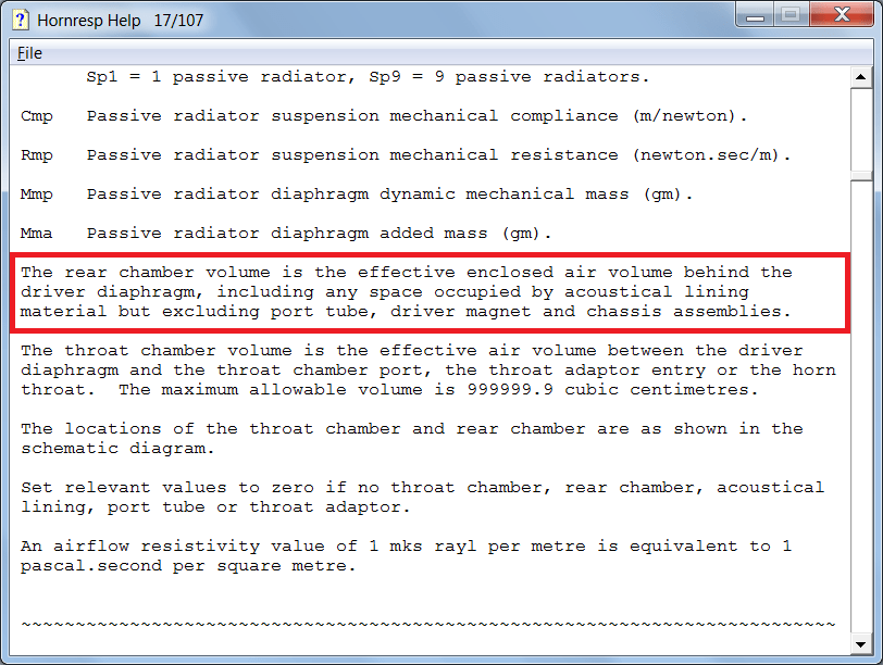

If I want to model “Rear Vented” with tube length "Lpt" placed inside the cabinet, do I need to subtract its volume from the acoustic volume Vrc of the cabinet?

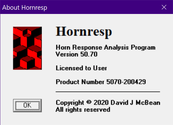

AWESOME work HK! That BP8 section is CRAZY! Thank you again for such wonder tool DMB! I rarely work with the latest versions of HR. I do 95% of my modeling on version 50.70. The J O B will not let me update the program on T H E I R laptop. I rarely use M Y laptop. I think I turned in on once or twice in February. I haven't touched in March.

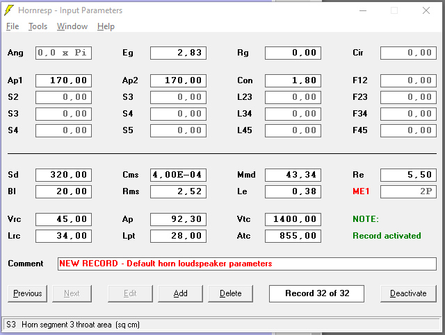

I'm feebly trying to get to know the program and simulate another driver for Scott Hinsons "MEH" and this is what I have on my screen:
Window button only shows 'Input Parameters' option. I am clearly missing something fundamental here..
Program version is 55.10

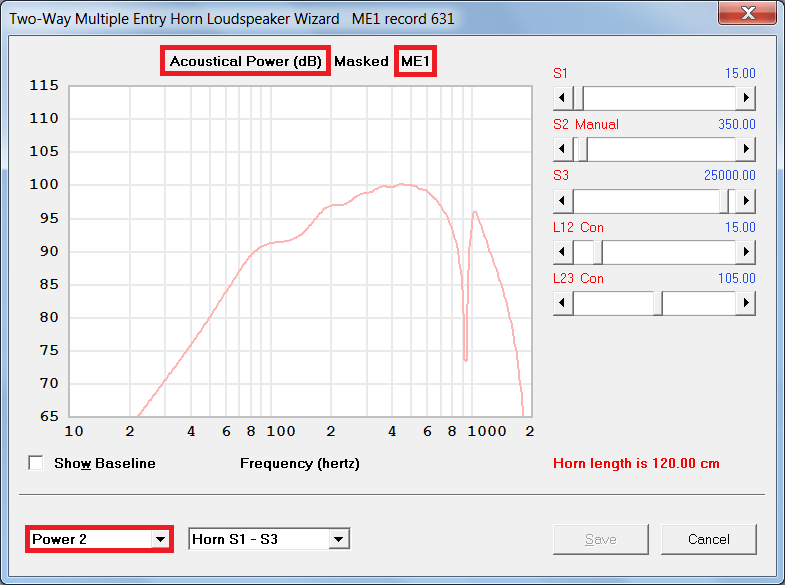

With the ME1 record activated, go to the Nd record specifying the HF driver or drivers at the horn throat, click the Edit button and then select the Multiple Entry Horn Wizard from the Tools menu.
See the 'Multiple Entry Horn Wizard' and 'Two-Way or Three-Way Multiple Entry Horn' sections in the Hornresp Help file for further details.
(Note that you can create a MEH template using the Input Wizard under the Help menu, and then adjust the input parameter values in the Nd and ME records to suit your specific design).
