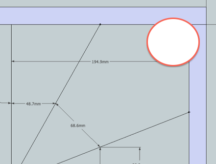

Is that still the flare that I had in Post #127 w/ a 7.238 degree angle, what is the drawn material thickness (the 19.0mm is @ an angle to the board), what are the outside dimensions of the finished box?
Going around the bend you go from 173.2-90°-194.9-19.2-196.7-90°-201.5. That's close, but doesn't look quite correct yet. 1st bend difference 194.9-173.2=21.7 - 2nd bend difference 201.5-196.7=4.8; the difference should be greater in the second bend, so something is amiss.
In the real world this doesn't matter, but you're trying to get it perfect in SketchUp.

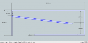

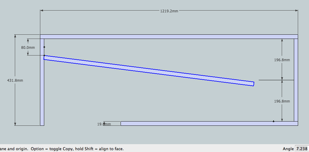

Hey, I'm back again. I didn't die, and I am not giving up on this. I even got some new eye glasses, so here we go:
Oliver, I am starting over again. Here is what I have:
- An cabinet with exterior dimensions of 1219.2mm x 431.8mm, built with 19mm thick plywood.
- The baffle board is currently 1000mm (it will have to be trimmed) also built with 19mm plywood.
- I mount the bottom end of the baffle board to the bottom of the cabinet, offsetting it 80mm from the rear of the cabinet.
- Then I angle the baffle board 7.238 degrees (as you had suggested in post #127).
- But either something is wrong here, or I am completely misunderstanding the proper folding of a tapped horn.
- The interior depth of the cabinet is 393.6mm, so you can see from the attached drawing that I put a center line in, spaced 196.8mm from the front and back of the cabinet.
- Look at the baffle board in relationship to the centerline I drew. I believe the baffle board should be closer to the rear of the cabinet at it's end point, because the horn path is constantly expanding and it need a bigger area as it goes over the bend. But instead, the baffle board is closer to the front of the cabinet.
So, what is wrong here? Thanks.
Hi DHAA,
Post #127 - shows a horn flare
Post #152 - shows a first step at laying out the enclosure (but, as it says, it is not there yet).
Post #268 - You are defining the exterior dimensions as: 1219.2mm x 431.8mm x 431.6mm (interior depth 393.6mm + 2x19mm walls), and you are saying you are using a 7.238° baffle board angle. You have placed the horn mouth to the side.
I don't think Post #268 is derived from the flare shown in Posts #127/152 so there is no 7.238° angle requirement.
It's an iterrative process:
1. You design in Hornresp, export a flare, adopt a basic layout (e.g.: single fold as you are trying now), and let the wood fall where it may.
2. You start out as in 1. above, but adjust the flare to fit an arbitrary set of dimensions in wood. Then you take the new length and area dimensions back into Hornresp to see what you got.
I think you are trying 1. and 2. at the same time, that will most likely not work.

Hi DHAA,
I agree the back and forth w/ metric and imperial dimensions gets to be confusing.
I just looked at your last post again, and you are doing 17"x17"x48" as in the original attempt. The final for that is in Post #62. Note the different S1 duct height, and the different baffle angle.
It's probably best if you start from scratch. That way we'll have a specific Hornresp Input to refer to, etc.. And we'll use whatever dimension scheme you want to use.
