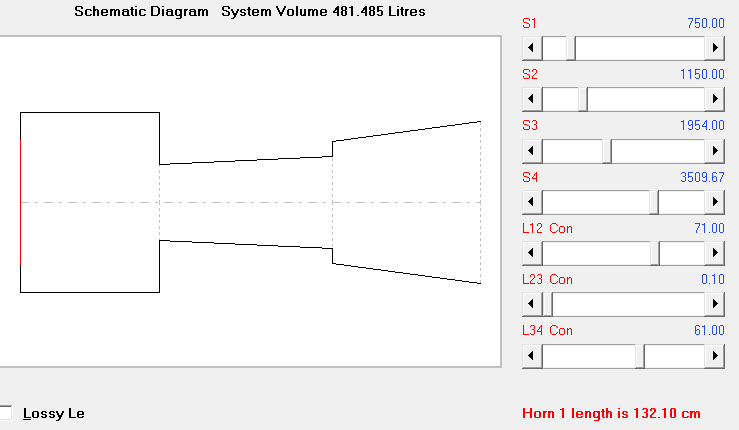

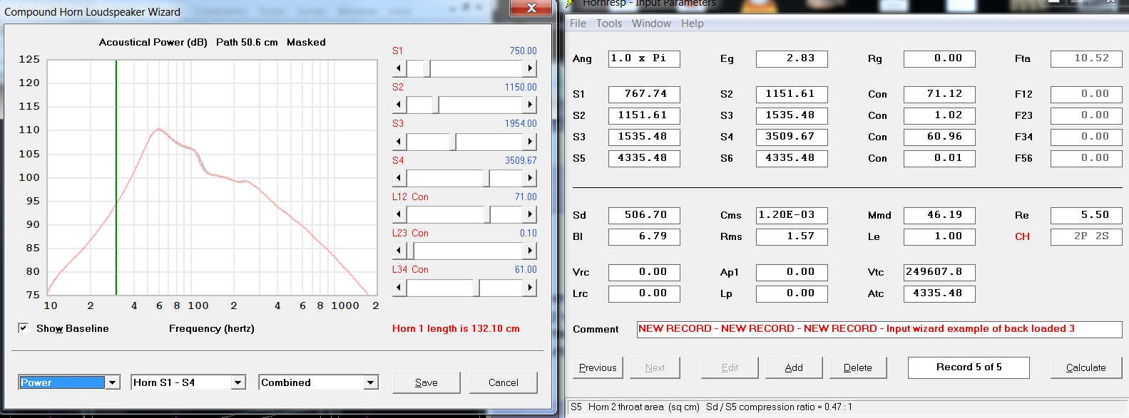

DemoMan,Okay, I'm pretty sure I entered everything that I'm now familiar with into the formula fields properly, and these are the results. As far as I can see, they are virtually identical to our previous CH model.

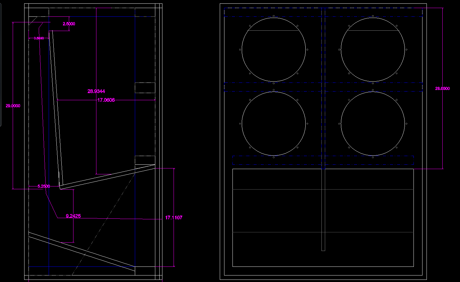

You entered the S1-S2 length as 71.12, and S2-S3 as only 1.02, a reversal of the expansion. S3-S4 should be the lower turn (around 8"), which is not as great of an expansion or length as indicated, S5-S6 should be the final expansion on the bottom cabinet, around 17", not .01.
After fixing the port/horn dimensions, good to also check the overall cabinet volume conforms to "as built".
Art
DemoMan,
Pretty sure I got it right, Art...
The Loudspeaker Wizard lets you see the results, and to my eye, its as close as this program will allow us to get.
The lower horn begins about a third larger, than the upper ends at... so the s2/s3 thing is simply a transition.
See what you think:

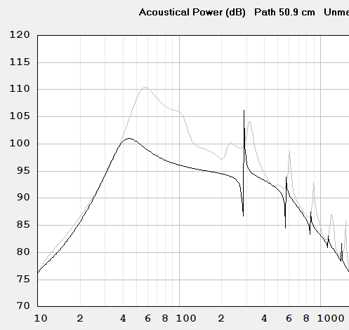

This is the result of modeling the box as it originally was configured. Just a straight bass reflex, with a simple port slot at the bottom. The light gray, is the result of enlarging the existing horn/port volume... basically turning it into a short offset horn:
Bass Reflex, AKA vented/ported speaker alignment [tuning].
Systems have a quality [Q] factor and for audio speaker systems a roll off slope with a Qt = 0.5 is transient perfect = 'critically' damped [no 'ringing'], with lower = over-damped, ergo above = under-damped and 0.707 = max flat, though before T/S this was considered 'critically' damped. No clue why the change.
Right, hugely under-damped with a 2+ Qt and tuned much too high:

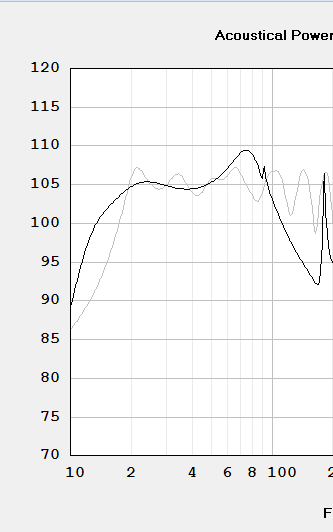

I don't think I'd complain if I could get something like your ".07"ish output, right down at 20hz. That is, if the rest of the band I need to use was reasonably flat, and the SPL was up there. But no matter what I do, I cant seem to get these drivers to produce the right kind of curve in Hr....
I remember that we used a Cerwin Vega "Bass Turbocharger" with these boxes. It gave us a 5db boost around 30hz, and a 12db per octave rolloff below 20hz. Sound was just about perfect after we added that to the system.
You might complain about the ~552 ft^3 size though [download file into IMPORT folder to open]: 16 Hz BLH
Lol... A 27' horn, with a 100 square foot mouth..? Well, I'll say this... you did get'er "damped".
But that's a mighty big shock absorber. On the other hand, I'll bet it would sound good, if you could find a place to put it.
Hmm... vs a 130 cubic foot bass reflex:
