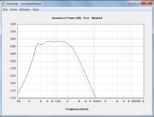

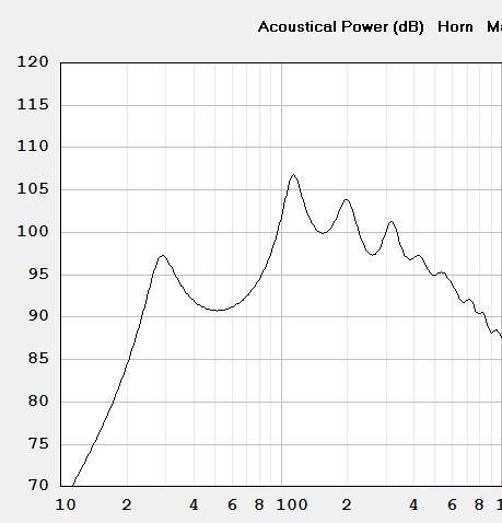

Found this on the Internet yesterday while looking up some other info... Sure makes my results look anemic:

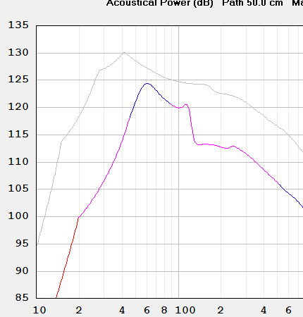

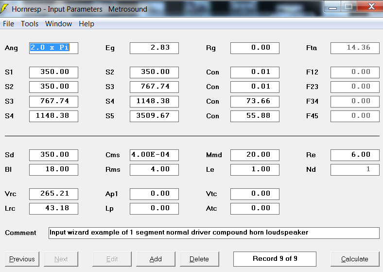

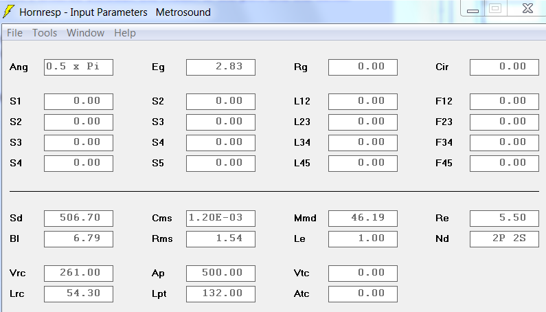

Brian, I tried to do as you said, but the output is way off. Here are my parameters, and the resulting graph:

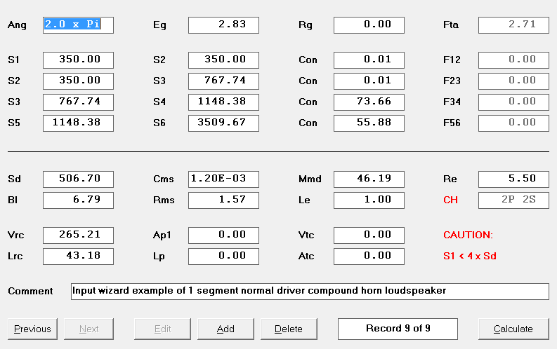

You entered Nd (number of drivers) as "1", but your bin has four.Here are my parameters...
The Bl (magnetic strength) looks high at 18 for a 16 oz. ceramic magnet, you had it as 6.79 in post #23, and Sd was 506.7, but dropped to 350.
Okay Art, you're right...
Except I didn't enter those mesurments, Hornresp did, when I used the Input Wizard to change type of cabinet, and I just didn't notice it. It was the only way I could figure out how to make the change.

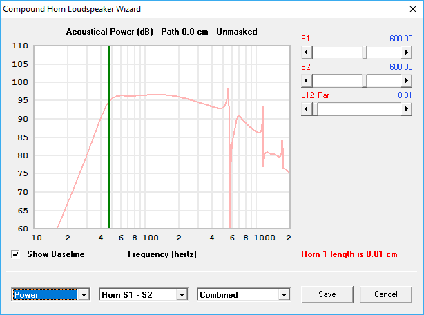

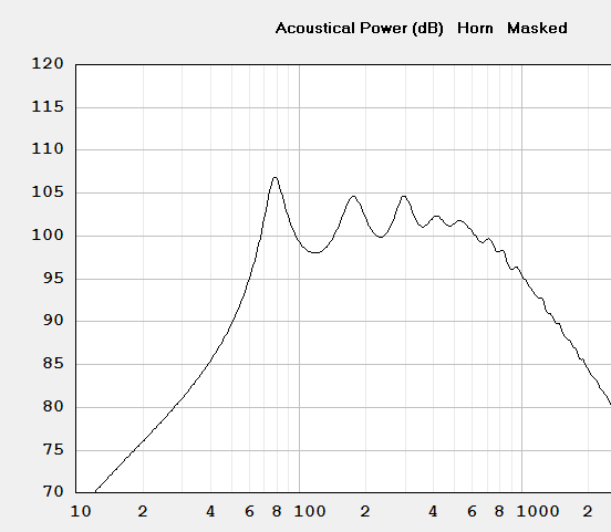

Back to the correct driver settings now, and there is a marked improvement, although the results are still pretty pathetic:
Did you change the horn type from ND to CH?
Considering the LF rises down to about 28 Hz, it would have counteracted the lack of LF on most vinyl records back in the daze you were using the quad ;^)Back to the correct driver settings now, and there is a marked improvement, although the results are still pretty pathetic:
By the way, the horn segments should be entered as Par (parabolic) instead of Con (conical) since two of the horn walls are parallel, though it won't make much difference. The ND to CH might be a different story..

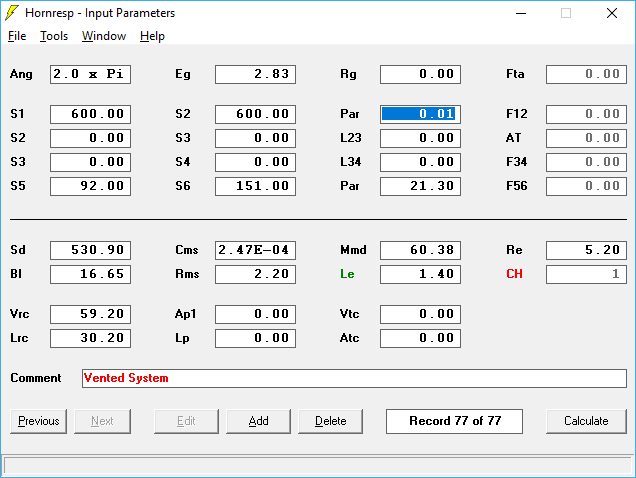

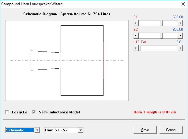

Attached is an example of a Hornresp sim of a vented box with a simple expanding vent. If you want to model one with a more complex expanding vent, you'll need to use S1-S4 to describe the vent, and Vtc and Atc to define the volume of the box (and set Vrc to zero).

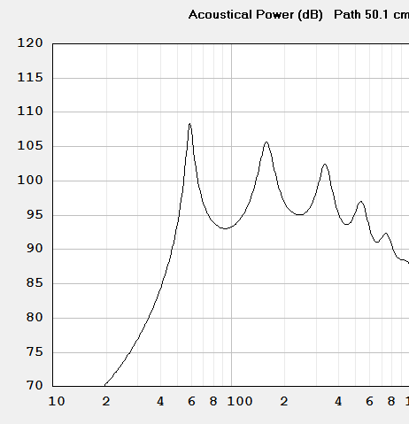

Um, no... but I have now, and that kind of put us back where we started.
I'm going to play with those revised horn parameters you suggested now, and see if that will get us a little closer to reality.

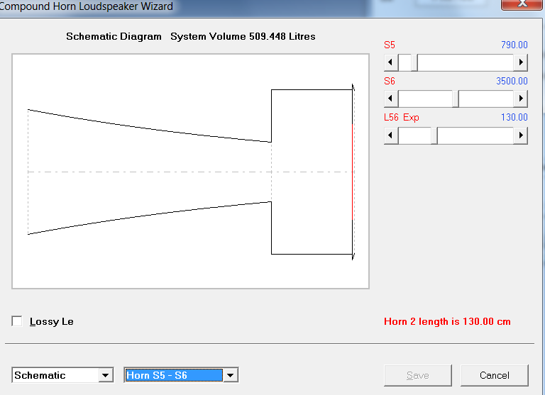

Okay, pretty sure I have everything set right now...
My schematic looks like yours, and I had to model the vent as one exponential horn, but the entry, mouth, and length are all correct.
However the real cabinets performed much closer to what I saw from my bass reflex model. I tried cheating, by adjusting all the box/horn parameters, and nothing I did would move that crest any farther to the left. That seems very strange to me...
