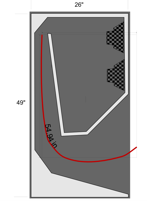

The first cabinet I'm trying to model, is a rear loaded horn with quad 12s on the face. It is a cabinet that I built back in the late seventies, and its output was very impressive. I wanted model it in software to see what could be tweaked to make it even better. These units had good usable pant-leg flapping bass, all the way down below 17hz. We crossed them over at 85.
However, when I try to model them in Hornresp myself, the response curve falls like a rock below 100hz... So undoubtedly I'm doing something very wrong.
The cheap long excursion drivers I used had a free air resonance of 21hz, 8 ohm impedance, 120 watt music power rating, 1W/1M SPL of 89db, vas (cu.ft.) 13.3, Qts 0.38, Xmax is unknown - but as I recall they would travel a total of somewhere close to 1".
I live in Cleveland Tennessee, but I have a business in Dalton Georgia, and frequently travel to Marietta.
I have attached a very crude side view sketch of the BLH in question, and a concert photo of the 4550 cabinets.

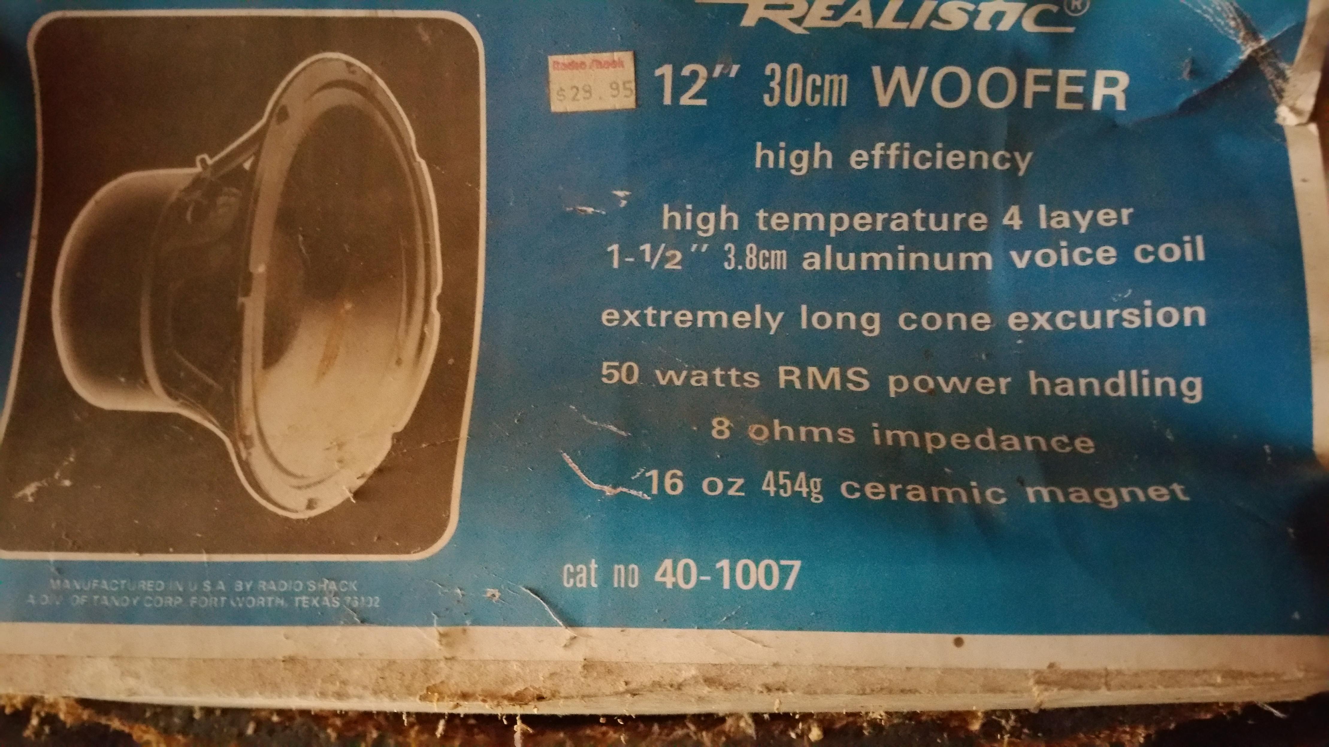

GM don't laugh please, but I used Radio Shack drivers, because at the time I was on a very tight budget, and was of the opinion that I would get smoother bass from a more inefficient driver. I had to buy eight of them in order to build two cabinets, so the cost added up quickly.
Originally these boxes were built from plans in one of the books I had acquired, and they held a single full range 15", with a rectangular vent at the bottom. So then I added a horn on top, after that a piezo tweeter, and eventually I bought the twelves & installed them in the sides of the box.
It actually sounded pretty good, and I was doing parties with those things, but it was hard to move them around without damaging the side mounted drivers. I also began to need a bigger system, so I removed the 15", horn, etc, made them into dedicated sub units, and built four more conventional full range cabinets. Then eventually as a result of my never ending quest for more db, I elected to rebuild them into the BLH configuration.
I do think you are right in saying that they are not exactly a proper BLH, but more of a bass reflex with an exponentially expanding port... I'm not sure of the proper nomenclature or where you'd have to draw the line between the two... But one thing I do know is that I got lucky on this first attempt at sub design, because they were legendary around here, and I booked a lot of gigs just based on their reputation.
Radio Shack sold two 12" drivers at the time... a regular guitar speaker, and a dedicated sub driver with a foam surround. Of course these are the latter. The specs that I listed previously are all I could find anywhere, although someone here may have more in-depth knowledge. Also, I may actually have one of the original RS boxes here somewhere, and there may possibly be specs listed on the box label, although that is doubtful.

Whoa! wait a minute... look what I found on the Audio Karma board:
It is a Realistic 40-1007 which was manufactured for them by Utah.
The parameters fo the speaker are:

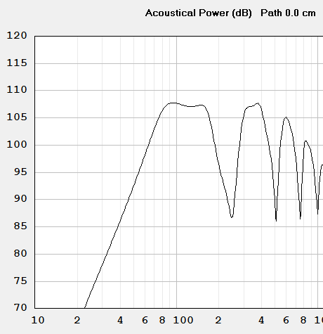

You will definitely have to hold my hand and help me through this. There is a big learning curve with this program. It is not newbie friendly at all.

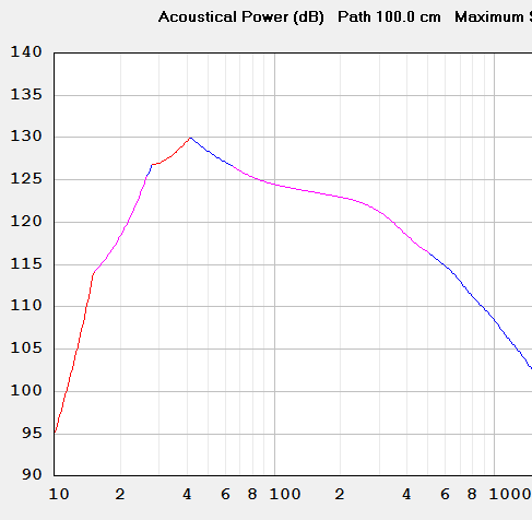

I put in as much data as it would allow me to, and ran a sim just for kicks. At least I'm showing response below 100 hz now...
Ill be tied up with work all week end, but hopefully we can get back together Monday.
PS - I heard you on the "new thread", I'll take care of that Monday also, as I'm just too tired to function at the moment.
Thanks again for your help.

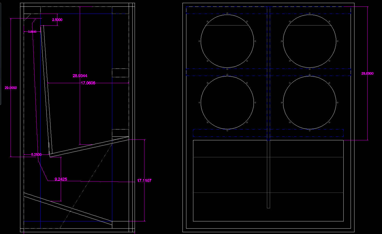

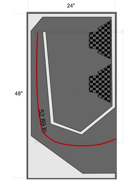

Found my old drawings, and did the thing up in Autocad for you. These are the precise dimensions.
I see that the horn is actually only two sections, and is more like a tapered port, that dumps into the side of a conical horn. Also note that although the port begins at 3-1/2 inches in width, the air must pass through a 2-1/2" "gate" first.
None of this was done by accident, but it's been so long, I can't remember what sort of scheme I had in mind at the time... It did work well however. These would outperform my B-36 Cerwin Vegas. Sounded a lot better, also.

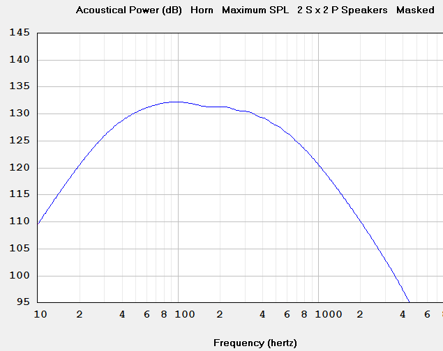

Okay thanks, meanwhile I'm trying to make this as easy on you as possible. And I'm obviously not doing this right, as the output is dismal.
I've noticed that changing the distance of the horn mouth from the speaker just a small amount, has a huge effect on the output graph. And like a lot of the other perimeters, I don't know how to enter the correct data... I don't know if it wants edge to edge, center of horn to center of the lowest driver, center to center between the horn mouth and centered between the upper and lower drivers, or something else altogether.

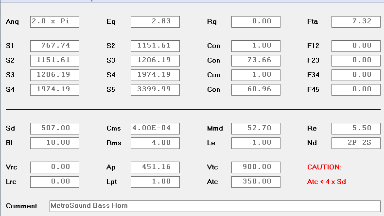

Anyway, here is what I currently have:

Yes, there will be 'ripple'; driver input is waaaay off: double click on the Sd field to pop up T/S input window to see how far off, then change any that are different:
506.7
5.5
20
438.9111
0.79
4.23
Qts will auto update once you click OK at the bottom
1.00
100
6.67
Click OK to close/update and notice how the main driver specs inputs have changed, then go back and reopen the T/S window and you'll note that some have changed, with the difference between your inputs and these showing that some T/S spec don't jive, but not off far enough to be of concern.
Of course this doesn't mean your driver's actual measured specs back then would have been 'close enough' to published to get a decent sim, just that whatever sim you get from published is accurate enough.
In short, the only way you can really count on a sim is to use measured specs and if multiple drivers are > ~10% off from each other, best to sim using averaged specs.

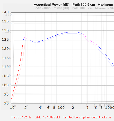

Oh man... I think I liked it better before!
I may not have my vent configured correctly either though. I just disregarded the choke at the entry, and averaged the remaining area inside the port. I could not find a way to enter values for a tapered port in Hornresp.
I also disregarded the lower section of the port/horn, as it is so much larger that I doubt if it would couple anyway. In fact, I don't think I ever meant for it to. For this simulation, I simply added it's distance to the measurement I entered between the mouth of the port and the center between the upper and lower drivers...
Thanks for all your help. I'm working on this as hard as I can... my main problem is that I'm not familiar with the all idiosyncrasies of this program. And having to convert everything to metric values first, just makes it doubly tiring. Thanks for saving me that misery this time via your list of pre-converted values.
BTW, that is a very capable little converter program you linked for me, and I appreciate the tip... but in case you weren't already aware, Windows calculator has a built in converter that can handle all of this.
