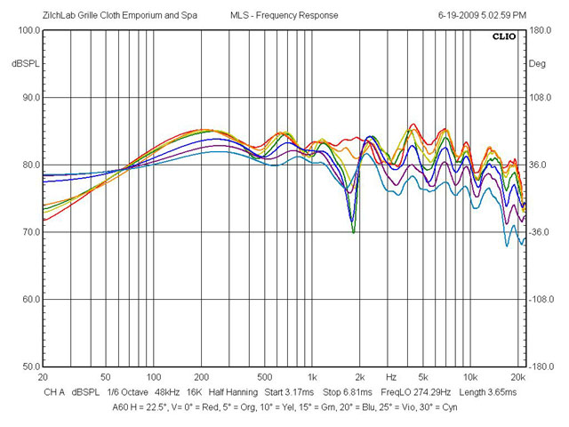

15 measurements on a vertical straight line 1m in front of the Nathan on 22.5°, each 5cm apart. Window time is 3ms, nearest boundary was >1m away:

Center tweeter:
Center tweeter/woofer:
Center woofer:
Best, Markus
What do you mean by "Center tweeter/woofer"?
Looks a little like the phase between the woofer and tweeter might be off a little bit as the null should be a little further "up". The resistor in series with the large LP cap has a big effect on this phase and will shift this null up and down with almost no change in any other aspect. I'm just finishing a couple pair of Nathans that I'll test this week and see if they show the same thing and what I can do to improve it. I'll let you know.
Thanks for that data by the way. Its good to see since, as I said, it's very difficult for me to do this at 22.5 degrees.
Thats about a 25 dB scale?

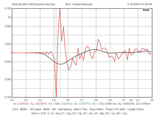

Here's the driver offset, the tweeter impulse is red, the woofer, black. If this is a legit way of getting it, the time differential says the tweeter acoustic center is 0.66" ahead of the woofer's at 22.5°, tilting the plane of equidistance down, which makes about zero sense, as the two drivers are connected in phase:
Yes, 1dB increments.
I just slided the mic stand up and down. That's not "by the book" but error in measurement should be minimal.
Here's a picture that shows "Center tweeter/woofer", "Center tweeter" and "Center woofer":
