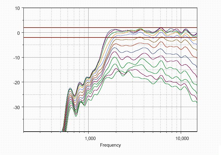

To illustrate what Zilch says, here are some curves run by member 4313B on the audioheritage forum:
( http://audioheritage.org/vbulletin/showthread.php?t=19857 )
The curves are taken on axis, with no eq.
First, the 435Be (the compression driver used in the K2 S9800) and the 476Be (the one used in the Everest 2) on the horn of the K2 S9800 :
attachment.php
We can clearly see a lot of ripples in the response, but the 476Be looks smoother.
Now the same two drivers on the PT-F95HF, the 1.5" version of the econowave:
attachment.php

"The JBL horn has a substantial amount of internal reflection and diffraction as is evident throughout its frequency response curves."
The nasty +/- 0.5 dB ones here:

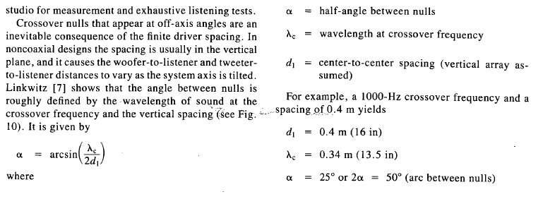

With all the discussion about the vertical nulls I thought this might be useful to some. If you want to see where your nulls are at the crossover point all you have to do is calculate them using the driver spacing and wavelength at crossover. This is taken from an AES paper Improvements in Monitor Louspeakers by DAVID SMITH, D. B. KEELE, JR., AND JOHN EARGLE J.AudioEng.Soc.,Vol.31,No.6, 1983June
Rob🙂
Unfortunately that formula is only accurate for point sources not for sources with directivity. Its approximately correct, but that's all. Directivity at the crossover point changes everything and it can be very difficult to predict because everything is changing for both drivers (magnitude and phase change with both angle and frequency for both drivers). Basically its the kind of problem that only a computer can deal with.

gedlee said:
+- .5 dB Really?
OOPS, my error, +/- 1 dB, actually, in each of the curves between 0° and 45°. Do you see some basis in your measurements for suggesting otherwise?
