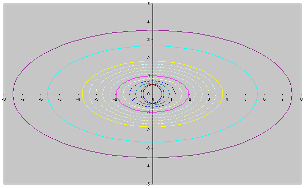

The math is pretty simple for an elliptical waveguide with an OS curve(s). I did it Excel using the 'slice' method and it follows the OS equation at all radial angles. It shouldn't be too hard to CNC a mold but I'd hate to try it with hand tools.

catapult said:The math is pretty simple for an elliptical waveguide with an OS curve(s). I did it Excel using the 'slice' method and it follows the OS equation at all radial angles. It shouldn't be too hard to CNC a mold but I'd hate to try it with hand tools.
That only works if the throat has a 0 degree entrance angle. It cannot be done when this angle is 6 dgrees all the way around.
