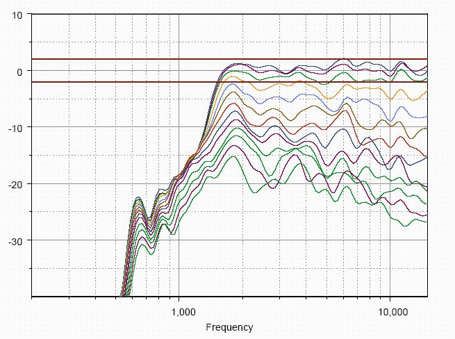

badman said:
The waveguide in the Summa is compromised by its large vertical dimension, and other issues such as the 8kHz hole mentioned by Xpert. No such thing as a perfect solution in this world. I'd love to play with the doc's waveguides but I'm more interested in coming up with a good low-diffraction waveguide in elliptical format.
The oft-mentioned 8khz hole only exists on-axis; and you're not supposed to listen on axis.
Here's the data; note the hole disappears off axis:
I'm listening to a Gedlee waveguide right now. They sound lovely, and they're on the other side of the room, and I'm well off axis.
Here's the response of that crummy PT Waveguide; note the off axis response is atrocious. In the vertical axis it's abysmal. Can you say "compromised?"
Honestly, this whole argument seems a bit silly to me. We're comparing a ten dollar waveguide that's full of design compromises to a no-compromise solution. It reminds me of those letters in car magazines where someone is trying to convince the editor that their ten year old Mustang LX is just as good as a Porsche 911 Turbo. It's a nice car for the money, but there's a reason why a 911 costs $60,000...

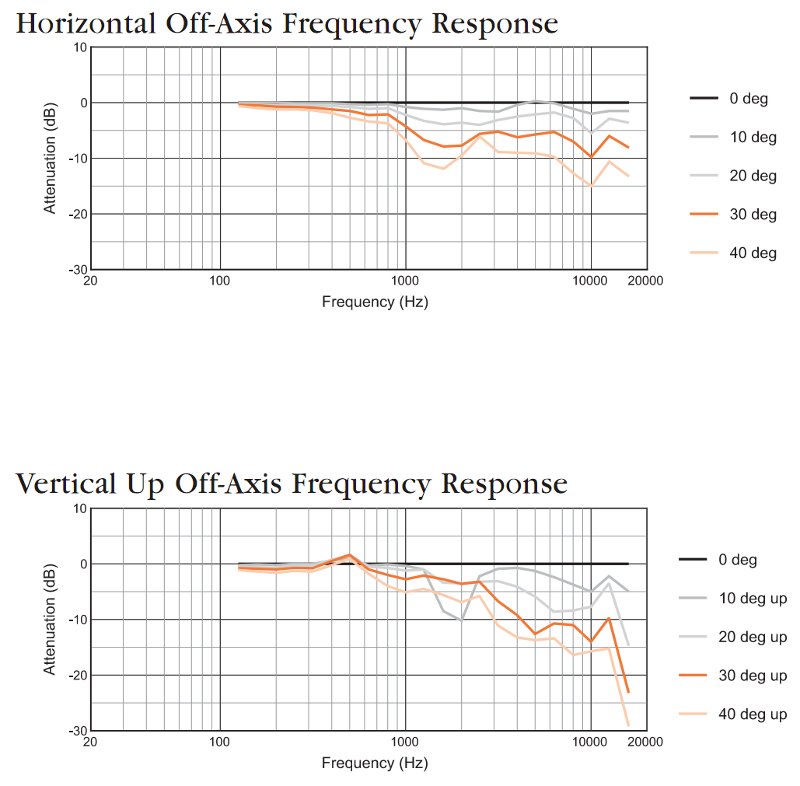

The JBL 2352 performs typically. The pattern narrows between 500Hz and 3kHz and widens above. There are some irregularities at 8 to 10kHz.
http://www.jblpro.com/pages/pub/components/23525354.pdf
Same with EV HP940 (the 940 features that fins within the throat to cure early reflections, though).
http://pdf.textfiles.com/manuals/STARINMANUALS/Bosch - EV/HP940.pdf
Not at last, Geddes' OS waveguide does equally, if smoothing is taken into account. If it comes to "HOM" the JBL and EV realize a +/- 1dB over the whole spectrum if equalized for the CD rolloff. That should be THE annoyance of conventional vs. Geddes' horns!? That +/- 1dB is by far better than with conventional direct radiating speakers in typical boxes! For my uderstanding both Geddes' and conventional waveguides are in the first place compromized by the transition to the baffle. At least Geddes'. The major vendors as JBL and EV, nowadays 18s too,
http://www.eighteensound.it/index.aspx?mainMenu=view_product&pid=178
have the advantage of a lot more money and manpower to spend on trials, simulations etc. Look at the outdated RCF H100, nearly perfect:
http://www.rcf.it/c/document_library/get_file?p_l_id=20071&folderId=22488&name=DLFE-2191.pdf
(where's the HOM?!)

noah katz said:[BI believe the acoustical XO, and the woofers electrical XO freq, is much lower.[/B]
Hi Noah. Problem is the directivity of the JBL has gone to hell by 2khz. Which means you should cross considerably higher.
noah katz said:[B90 deg horizontal w/lots of toe-in is good, but this can't be done in the vertical so a narrower pattern to limit them is better IMO. [/B]
Yes narrower, but still smooth response no? Directivity will never be zero degrees, so we must still have smooth response off axis.
BTW pushing drivers apart increases vertical directivity, not pushing them together. What now? I don't think the issue is as clear as supposed.
