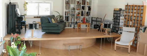

Horn sub built into a stage

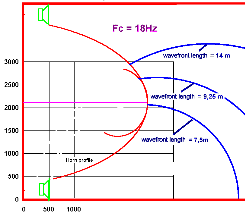

I think the single Bertha was good to roughly 30hz. It’s not the cubic feet, its the mouth area that counts. The standard 8 foot mouth Bertha 3.5 x 8 = 28 sq feet. The double stacked 10 mouth version is 3.5 x 10 x 2 = 70 sq feet mouth. Horn calculator for a hyperbolic expansion horn will tell you the cutoff. The RLA 3000 controller / crossover bandpass limited the low end to 30hz at 12 db/octave. You don’t want to overdrive the horns below the cutoff, it eats drivers. you will not miss the last 10hz. You could get lower with big reflex boxes and the correct drivers, but you won’t get the dynamics of the bass horn.
Did Richard tell me he’d done or was hoping to build a pair of straight concrete bass horns on Long island or am I dreaming? (It was almost 40 years ago). If you can do a straight horn with as big a mouth as possible would be pretty dam good. Hyperbolic is the fastest expansion rate to a given cutoff, but has higher distortion in the top end of its bandpass. The Bertha high pass cutoff was 100hz /18db octave. If you have room for an exponential expansion the HF distortion is lower.
in your case figure out what the biggest mouth you can do at the front of the stage.
then figure out how much depth you would need for exponential and hyperbolic expansions to build the horns. either mouth area or depth will be your limiting factor. Don’t forget the space for the rear chamber and service access. Don’t get too obsessed about 20hz ( I have 2 JL Audio F212v2 at home - they go low) the dynamics of really large mouth bass horns is still impressive. Multiple reflex boxes with lots of power for stadiums is good too, but not as effortless as big horns to me.

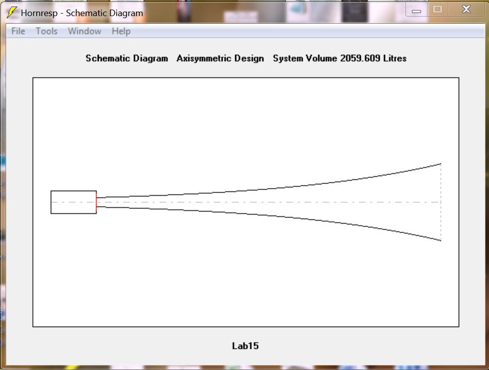

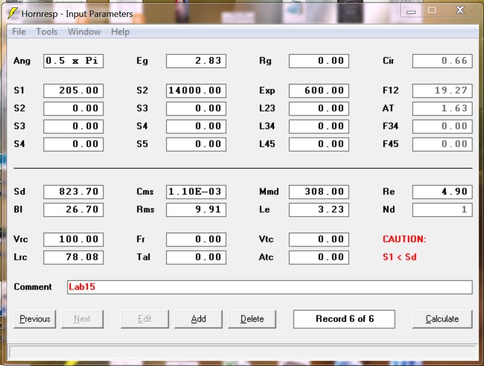

I haven't used Hornresp for years, but have started to re-familiarize myself with it. I think I get some of it, but I haven't worked out how to vary the front and back chambers, or how to use a compression chamber with more than one driver feeding it. Because I don't have the T/S parameters for my 18 inch drivers, for anyone who feels like giving this a go, please feel free to use the driver or drivers of your choice.

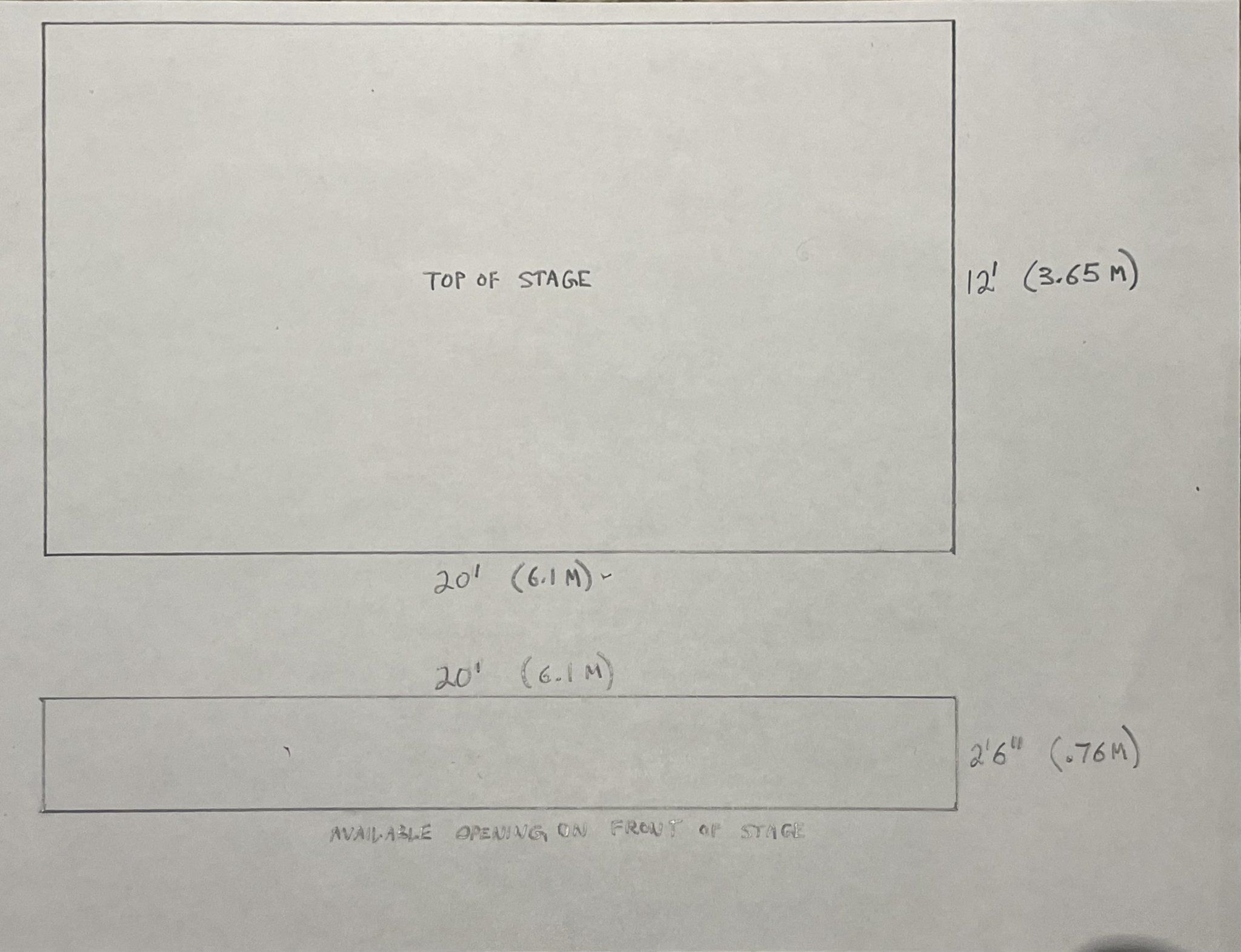

The available volume is 20' X 12' X 2.5' which is 600 cubic feet. The available horn mouth opening is 20' X 2.5', for a total area of 50 square feet (4.645 square metres). This volume and mouth area would ideally be split into two in order to make two horns, but if one horn is better, that is fine as well. If it is one horn, I would like the opening to be centered on the stage face. I am not opposed to the horns (or horn) having bends. -3DB points of 20 and 60 Hertz would be ideal. Please see my attached drawing, and the reposted drawing and photos originally posted by AllenB, for more detail. SQ rather than SPL is the priority, so there is no need for nightclub level output.
The bottom rectangle is the available mouth area. The available horn length for a straight horn is 12' (3.65M), but I am not adverse to a bend/fold if it will help hit my target frequency range cleanly.
This would appear to substantially increase the overall length of the horn by using the walls and the mouth of the other horn to do so.
Both of the two photos above show horns that seem to be intended to cover a much larger range than my desired 20-60 Hertz, which would make the curved portion more of a requirement.

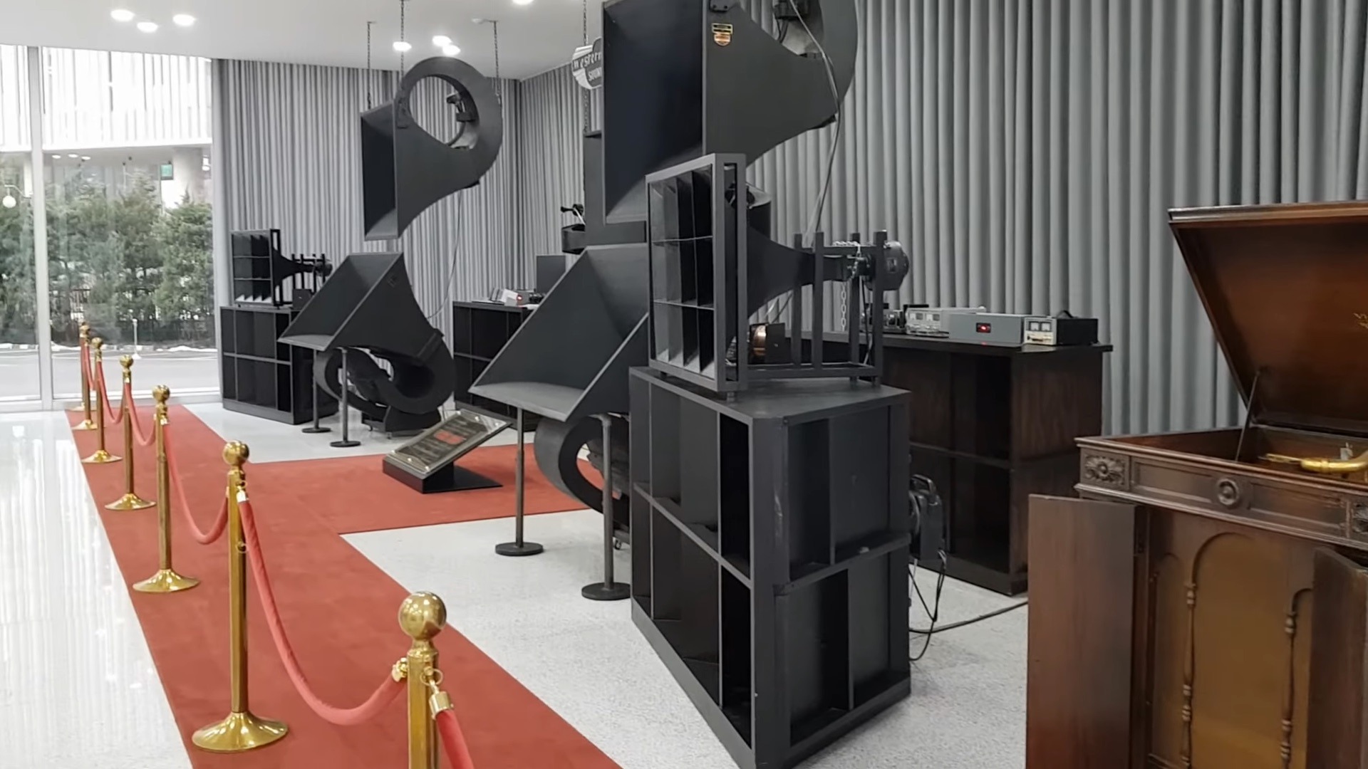

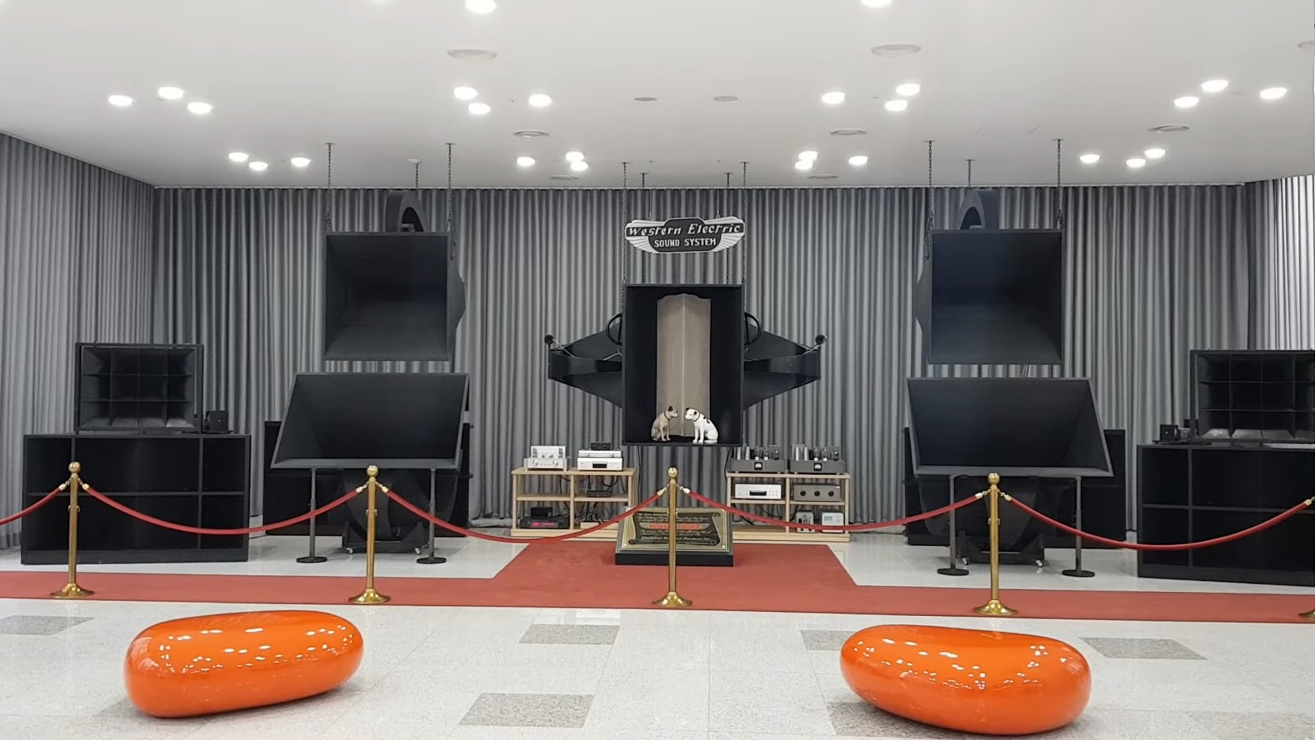

the Japanese pictures - the big multi cell crosses over at least 300 hz , likely higher
and the split section mid horn 600 hz or more ( that horn isn’t a good one).
I’d really like to see a low/ mid horn with both systems down to to the 100z area Or lower.
maybe they blend OK back a distance.
some early Western Electric horns. The WE 555
in the middle 3 horns went low for dome driver

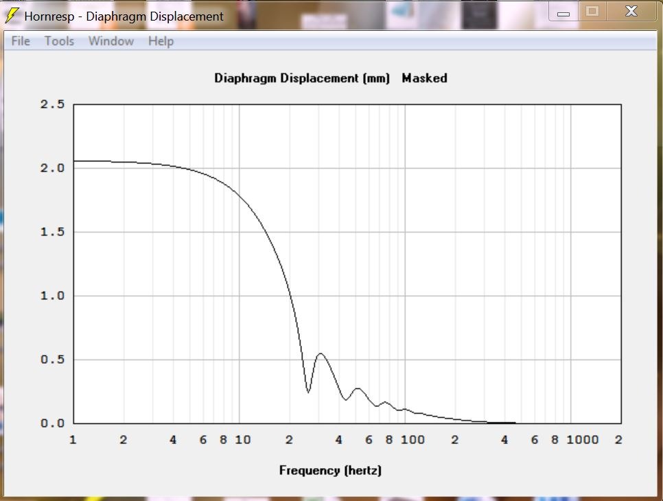

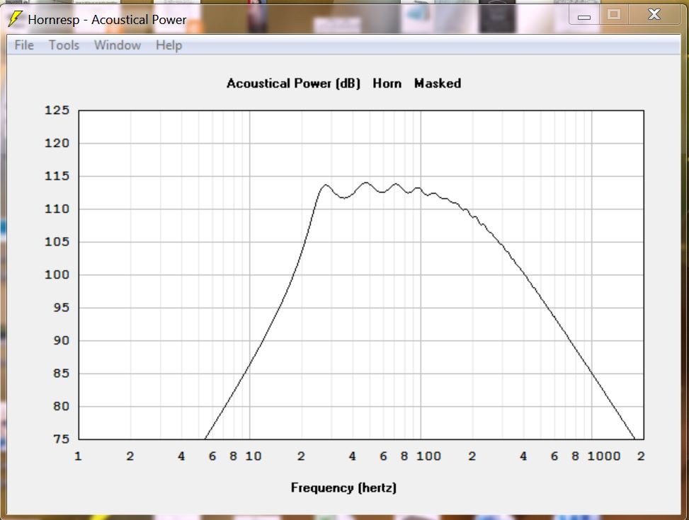

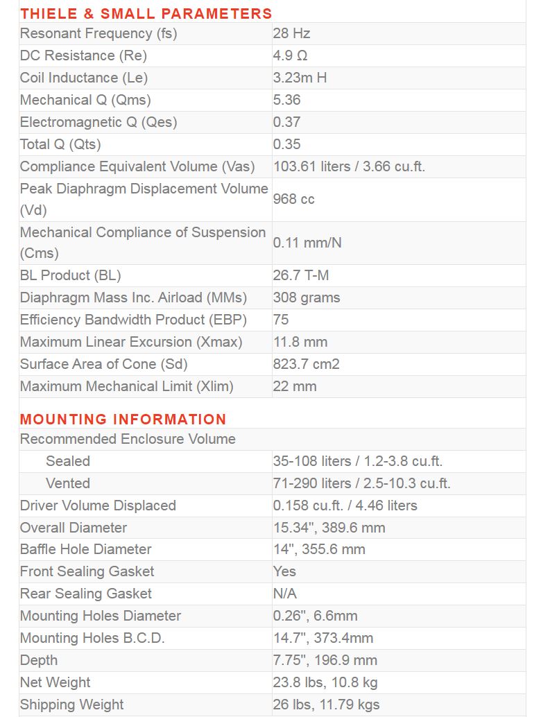

IamJF: Sorry about the delayed reply. I figured it was time to get to know Hornresp better after a long absence. I'll post my sims using Eminence Lab15s shortly. I will probably end up with two horns that are good to 25-30Hz. The lack of flexibility that is the case with built in horns is definitely a concern, and I will try to figure out the best place to terminate the horns in the room. Ideally, the horns would be part of the stage so as to kill two birds with one stone, but there is some placement flexibility as they could also be built into raised booth seating, as well as run down a wall and then out. Bands will be a small part of business, and the main system (or a secondary system) will be able to take care of that requirement without the horn sub. It will be mostly DJs, but it will not be a nightclub. A listening bar/lounge is more the goal. Sound quality is the priority and not SPL. The main system will likely be a pair of Klipsch Jubilee. Ideally it will be like a big listening room in an audiophiles home.
