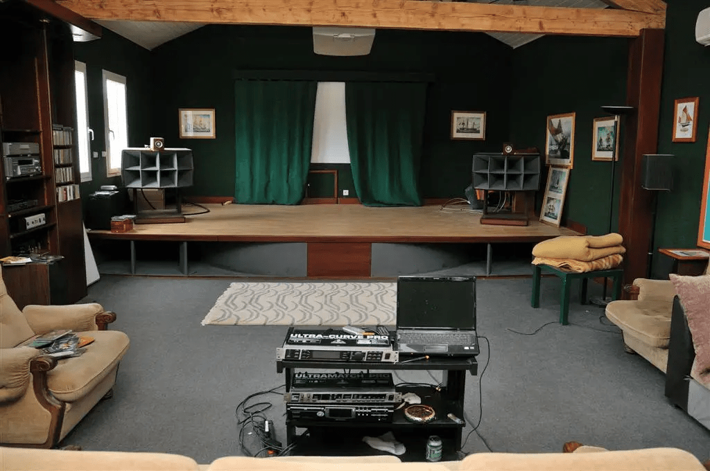

I appreciate your input. I don't expect that live bands will be a big part of business, but if they are I'll add a dedicated system for them to use. With respect to my bass horn proposal, I have been thinking the same. Looking at the Diaphragm Displacement page of my sim, there is a 1 mm displacement at 20 Hz. If this is at the corresponding Eg of 2.83 RMS Volts on the Input Parameters page, and at the corresponding output of about 112 DB on the Acoustical Output page, I don't see the need for two horns. If I use a Lab 15 and put 400 watts into it, what will happen? I also don't see the need for the sort of purpose built subwoofer drivers normally used in bass reflex or sealed box subs. Why wouldn't a K-33 or similar be adequate? That said, this is not at all an area of expertise for me, so I may be missing something important.Its hard to articulate this point effectively but in live sound high output capability is a key requirement for fidelity, there is far less control of the level of playback in comparison to recorded music. This is because of the acoustic sound of the band that you can't turn down and the much greater dynamics. I tend towards extreme over provisioning of the FOH system, on many occasions this has got me out of difficult situations where the gig has turned out to be different to what was anticipated. This kind of thinking would make be cautious about not building much more output capability into a major project such as this than you think you need. After all if the woofers are moving a small faction of xmax they are likely to be more linear anyway....

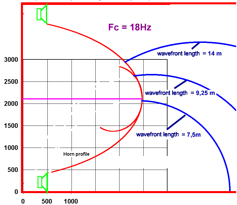

your hornresp has a warning as you have no throat chamber, you will always have one even if its just the minimum to avoid the cone hitting the throat.

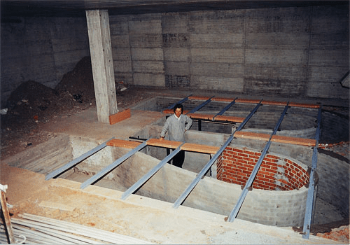

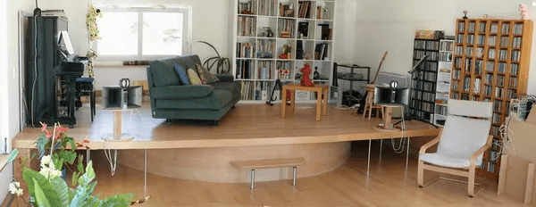

That bad boy is HUGE! Where's the sawdust????After playing around with Hornresp for a bit, I have come up with a sim using the Eminence Lab15. I have attached a bunch of screenshots for your consideration.....

Not yet. It will almost certainly require at least one bend in the horn.have you attempted to convert your Hornresp schematic into a working build plan?
My plan is to have a much larger than required volume where the driver and back chamber is located. This will allow service and modification of everything up to the throat.your hornresp has a warning as you have no throat chamber, you will always have one even if its just the minimum to avoid the cone hitting the throat.

This was supposed to happen before Covid. It’s just starting back up again.That bad boy is HUGE! Where's the sawdust????
Output at 20Hz is about 104dB, the driver unloads below the horn Fc (cutoff frequency), hence the rapidly increasing excursion below the impedance and excursion minima.Looking at the Diaphragm Displacement page of my sim, there is a 1 mm displacement at 20 Hz. If this is at the corresponding Eg of 2.83 RMS Volts on the Input Parameters page, and at the corresponding output of about 112 DB on the Acoustical Output page, I don't see the need for two horns.If I use a Lab 15 and put 400 watts into it, what will happen?
.05 x Pi is eight space, or corner loading- your horn exit is loading to half space, 2 x Pi, so the sensitivity is overstated by 6dB. An increase of 6dB requires double the excursion and four times the power.
Put a larger voltage into the Eg to simulate higher power- 56.57 volts at a nominal 8 ohm load for 400 watts.
For clean output, a steep (24dB per octave) HP (low cut) filter is required to control excursion below Fc at higher power.
The K-33 is designed for a higher Fc, and has less excursion and Bl than the LAB 15 (or LAB 12) drivers.I also don't see the need for the sort of purpose built subwoofer drivers normally used in bass reflex or sealed box subs. Why wouldn't a K-33 or similar be adequate? That said, this is not at all an area of expertise for me, so I may be missing something important.
The K-33 reaches its mechanical limits only 4.1mm after it's linear excursion limits.

weltersys: Thanks for your input. I have attached sims for 2 X Pi and the 80 watts from the amplifier that I will most likely use. I plan on using DSP on the horn sub, so a steep HP is no problem, and time alignment should also be easy. I will try the K-33 in a sim as well, using the higher Eg and 2 X Pi.Output at 20Hz is about 104dB, the driver unloads below the horn Fc (cutoff frequency), hence the rapidly increasing excursion below the impedance and excursion minima.
weltersys: These are the sims with filters added...

the sims looks normal, as long you do not exceed Xmax below the bandpass you are golden.
although most people use 24dB BW filters instead of 48dB LR
i guess it has to do with the group delay but idk if that affects or no the actual perceived sound
the more step the filter, more phase artifacts , but i can not tell if you can "hear" or no the diference between 8th order and 4th order filters.
also if you use some acoustic lining in the back chamber it helps to tame the wavy response
HR tends to exaggerate the peaks and dips, according to the people who measured the freq response on the actual built cabinets.
