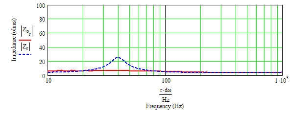

if a horn loaded driver is 50% efficient, then half the input power is converted to heat in the voice coil and the other half is converted to acoustic energy.
Let's suppose we have used an 8ohm driver with an Re=6r0 in this near perfect horn.
What is the effective load impedance seen by the amplifier when operating in the passband of the horn loaded driver?
Could it be 8ohm or 12ohm or 16ohm?
or some other value?

As already stated the minimum impedance is going to double to 12ohms. Since you are talking about a 50% efficient system, by definition half the power is going into the voice coil as heat, the other half goes into the air as acoustic power. This means there can't be any other losses in the system. Some of the resonances in the system will therefore have infinite Qs, since there is no damping on them. The impedance curve will have peaks into the hundreds of ohms range.

As far as I can see, Hornresp does show exactly this 🙂. By way of illustration, calculate the results for default record number 1 and sample the SPL response at 200 hertz. The calculated system efficiency is 44.99 percent (near enough to 50% for the purpose of the exercise). Now sample the electrical impedance at 200 hertz - the calculated magnitude is 11.9551 ohms (near enough to 12 ohms). The electrical impedance is therefore twice the 6 ohm driver voice coil dc resistance under these conditions, as indicated by GM and others.
Kind regards,
David
David McBean said:
As far as I can see, Hornresp does show exactly this 🙂. By way of illustration, calculate the results for default record number 1 ................. Now sample the electrical impedance at 200 hertz - the calculated magnitude is 11.9551 ohms (near enough to 12 ohms).

So, yes a 50% efficient horn has a resistive load impedance that is about 2X Rdc.
That makes it sound simple because there is another sentence or two, which needs to follow.
I would describe the situation like this, a horn is among other things, a high pass filter so far as its impedance transformation. That corner and the shape of the corner is set by the rate of expansion, for example, a 30 Hz exponential horn doubles its area about every two feet while a 60Hz horn doubles every foot.
The or at least one of the acoustic reasons one considers the larger form of a horn is from the acoustic resistance a horn places o the driver and unlike a cloth stretched over the driver, this resistance dissipates the energy as sound radiating away into space.
To use this resistance, one needs a velocity source, in terms of a direct radiator, this would be a driver that has a response curve sloping up 6dB /oct and requires a much larger motor system than a constant acceleration direct radiator.
Anyway, picture a driver with a really strong motor, placed in a small sealed box.
This driver has an impedance curve that is very broad and tall.
The curve is a function of the radiators ability to move or mobility and is caused by the motor’s back EMF working against the driving source.
At the lower edge of the curve, make a mental note of where the curve falls back to nearly Rdc. On this low side of the Z curve, one see’s the impedance fall as the spring force (compliance) of the suspension and sealed box. Here the mobility has decreased greatly as one reaches the point mentioned.
On the high side the impedance falls back toward Rdc too, this is where the moving mass limits the mobility and Velocity.
Now, in the space between the high and low points, one has an impedance much higher than Rdc. Add to this an acoustic resistance and one finds the impedance curve will fall, it is effected most where it is very high and as one increases the load, the curve between the two points reaches a plateau at say 2X rdc.
Now, pretend that resistance is a perfect horn and one is radiating half the input as sound.
A real horn is usually too small or has other compromises that cause its acoustic resistance NOT to be the same at every frequency.
Also, while the high pass corner is mostly resistive, the horn exhibits negative capacitance as one approaches the low corner. That has the effect of seeming like a mass reactance that increases (for a time) as the frequency falls.
When the compliance of the box/suspension is pitted against the mass reactance, the two cancel, leaving the acoustic resistance to be driven to a lower frequency (reactance annulling).
