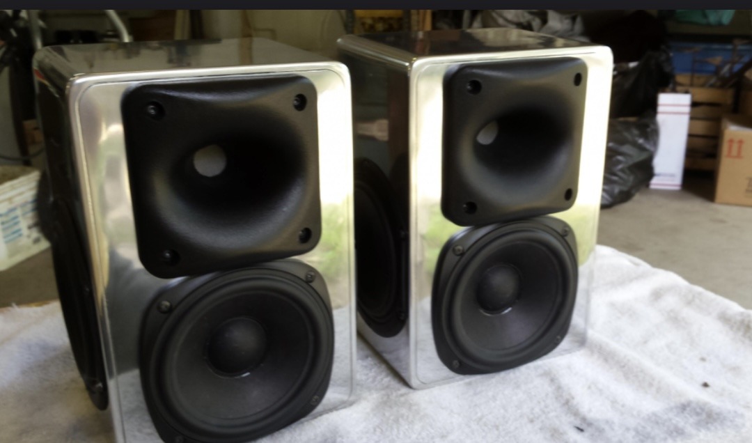

Those look fantastic. I may have to get a CNC. Won’t happen this year, I just bought a jointer (planer) and a plainer (thicknesser). Maybe I’ll work on the Sabourin flat ones made with compound angles? I’ve been looking for something like that for some 6” midranges I have. Thanks Fuling.Look here for inspiration:

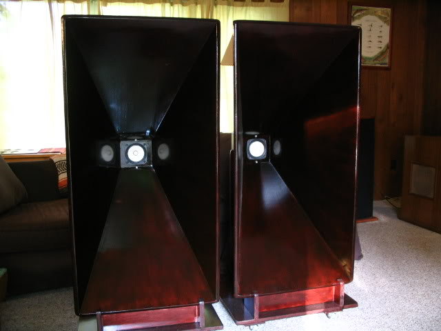

Would a 3" version of the Tang Band with the bullet phase plug suit a waveguide like the ones in the pic? The driver is brilliant down to 300hz and looks like the 4" one with just a smaller basket and cone and same power rating. A pair of tall desktops like these would be awesome. Would a sub driver be happy on that angled lower horn panel with a cab behind there? Will a flare suit as the aesthetic touch desired is one with curves?

The horn is 5’ 6” tall. I bought these and never measured the response. My gut tells me that a 3” drive would be too small for that horn. With a 3” driver, I would go with a back loaded horn for a desktop.
Actually, if you are building speakers for the deck top, you might want to think about vented cabs and a subwoofer. These are the speakers I built for my deck and I run a KLH sub. It sounds fantastic.
