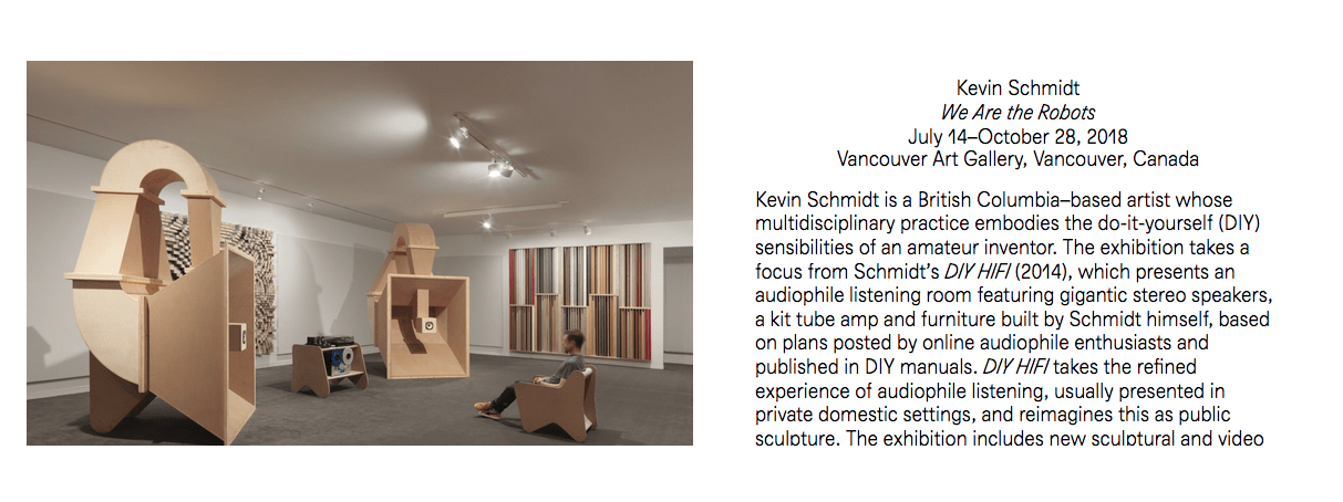

Are you talking Vancouver WA or BC?I remember a speaker like that in a museum in Vancouver.
If BC , maybe you're thinking of the art gallery downtown with the attached horn display. Perhaps based on
Nelson Pass Klein Horn. and part 2.

I sold them when we lived back in Michigan. I agree about being more of a wave guide. It was a very open and large sound but not powerful.
That’s the one! In BC, sorry. All I really remember is it was simply massive. I remember being really impressed with the the recording of birds, but I wished they were playing music instead.Are you talking Vancouver WA or BC?
