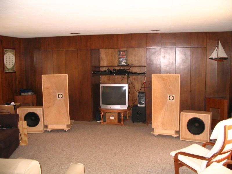

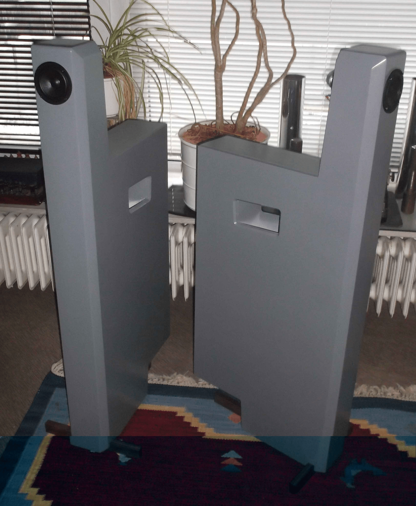

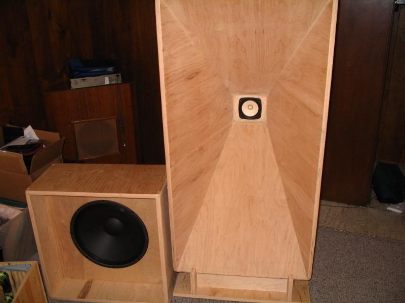

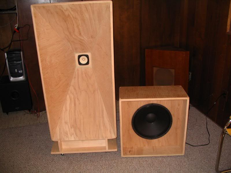

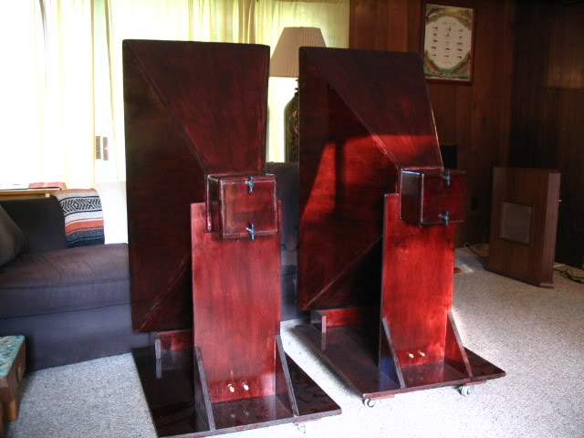

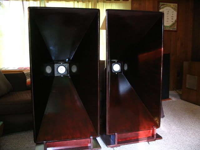

Thank you for sharing, looks interesting. I can't quite pick out the front loading part. Looks like surface mounted on the baffle. There are quite a few rear loading designs. I am trying to learn about the horn in front of the drivermake both, fl and bl look my Miniposaune View attachment 1279471

View attachment 1279730View attachment 1279731View attachment 1279732View attachment 1279733View attachment 1279734I picked these up years ago and the midrange was nonexistent as they were OBs. I made back cabs to enclose the driver’s and they came to life. Big open sound that went low because of the OB subwoofers.
