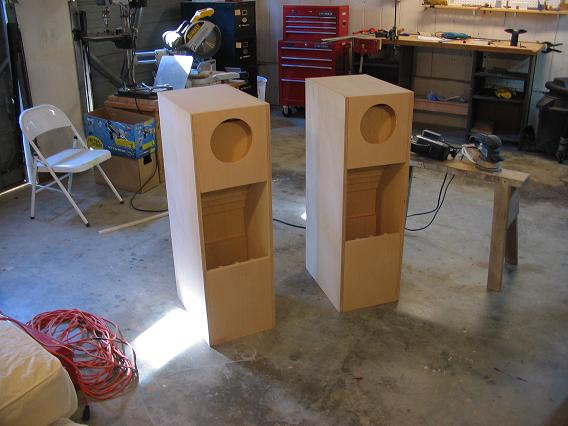

Hope I'm not diverging to much, but I decided to do the 206 in a the208 sigma horn as a holiday project, here's the progress so far. The drivers should be in the mail tonight, I'll post the results soon.

So the results...
I just got the 206's and dropped them in a few hours ago. The gear I'm using is as follows
Technics stereo receiver
Nad C542 CDP
Monster cable 14g copper speaker wire
Not the most high end equipment, but it does the job for me
So far I'm somewhat pleased with the midrange (which I'm absolutely a freak about), there was plenty of pop and was really articulate
The high end was decent, a little bright but not in a bad way
The bass was good, but I was hoping for a little more. It was not as tight and defined as I'd hoped it would be. I wasn't expected true sub sonic boom, but it seemed to me that I could hear the low low end in a kinda artificial way (like listening to headphones). I couldn't quite feel it like I thought I would.
These speakers really sung during acoustic guitar and banjo recordings. Similar results with my Jazz CDs.
Listening to more complicated stuff like rock and orchestral music they seem to get a little lost, but I guess that can be expected from a speaker covering the entire audio spectrum.
On the note of full range, I've never had a full range speaker system before and was quite impressed with their holographic portrayal of the music. Aligning them up was bit of a chore as they are like focusing laser beams.
Overall I like them. They still have a bit of breaking in to do though. Plus I have to still add the additional side panels. Once I add these will they help tighten up the bass more?
Partly: it'll tighten it up by increasing rigidity, but if you want to know why you're not getting bass, it ain't the speakers you need to look at. It's the amp.
The FE206E is a very low Q driver, i.e. the motor is very powerful, and it has an extremely light cone. That's great, but it also means that it's very easy to overdamp it with the amplifer. What you need is a low DF (Damping Factor) amp to get them singing. Valves are usually the way forward, but a T-amp, or one of Nelson Pass's Zen amps will also work well.
No money? OK, junk that 14AWG Monster wire in favour of something thinner, and preferably solid core. Like magnet wire. Get down to the local electronics suppliers, and get a spool of ceramic coated wire. Costs very little -about £3.50UK for example gets 25m of the stuff. In your case the largest I'd look at is 20AWG. An alternative is a pair of 24AWG twisted conductors extracted from a run of Cat5. The extra series resistance will help. You can get good results too in these cases from 30AWG magnet wire, but it scares some people, using this hair-fine wire as speaker cable. Not surprising, :bigeyes: but it does work.

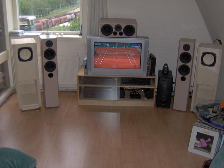

It took my 206's almost 2 months before they threw in some decent punch. I've got them hooked up to a Gainclone thru Wirewizard Spelbinder cable.
So i guess you will have to wait before you will hear the full force of the 206's, just don't expect them to go really low.
Once they're all played in (is that the way to say that?), they can even handle rock or pop music to your liking, you'll see (hear) !

In that box (BK something or other?) they won't go especially low. They will in the 208ESigma cabinet though. 🙂
