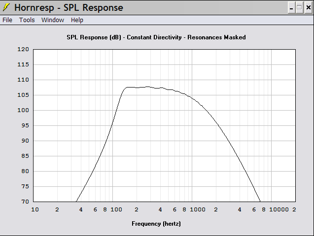

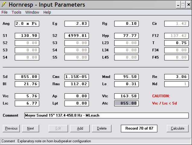

As I've said before, I'm no expert. But here's a couple of screenshots from Hornresp.
Frode
Frode

Yes, the small throats the various formulas predict will require a phase plug to work well out to 500 Hz, which in turn will require a larger throat to accomdate it, ergo a larger mouth than the flare frequency implies. For a prosound app, will it actually have true half space loading? Horns with this high a cut-off usually are in closer to full space. Anyway, this horn's HF corner is ~450.8 Hz, so the throat starts rapidly constricting above this point.
As Frode showed, you can manipulate the design to hit a target mouth area and using Prof. Leach's math yields a slightly larger throat, lower 'M' for a little less distortion at high power, but I don't see it being this smooth nor handling much power for long due to the high compression ratio (CR).
Really, if this driver has the typical stepped HF BW of a horn driver, then we can truncate it with a larger throat, making it shorter and maybe have no need for a phase plug.
BTW, for my records, which model is this and is there any plots available?

a throat giving a maximum compression ratio (Sd/Ath) of about 2 is often quoted for driver/horn combinations.
For two drivers this would indicate a minimum throat area of about 800 sq cm. But even going up to 1600sq cm would be acceptable.
However, your T/S parameters are extremely suspicious.
VAS =12litres seems very low but does seem to correspond to that high Fs value.
Would it be worth checking the free air resonance frequency manually, rather than through the computer and it's software/drivers?

Greets!
Apparently I was more tired than I thought when I posted! This should read:
.............this driver's HF corner is ~450.8 Hz..............
It didn't occur to me you might be using the tractrix calculator on JM's site since it's not normally used in prosound apps, though IIRC Klipsch uses (used?) it in its cinema series. If you use a full size mouth for 150 Hz for a given throat area, then the horn will unload at ~1.4142*150, so if you want it to load all the way to 150 Hz, then the mouth needs to have a ~0.707*150 mouth area, which of course will make it longer. Now if we cut off (truncate) this oversize mouth to keep its size reasonable, then much of the low distortion benefits of using tractrix is lost, leaving a ~hyperbolic horn with its excessive beaming due to the narrow wall angle, not what you normally want in a prosound app.
Also, even though you said two drivers I assumed you would be making two horns. If you're using two drivers on one horn with the already too high CRs so far presented, then any throat distortion, HF BW cut-off due to cancellation just got a lot worse.
Assuming you meant 200 cm^2, then this is still too small for even one driver as a general rule for point source drivers, with ~3:1 CR considered being the practical limit for prosound apps, but this driver's specs implies it might can handle higher ones if a phase plug is used to correct the HF path-length error cancellations.
