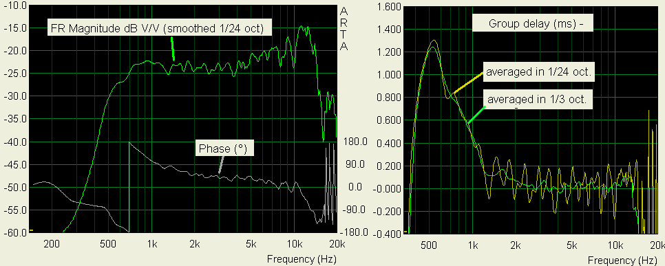

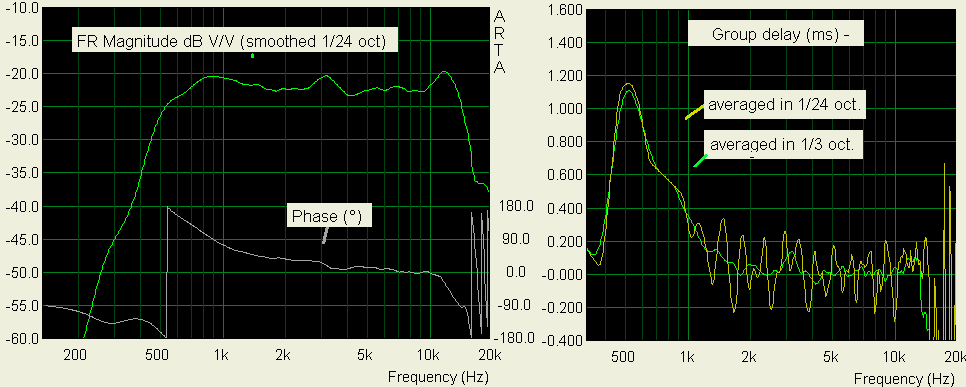

Hello J-M
Thanks very much for posting those curves .
In particular, the Group Delay curves you've attached are quite interesting .
- Most wouldn't be looking at the "before & after EQ" with quite the same perspective as myself ( since the DUT is mine ) .
- Others might miss the reduction ( flattening ) in "GD" centered around 3100 hz ( or 3200 hz ) and wouldn't be able to guess at it's signifcance ( & why ) .
- It just so happens that this is the frequency area that I've attenuated with a series LCR ( strapped across the drivers' terminals ) .
- LCR values ( not tested ) are 2.6 mH , 1 uF , 8 ohms ( if they're "book values", the notch is centered at 3121 hz ).
- I believe this is the first time I've seen an LCR notch filter effect the group delay like this ( though I'll admit I haven't looked at it with the type of resolution that you just employed / plus , I usually look to CSDs for indications that LCRs might be inhibiting ringing ) .
- This was a real eye-opener . So Thanks again !

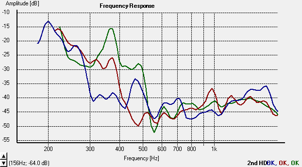

Just to pick up this thread again - I found some interesting things when measuring horns for the $$Horn Honk$$ thread. I posted them over there, too.
Basically I noticed that each horn showed a very steep rise in 2nd harmonic distortion below a certain point. The larger the horn, the lower that point.
Posted below is a graph that shows the 2nd harmonic distortion of 3 horns.
The steep rise in the second harmonic corresponds almost exactly to the wavelength of the width of each horn. Or a 1/2 wavelength of the fundamental.
3rd and 4th order harmonics also showed a rise, but not as clear cut. The distortion is easy to hear when doing a sweep.
So if we call horn "cut-off" the frequency at which the 2nd harmonic jumps up, and we stay an octave above that, then I would call the horns:

And "cutoff" is defined how? By the manufacturer?
2nd harmonic, as a percentage, is always going to go up below cutoff because the fundamental is droping, but twice it is stll in the passband.
Yes, by the manufacturer. Horns are usually sold with a lowest cut-off stated and sometimes a lowest recommended crossover.
So without measuring or listening, how are we to know how low a horn may really be used? Below what frequency will it "sound bad"? And below what frequency will directivity suffer? Altec used to supply plots like this in their datasheets.
Running the sweeps that resulted in these measurements the distortion at the low end was easy to hear. All these sweeps were done with a Butterworth 2nd order HP @ 400Hz. As the sweep climbed in frequency from down low, the sine would clean up at some point. Likely the point where the 2nd harmonic (and others) drops. I would not want much of that distorted sound in my system.
So I certainly agree that crossing 1 octave above that point, the distortion will still be in the passband for normal crossover slopes. How much it's audible you will know much better than I. But looking at the 811 plot above, the 2nd harmonic is about 6-8dB above its average bandpass level at 400Hz. With a 2nd order high pass, at least you'd be bringing it down that much. As a percentage tho, it would continue to rise.
I don't think that HOLM shows the distortion on these plots as a percentage, but as an absolute value.

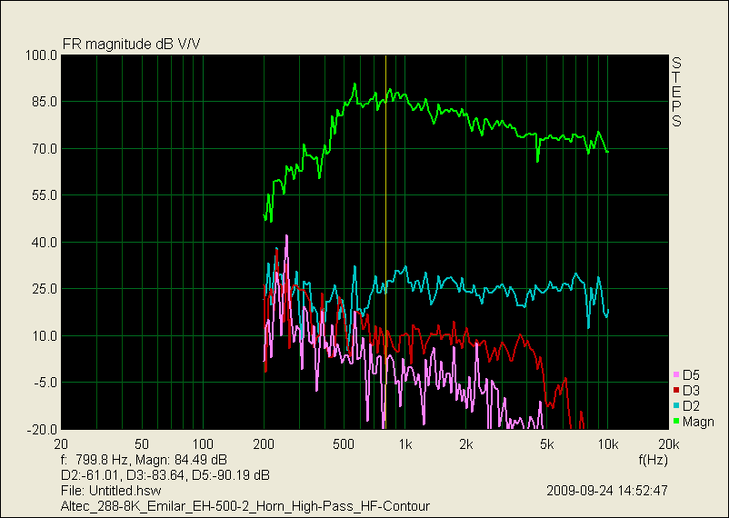

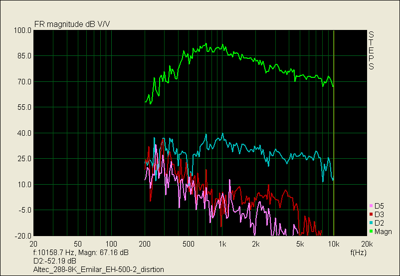

Hi Pano,
In case you missed it earlier / here's the distortion spec for my Altec 288-8K on the Emilar EH500-2 ( as captured by "STEPS" ) .
First pic is without passive EQ or High-Pass in place / the second pic is after the HP & RC contour circuit have been added .
One can see the effect of padding down the midrange ( 2nd HD & 3rd HD become closer together , fwiw ) .
The passive EQ was implemented to give this on axis response .
<> cheers 🙂

Thanks Earl. It's interesting that I don't see the abrupt distortion rise at the low end of your graphs. Wonder why?
