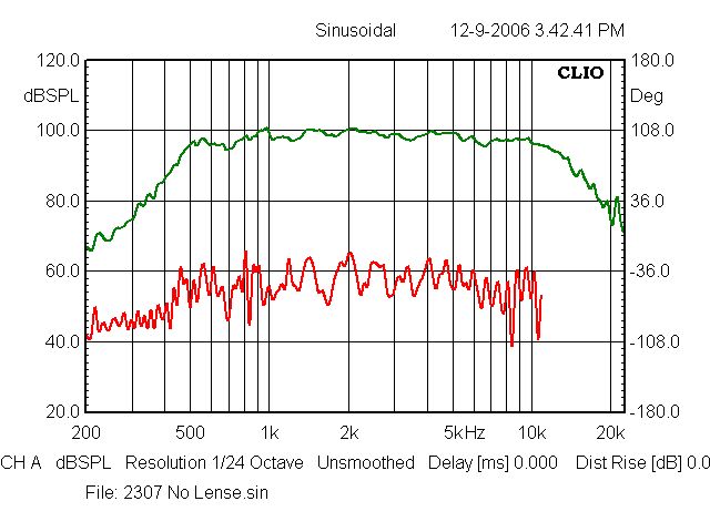

Looking for measurements that any of you may have of horns and waveguides near their low cut-off frequency.
Standard practice is to high pass the horn at least an octave above its cut-off frequency. Is this really needed at home hi-fi levels? Some say no.
So if you have phase, distortion and impulse measurements that you would like to share, please do. Let us know what the horn and driver are, if you can. Also point out what you think are the important parts of your measurements. Actual measurements are vastly preferred over simulations here. Simulations are OK if you can also show us the real measurements.

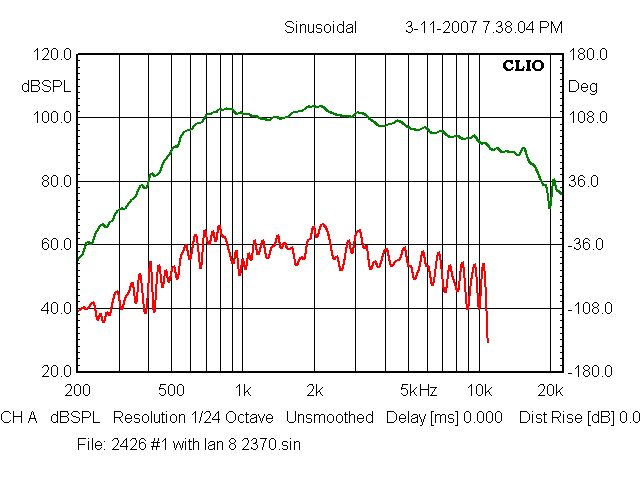

Wow! As I can see the FR extends well down to 500Hz! And they call that a 1.2kHz horn? Also, the distortion below cutoff isn't any worse. Am I missing something?
Agreed, looks odd to me as well.
Thanks guys. The JBL measurement looks great. Interesting to see that distortion does not rise under the cut off. We don't know what phase is doing, tho..
Yes and there is some confusion in thier own literature as well early on it was 800Hz short throw and 1200Hz long throw. It changes part numbers in the Pro catalog and is the H91 in the Consumer catalogs. In the Consumer sheets it's 500Hz until about the late 70's where it becomes and stays a 1200Hz horn both there and in the Pro literature until the 80's when it was retired. Clear as mud.

Yes, that's very true. I forgot to mention it. The THD graph does go down, but not as fast as the amplitude. You are correct that it's the ratio that's important.
However, on this horn at least the distortion does fall away from the level in the pass band. It may still be noticeable, tho...

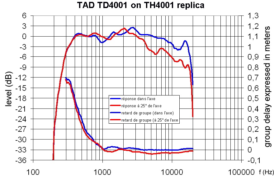

Here attached the response and group delay curves I measured on a TAD TD4001 compression driver mounted on a TH4001 horn replica. (blue = on axis, red = 25° from axis)
As I use to do for my group delay curves it is expressed in equivalent distance travelled at the speed of sound (meters). I use for myself horns at frequencies for which their equivalent group delay is less than 0.1 meter.

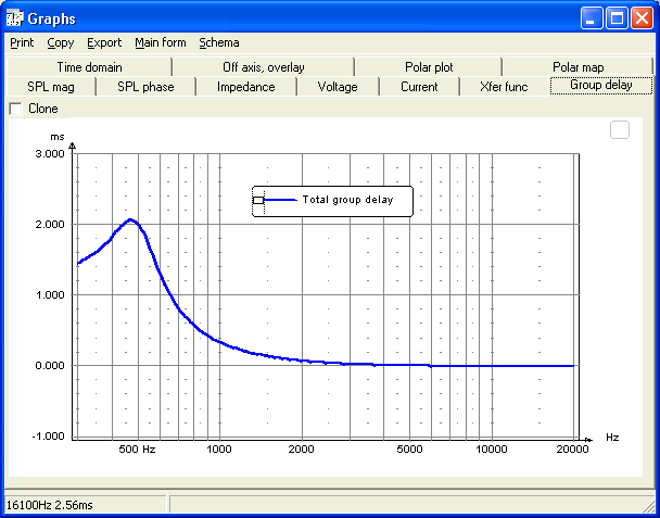

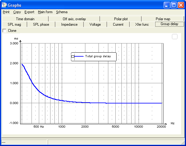

Here are a couple of group-delay pics showing just an electrical filter, no horn contribution at all. A 4th order Butterworth highpass at 300 Hz gives a group delay curve similar to the one Jmmlc posted. Raising the cutoff to 500 and increasing the slope to 6th order gives a curve similar to the one EarlK posted.
