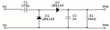

Bazukaz said:
The amp produces mainly 2nd harmonic.
Also there is a lot of noise , mainly 50 and 150 hz.I think it picks up mains hum somehow.
Also , i managed to blow one FET :cannotbe:
Lukas
Hi Lukas,
Indeed it looks mainly second... That's odd, by the way did you try measuring 'thd without noise'?
The only explanation I can come up with now for the strange thd curves is that your amp is oscillating. It would for sure explain the high figures you measure, with CCS load the fetstage will be quite linear and with an opamp in the path you have so much feedback applied that I'd expect thd to be in the thousands of a percent, if it was stable.
You write that it was easy to stabilize, but can you be sure... If I understand well, you don't have a scope available or am I wrong?
In fact, I am almost sure that your design can't be stable this way. Reason I am so sure is that I also started out using similair designs as you do now but I never got anything like it to work properly outside spice. They all proved impossble to stabilize.
You must lower openloopgain and you must add some frequency compensation (apart from c10). Skip the opamp, use an emittor follower to control the fet. It will work wonders.
Good luck and keep up the good work, much appriciation for your experiments!
Martin

Bazukaz said:
I have also experimented with this kind of circuit with BJTs as well.I have made a few experiments.Some of amps had the distortion , others not , with basically the same circuit.I haven't been able to detect the reason(once it dissapeared , by increasing supply caps ,but i wasn't able to repeat this).
I think it is safe to assume that any such unpredictable behaviour is related to instability.
When using BJT's bear in mind safe operation area limits, a 1500V rated bu 508 for instance won't be any good over 700 V. That's why I use mosfets :D
I am not really sure about stability. It showed very good results in Spice , with very big tolerance to components.For sure , real world circuits may behave quite different , but i have found that spice is a good guide to find , what makes circuit more stable and what does not.
Spice is quite reliable for normal small signal circuitry with bjt or opamps, but in my experience you can't rely on it at all with this kind of design. It seems to understand very little about mosfet behaviour under these conditions. Almost anything you try in spice will be stable but in the real world it's very different.
You must have some way to detect hf-instability, otherwise you basically have no idea at all what's going on. You can use a detection circuit placed before your DVM (see picture) to do some basic detection. Connect to your amp (through divider) with no input signal applied, any reading other than zero indicates presence of hf oscillations. But then again this still won't tell you whether your design remains stable under load and with signal, or if it shows ringing etc. To be honest, you can't do without an oscilloscope here.

By the way, do add some protection by means of a 12V zener between gate and source of all mosfets. Will prevent spikes from destroying them
Thanks for schematic.I have read 5-20mV readings after the bridge , but , even with amp disconnected from mains , i still get 5 mV , so i assume it is the accuracy limit of my multimeter.
If i leave input floating or connect it to ground , DIM reads around 0.6V.
If i connect to sound card , i get ~20mV , or less sometimes.
0.6 for sure means trouble. The other readings are strange, you are measuring DC I hope? Use a divider of 1:10, will give you much better signal to noise ratio when measuring.

So , you really think that emitter follower would really improve things ?
Also , if i consider using it , i should add a diode from emitter to base , to protect it from op amp trying to drive it with negative voltages ?
One more : should i add zener from source to gate for CCS as well ?
About drive current :
Lets say , we have 4 ohm 100W amp with 10A current limit, driving ESL through 1:100 step-up.
So , max current at secondary is limited at 100mA. 1 nF load will look as 10 uF for amp; it has 1.6 ohm impedance at 10 kHz.So , I = 20/1.6 = 12.5A. We are already exceeding current limit of amp ! But it will be able to deliver much less than this , even much less that 10A , probably 2-3A in sine wave , because amp will have to dissipate all the power it delivers.
I made an assumption that amp characteristics are similar to LM3886.
Please correct , if i am wrong somewhere.
