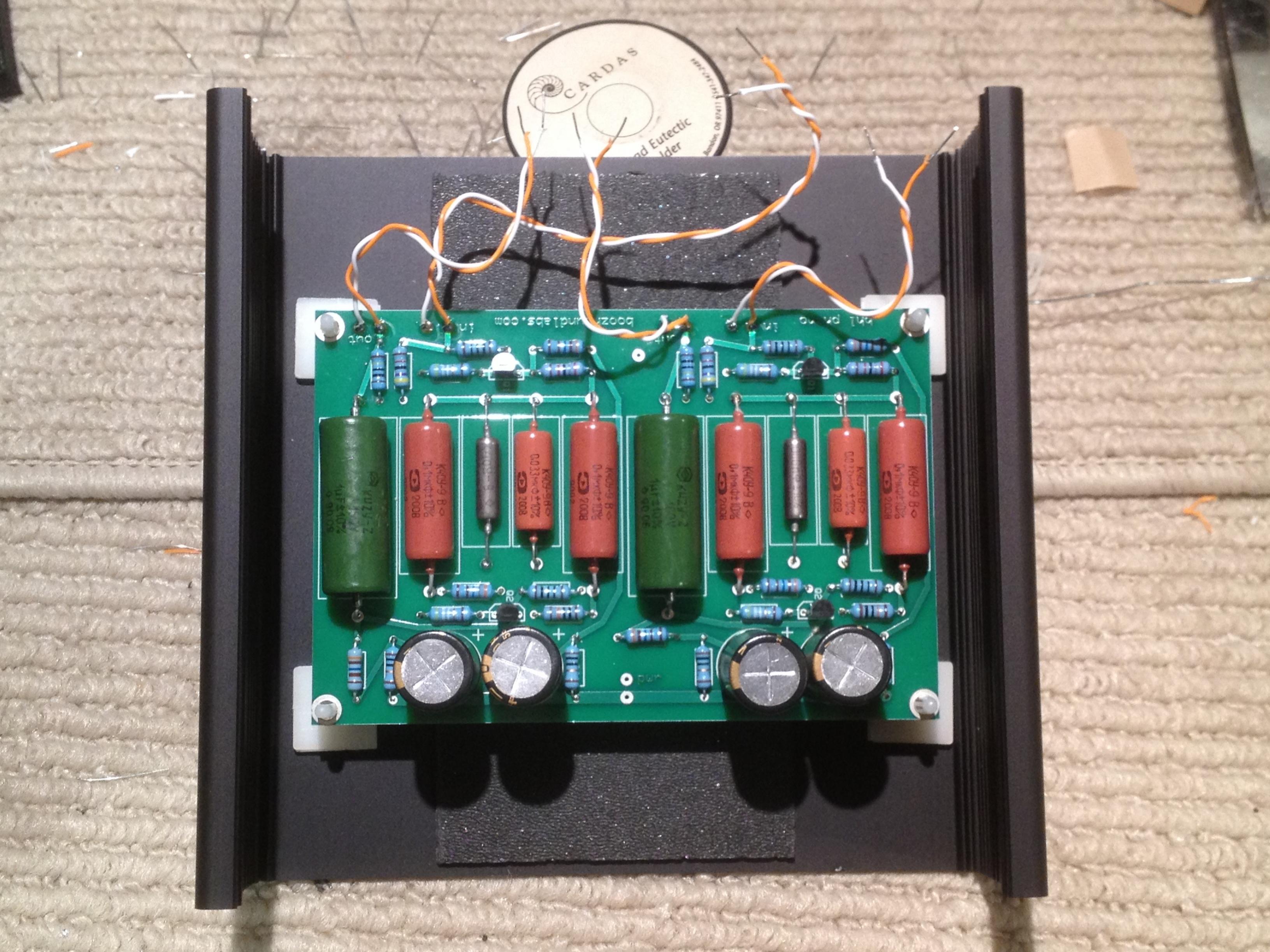

I have a Welborne Labs PS1 dual power supply module that had both -24 Vout and +24 Vout terminals and negative terminal. I need to feed a phono pre the 24VDC but the pre amps terminal is typical of a wall wart 2 pin female receptacle. The PS has a 3 pin male terminal in the chassis. I have the umbilical cord that has 3 pin female to the 2 pin male for the pre end.
How do I hook this up? I am not sure how a dual PS works and need a little help in understanding the - + V out. After a little research I am thinking that a dual supply is not what I should have here and just a + on one side PS.

Think about the dual power rails as two batteries in series, in your case 2 x 24V batteries.
The top of one battery is +24V, the join between them is 0V and the bottom of the second battery is -24V.
If you want only +24V then you use the + connection and the 0V connection.
If in doubt measure between the 0V and +ve with a meter.

Thanks KatieandDad,
Does that mean that I use the 24V plus the ground? Also, am I correct to assume I am then only using one side of the PS that being the +24V side?
Your phono pre is running +-24V or only +24V?
Not sure. It has been running on a 24v wall wart.
A picture might help. The power feed into the preamp will have at least three wires if its a 24-0-24 and just two if its a single ended supply.

Looks like I just have 2 terminals to connect. One voltage and one ground.
Please see attached. Trying to do this on my mobile so not sure the attachment is there.

So single ended it is.
It appears so
Pwr and ground. So you just need to be sure the voltage and polarity is correct.
Do I understand that I have no need for the -V side of the PS?
If this is correct then am I only using half of the PS's capabilities?
