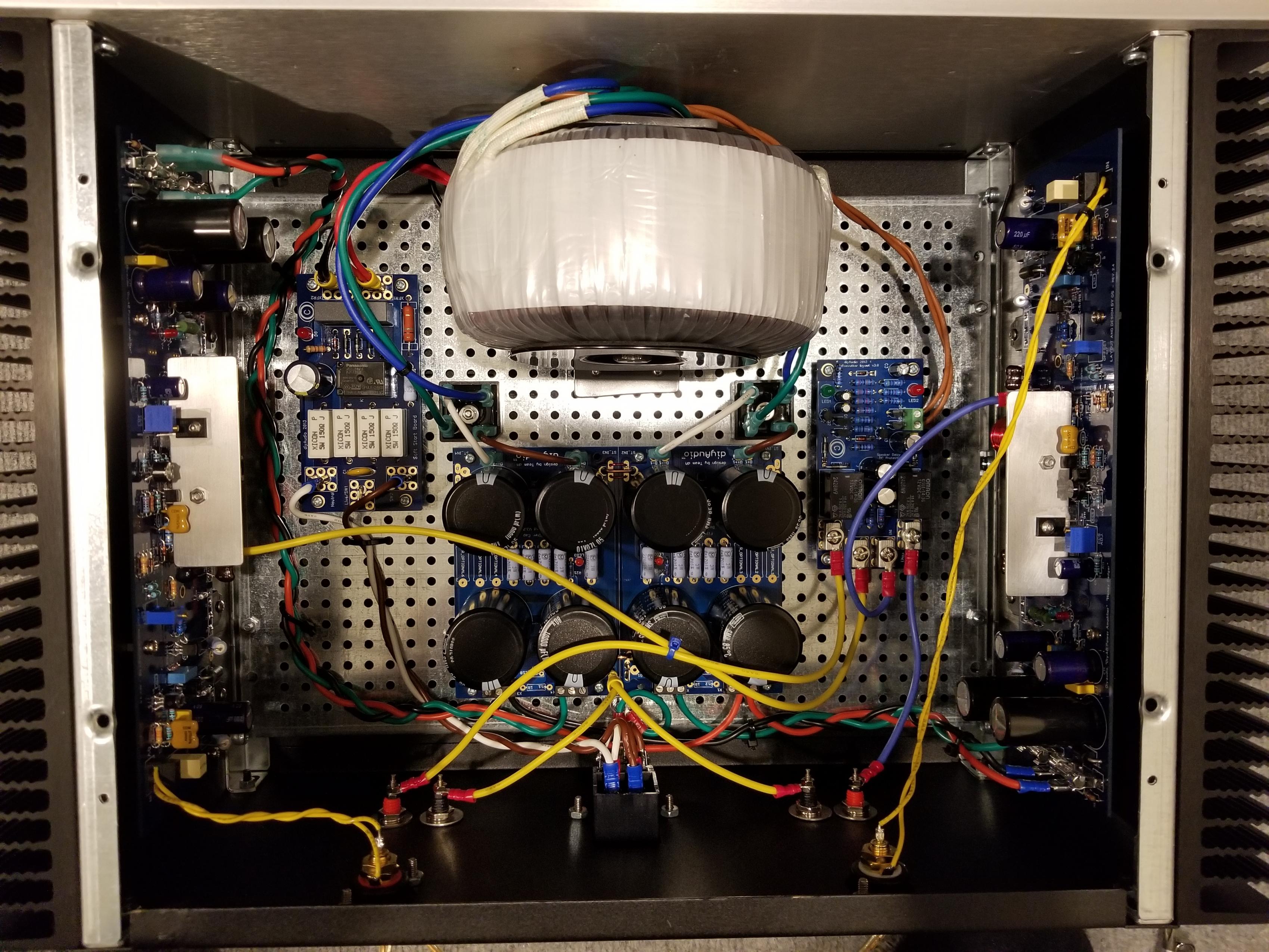

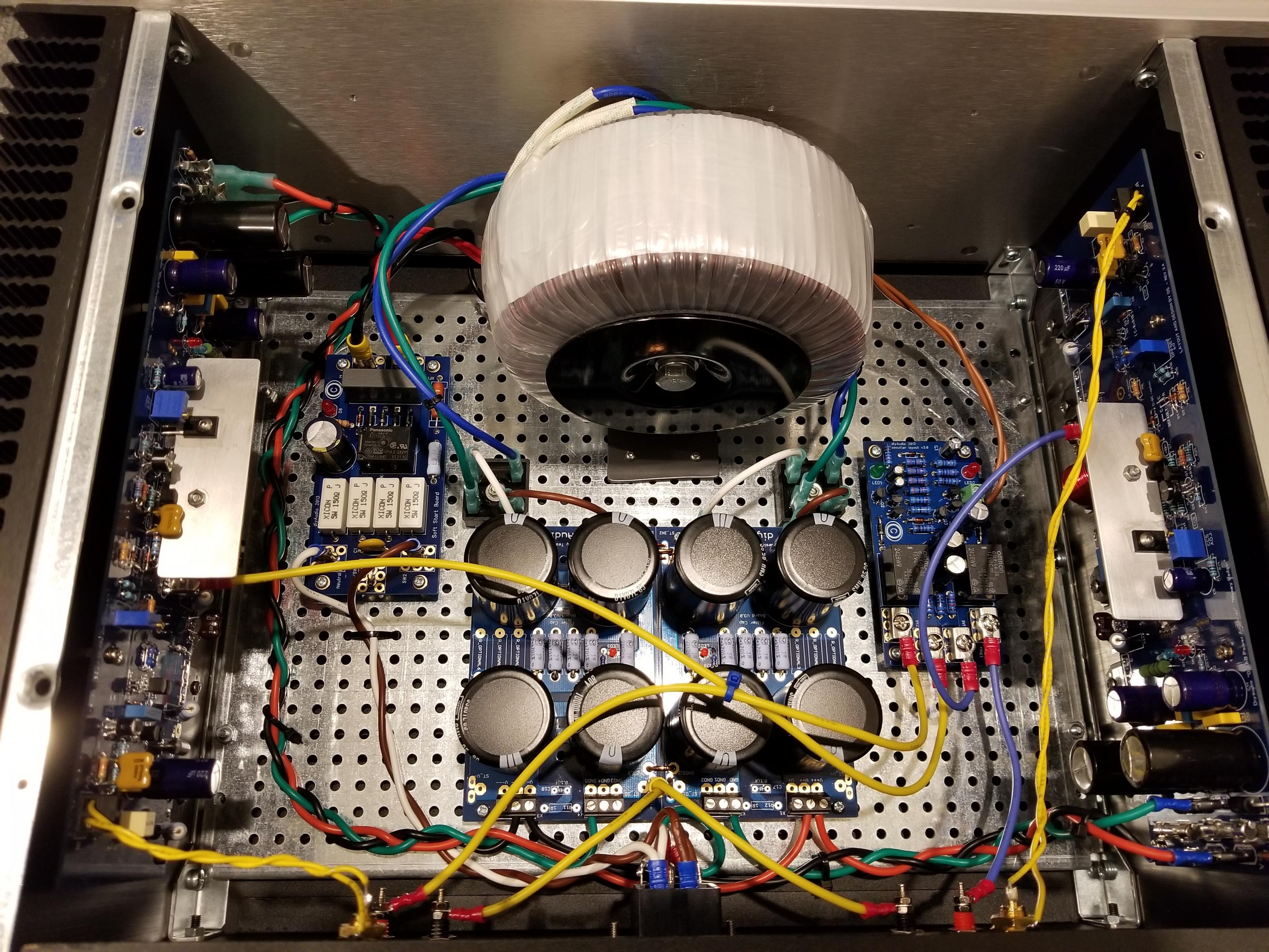

Here are a few pics of what I've got done so far. Mounting the transformer and building the softstart and speaker protection board actually took me longer than assembling the 2 HB amp modules. The non newbie friendly documentation of the simple soft start and speaker protection left me scratching my head for days as well as multiple orders of alternate parts.
Finally I am almost done, but now if I want volume control I'll have to build a preamp. I don't know if I have the patience to do that at this point, I might just buy a ready made one commercially or off ebay etc.

Thought I was done, I put in the CL-60 and it really quieted everything done at idle, but now the left channel is hissing where as the right is dead silent. I tried moving the wires around didn't seem to make much difference. However when I touch the dc offset pot with my fingers the hiss goes away. Not sure what changed aside from adding the cl-60. Taking the speaker protection ground off makes no difference.
