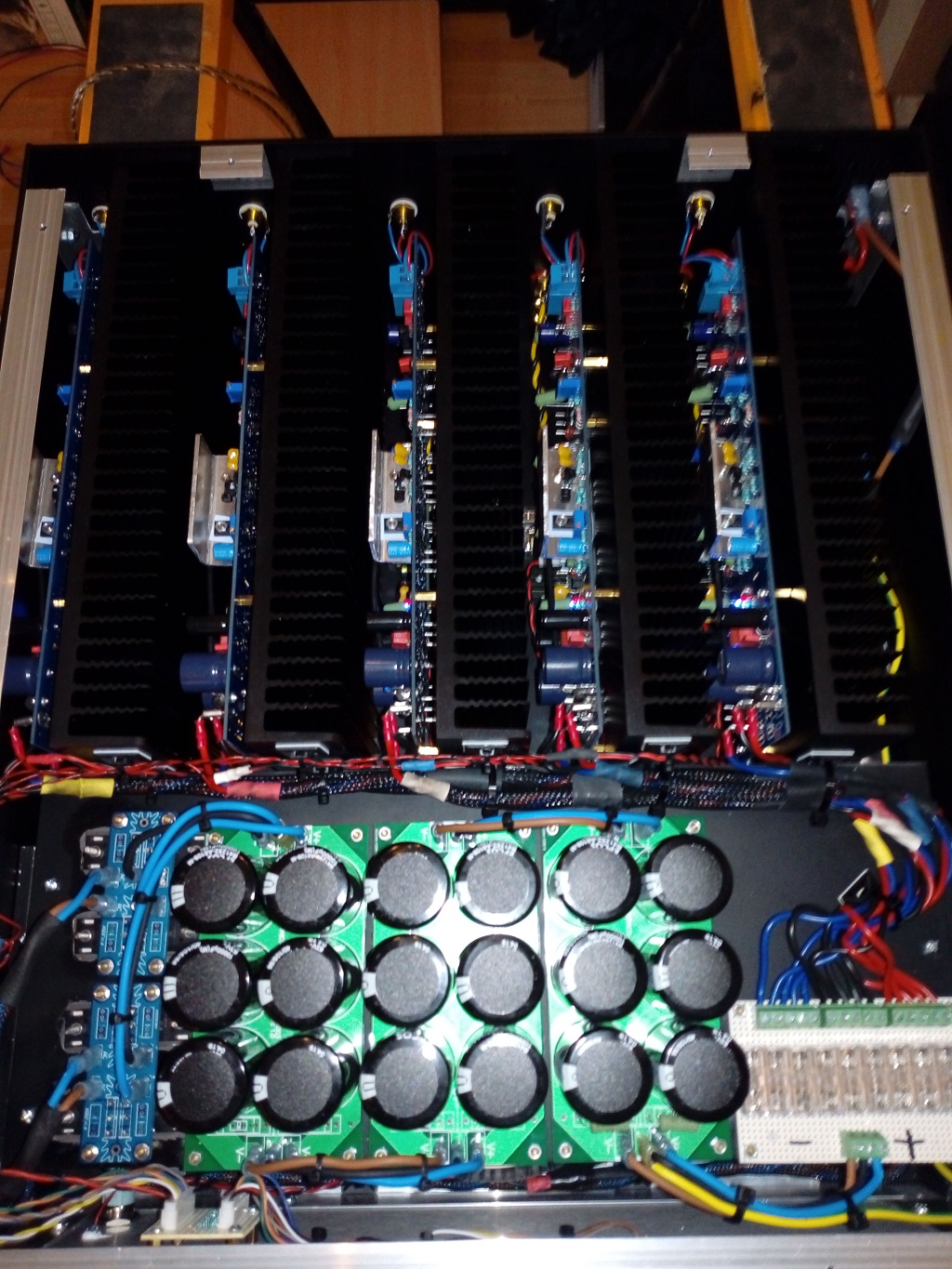

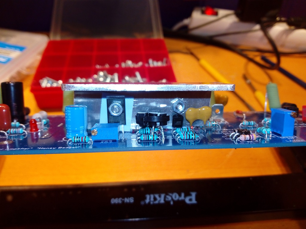

here is some pics of my build. yoy can see why i needed angled aluminium profiles for the vas stage 🙂
Very nice, I am taking my time with mine, I'm in no rush to have another amplifier. haha I am enjoying the process of doing everything slowly, so I don't run out of things to work on. Almost finished one channel of the amp so far.

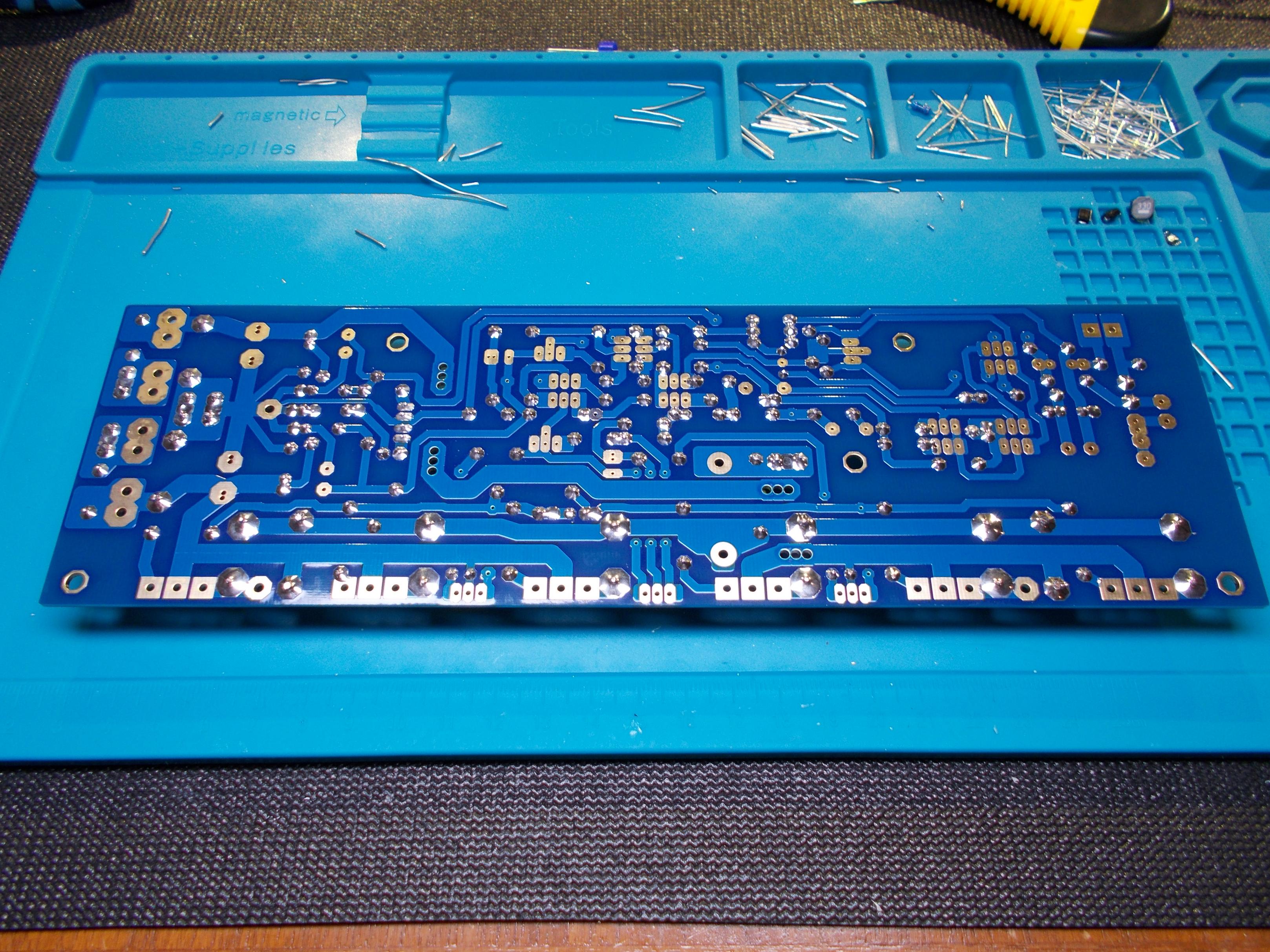

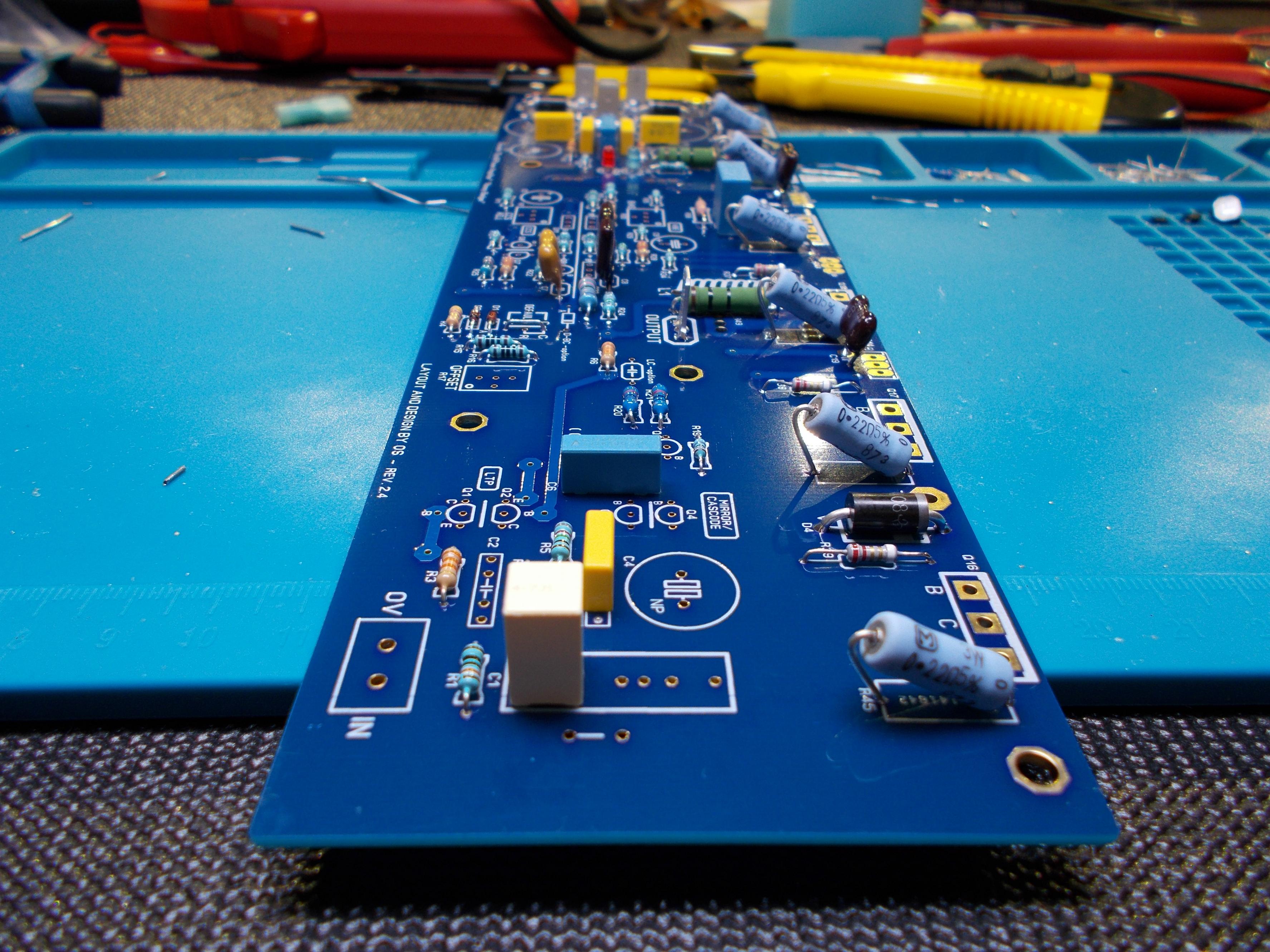

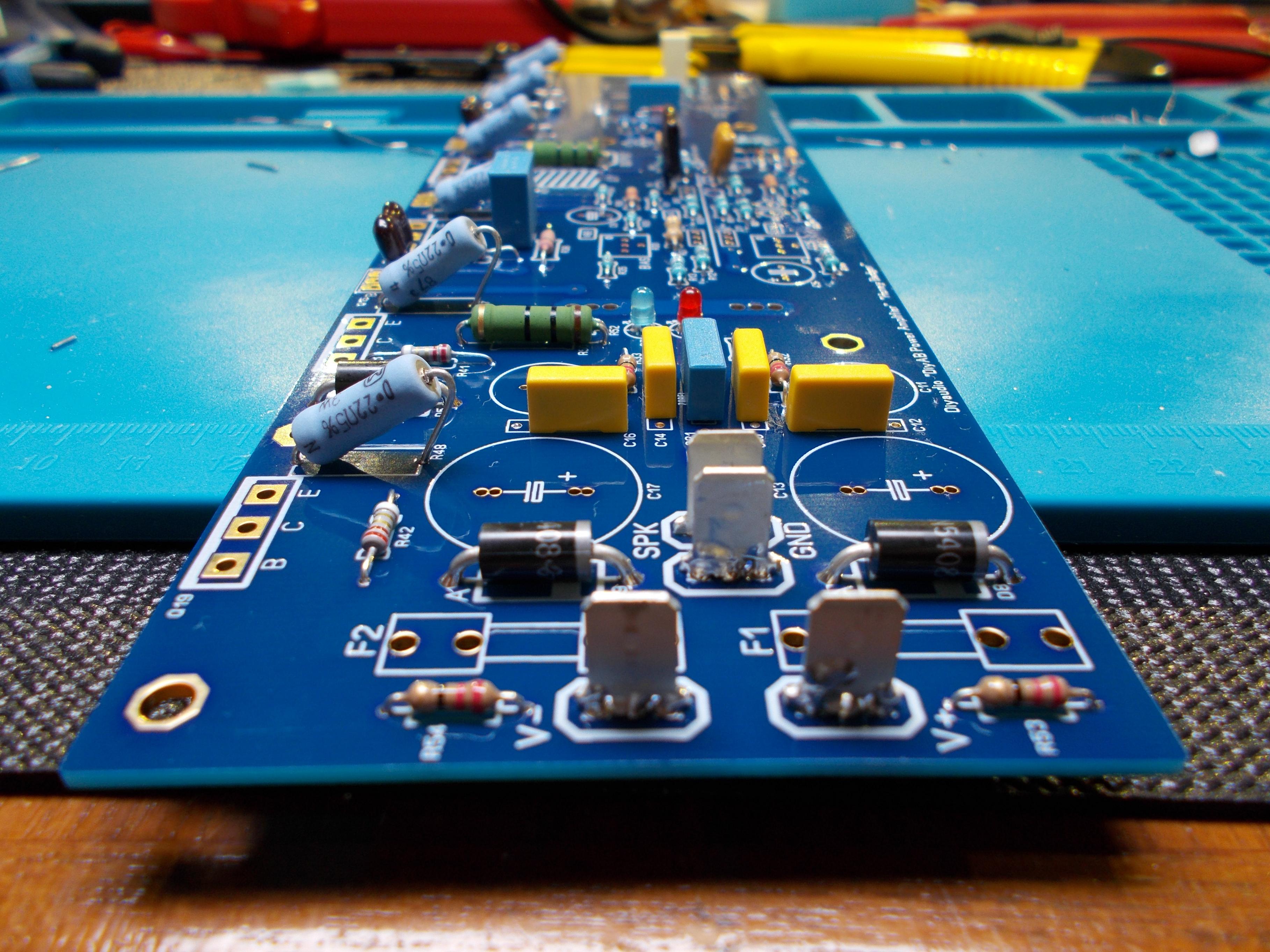

A few pics
Here are a few pictures, I've gotten further along install all the caps and diodes, still trying to find a VAS HS and one of the mica caps doesn't fit even though it was directly from the BOM.
Position of the trimmer pots
I'm getting closer to starting the amp up for the first time, with respect to the trimmer pots. It gives initial values, but it doesn't say what pins this should be between. For example the 200 ohm pot is set to 200 ohms max, and zero between the other side of the wiper.
If you are talking R7, the CCS pot, the honey badger board should short the pot wiper to one end. So if the pot wiper loses contact (and they do over the years) the resistance value goes to maximum.
The schematic on build guide shows R7 as a resistor, not a pot, so you'll have to look at the board to see what the layout people did.
By looking at the board, two pins will be shorted. Measure between center and the non-shorted pin taking care to install in the correct orientation that you measured.

Perfect, thanks takitaj. From a quick look the traces/pads didn't look shorted. However I didn't actual measure it with a DMM after installing it. I'll do it when I get home.
One of the three pots, doesn't have two pins tied together. I think it's the offset pot. Also another question, what length standoffs have others used? I want to mock it up so that it fits the 4U heatsink when I buy one, which won't be for a long time. The print out with the UMS hole patern doesn't exactly line up with the board either. I measured it and the measurements are bang on, but everything is a little offset with the actual board.
For the one that doesn't have 2 pins tied; set for equal resistance, both sides, to center pin.
