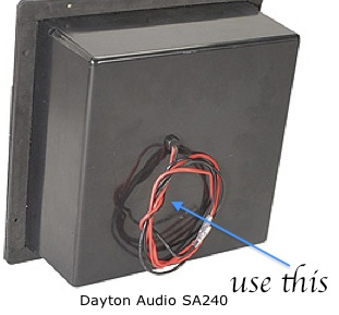

Inherited a home with built-in speakers, including an in-wall subwoofer. Purchased a Pioneer multi-channel receiver, front, center and back speakers work. Purchased a Dayton 240 watt subwoofer plate amplifier - plugged black and red into the amp from the sub. Running a Y from the amp to the receiver. No sound.

The outputs on most plate amps are on the amplifier pcb, not the red and black speaker <inputs> on the rear panel. Is this where you have connected your subwoofer? Try posting a detailed picture of both sides of the plate amp or a link..

The black and red are not connected to the back - there are black and red wires on the back, (those say they are the output lead for subwoofer driver).

You need to connect the speaker to the output of "HIGH LEVEL IN/OUT - TO SPEAKERS", which in your picture is to the left of the "LOW LEVEL - OUTPUT - INPUT". The low level input comes from, e.g.: the subwoofer output of your receiver, and the low level output allows you to send the processed signal to the input of another amplifier, and from there on to a speaker, the low level output cannot drive a speaker directly.
No that is wrong.
The hi level in /outs are for from L+R speaker channels from a
amplifier as inputs and the outputs are for the L+R speakers.
That why there are two sets of binding posts for in and out.
The plate amp derives it signal form the inputs and just adds
crappy capacitors in series to the left and right speakers.
You don't need them, don't use them.
The connections on the back panel have nothing to do with
connecting the subwoofer driver, that is on the other side,
they are the ~ 20" long leads you described earlier.
The low level inputs should be fed from a Y cable from your
AV amplifiers LFE output, set frequency to to max and level
to something sensible, us the AV amplifier to adjust.
FWIW the low level outputs are just a copy of the inputs,
pretty much next to useless in any practical setup.
rgds, sreten.

To start over, make sure all the speakers are set to small in the reciever menu then check that the subwoofer is set to Yes. Then you should attach a RCA cable to the subwoofer output on the reciever to a RCA Y adaptor and attach this to the Low level inputs (L/R) on the sub amp. Then use the red and black wires coming out the back of the sa240 (see pic) to get power to the subwoofer.
Yes, I agree. There should only be one speaker wire connected to the plate amp, the "use this" connected to the speaker cable from the in-wall subwoofer.
