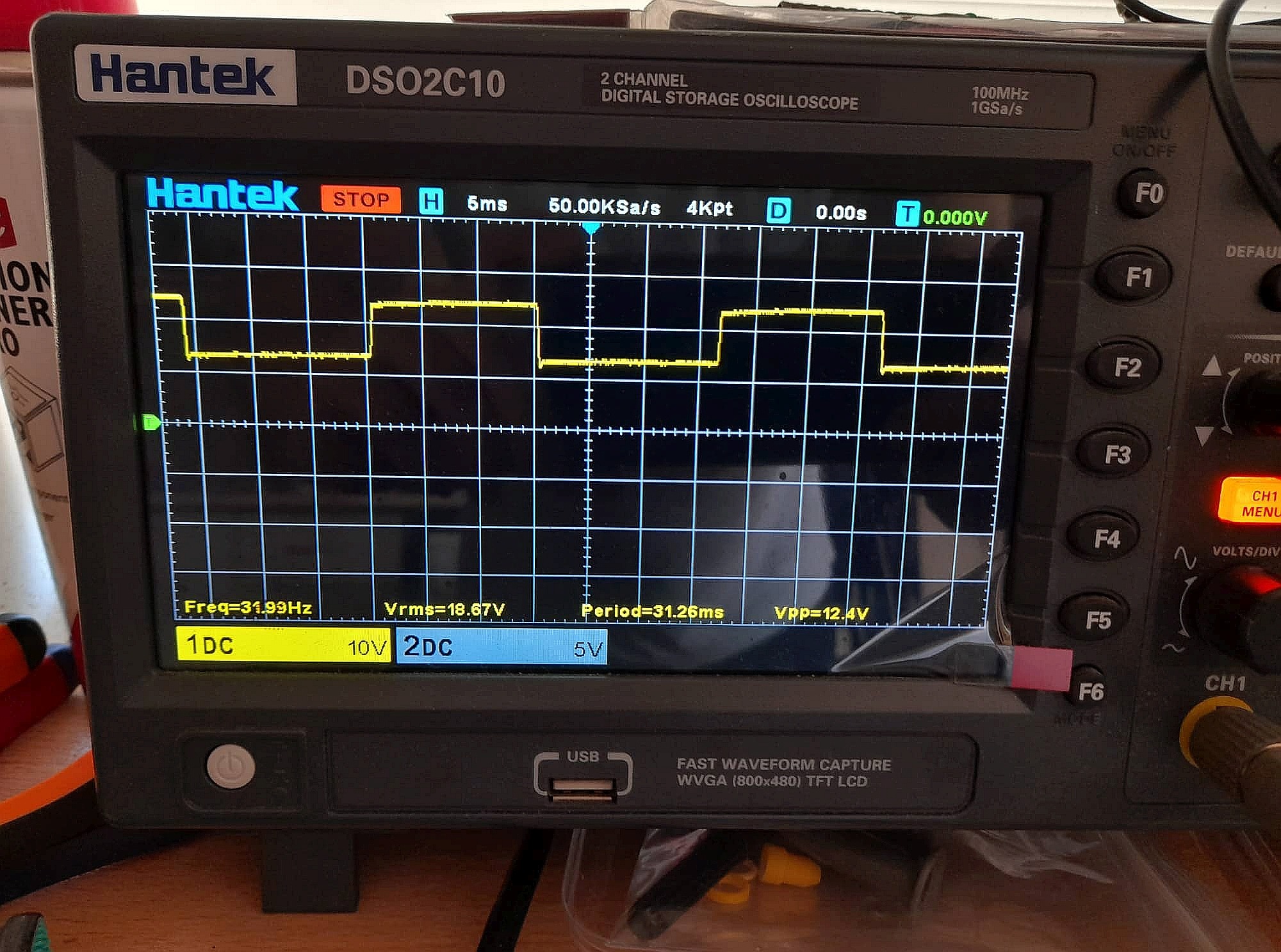

Amp now starts but the FLIP FLOP CD4013B shuts down the hip4080 thru pin 3 going high. I do have all the +12v, +6v from the regulator.
When driven to clipping at the RCA input I see a small square wave modulated at pin 7 of the HIP4080 riding the 6v DC.

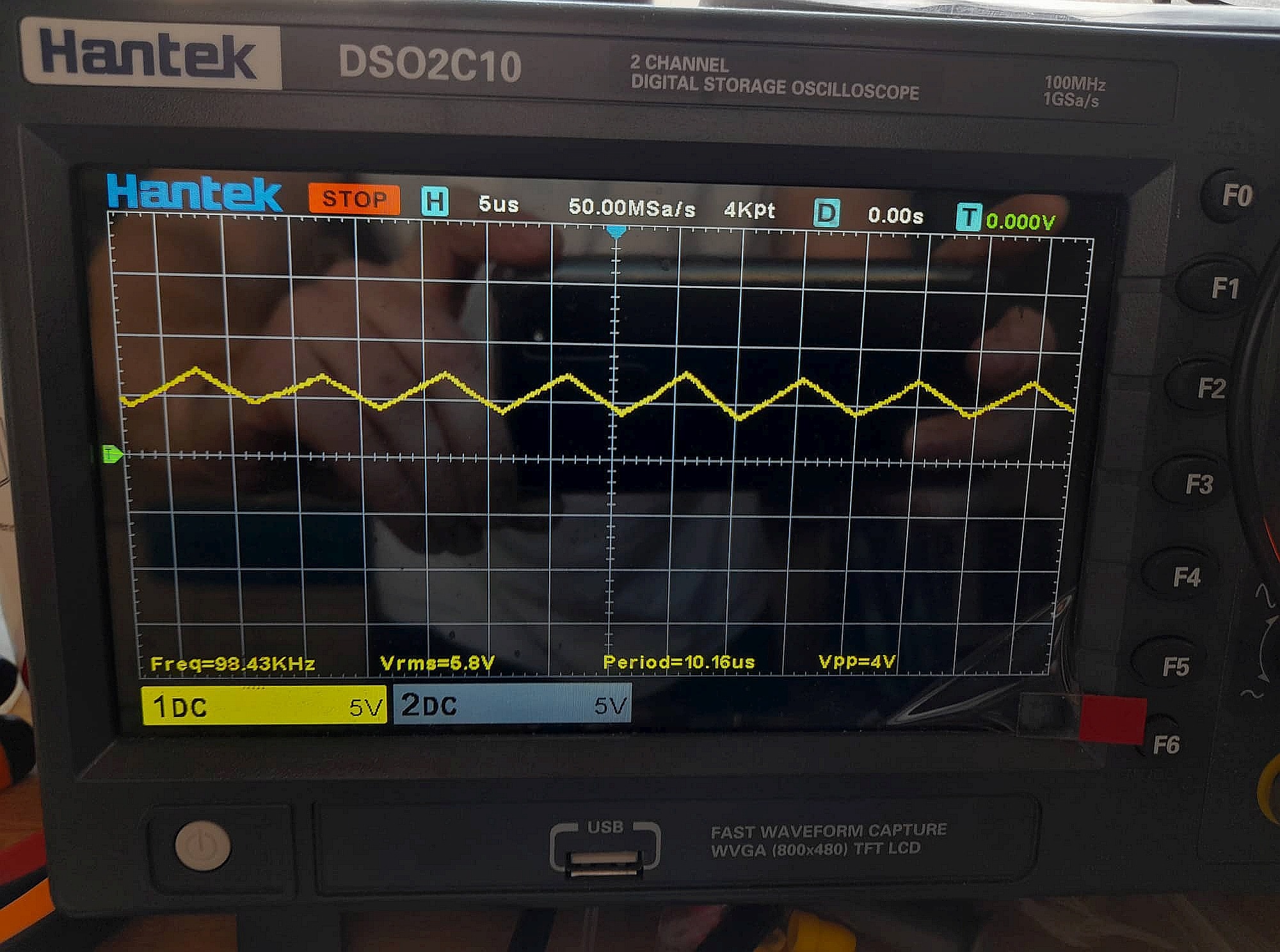

Pin 5 has 105khz square wave.
Pin 6 has the triangle wave.
Pin 1 and 2 have their 12v.
Only issue is pin 3 have 12.5v on it too, so the ic stays disabled.
Overload led stays on all the time.

If you leave terminal 3 of the 4080 out of the socket and connect the lifted terminal 3 to pin 4 (ground), does the IC produce output to the FETs?
the are square waves at the output at 105khz, shouldn't they be at 100hz the frequency i'm injecting into the rca's ?
I know from your guide i can use 10k resistor and a film cap to inject a signal directly into the hip 4080 but the issue i feel is in the pwm/comparator board ?
With disabled protection as Perry suggested, across the terminals there is a square wave with the frequency injected thru the RCA, riding along some DC.

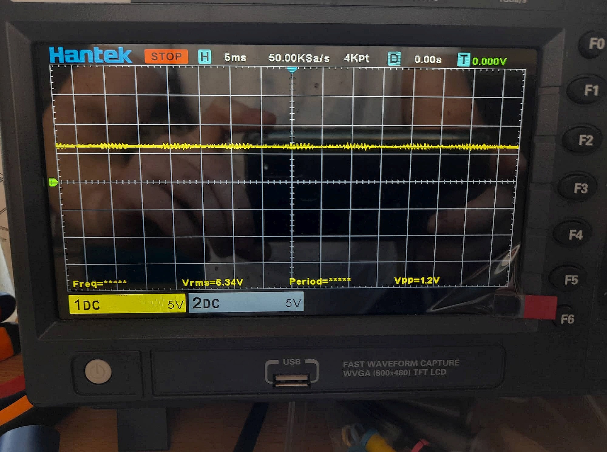

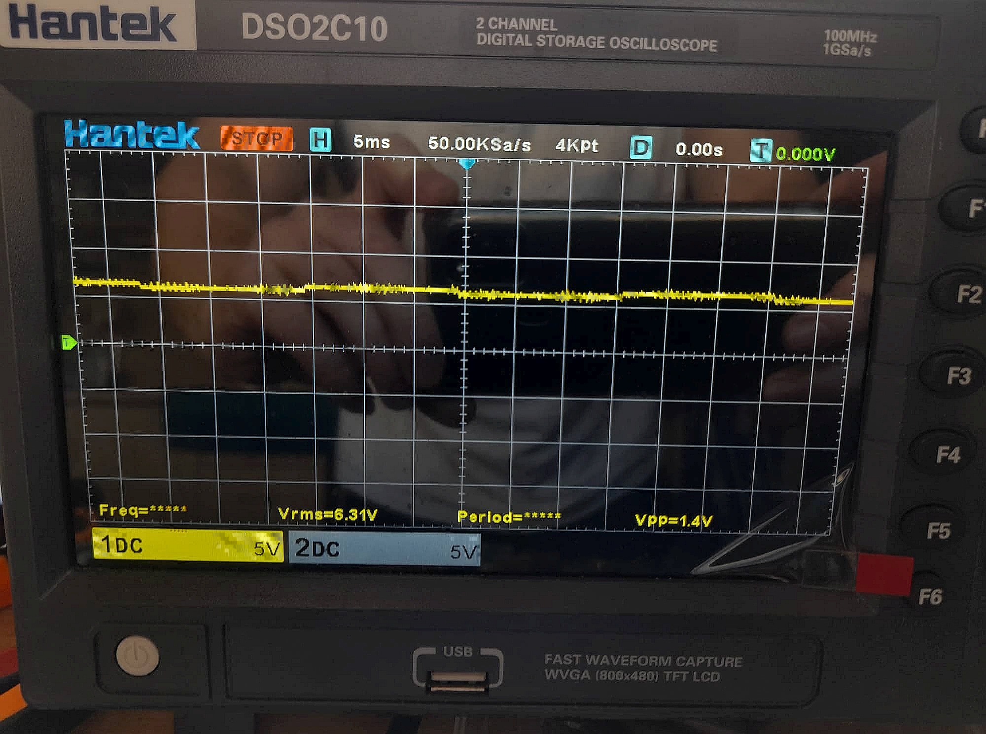

Even with no bridge at terminals 1 and 2 of the 2274 there are 6v DC at pin 7 at the hip4080.
When amp is starting up or during the start up, there are 9v at pin 1 at the 2274, but in a 1-2 seconds afterwards, it quickly drops to below 1v.
pin 7 at the hip4080 stays 6v all the time,
