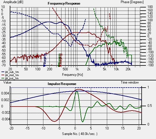

hi,
i'm trying to time align the drivers of an active 3-way system. i have kx-project which lets me DELAY the audio stream of individual drivers at the resolution of the sampling rate (48khz).
- i have a microphone at 1m on the height of the tweeter.
- i lock the time zero on the tweeter
- i measure each driver's response with the crossovers in place
- i count the number of samples until the tops in the IR match and i delay the appropriate amount in the dsp.
- i measure again to verify that the tops match.
the result is nasty dips in the FR close to the crossovers. what am i doing wrong?

On my 3 way system I lock to the midrange. For some reason I have a hard time getting consistent delays from the tweeter once it has been crossed. I use the 1st positive peak as reference.
I definitely see different delays with the crossovers in place. That makes sense, as the crossover will shift phase.
Are the nasty dips just one dip at each point, or multiples? Have you tried reversing the polarity of any driver to see what it does to the dips?
Saving the impulse response of the whole system and looking at it as a sonogram is one of the best ways to see if the drivers are aligned. You can do sonograms in ARTA and some other visualization softwares.
As for mic placement - ideally you'd want it right were your head is when you listen. But closer than that will often work. Try to think of how the sound waves will integrate on the way to your ears and place the mic accordingly.

thanks, panomaniac!
it sounds like i was doing the right thing from what you are saying. i was getting some results that didn't make sense to me so i got frustrated and didn't save any plots. i will try again soon and definitely post some results.
i was able to successfully align the 3 drivers on the first positive peak. then i moved the microphone to another location and took measurements again. the 3 impulse responses were still aligned on the first positive peak. but there are some observations that made me doubt that this was actually working.
1. my system frequency response experienced a dip a little after the mid-tweeter crossover. i tried flipping the phase on either the mid or the tweeter but that shifted the dip and did not eliminate it.
2. i measured the distance from the center of the voice coil of each driver to the baffle plane. tweeter - .5cm, mid -3cm, woofer - 7.5cm. at 48khz sampling rate a cm = 3.3samples (give or take). my measurements showed that i needed to delay the mid driver about 10samples which sounds correct but for the woofer i got 55samples which is twice as what i estimated.
3. i was under the impression that correctly implemented digital filters don't affect the phase. i use kx-project which employs digital crossovers and filters in the sound card dsp. they have no specs or documentation on their components but the author claims that the crossover doesn't shift the phase. now i tend to think that all crossovers affect the phase in some way so i will have to make some calibration measurements on the crossovers to understand better how they work.

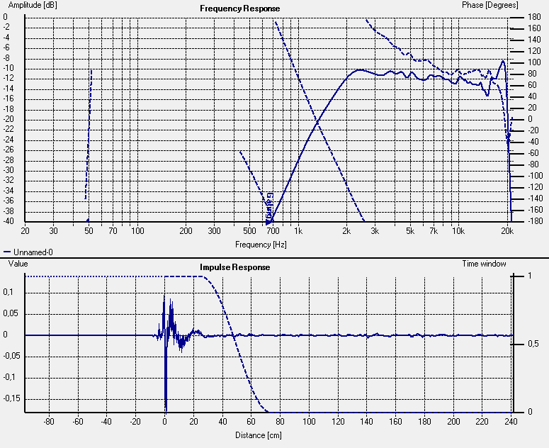

Just discovered HOLMImpulse today, it's the best piece of measurement software that I have tried 😀
The following measurement is BMS 4552Nd on 18Sound XT1086 horn at 1 meter on-axis, with constant directivity eq, LR24 crossover at 1400Hz and group delay correction for approaching actual acoustic LR24 response (all done with DCX2496).

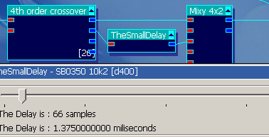

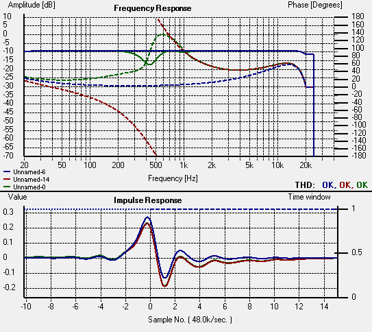

ok, i was partially able to answer my question but i raised other ones. i ran a cable from the output to the input of the sound card and did some measurements on my dsp setup. the DELAY i'm using is causing a drop in the frequency response around the crossover.
blue = straight loopback signal. pretty standard for audigy 2 zs i suppose.
red = a 4th order LR crossover at 500hz with kx-project
green = the previous crossover with 66samples delay on the high end
the delay module introduces an obvious dip in the frequency response. i thought if i graph each hi-low segment with-and-without the delay i will see inconsistencies in the FR, phase or the IR but it doesn't seem to affect them. it only shows up when they are summed up together.
can somebody explain what's going on and how can i get around it?

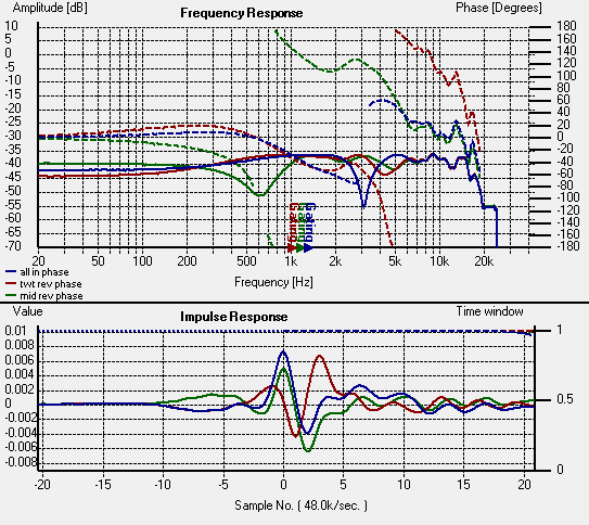

and here are some measurements on the actual drivers. the first picture shows them time aligned on the first positive peak. the sub and mid are accentuated for clarity.
in the second pic blue is the whole system with the dip.
the red is with the phase on the tweeter flipped and the green is with the phase on the midwoofer flipped.
can somebody shed some light on what's going on?
