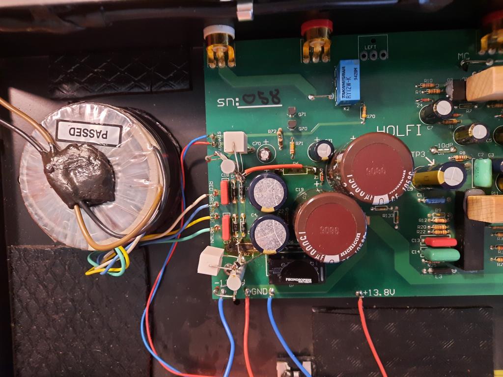

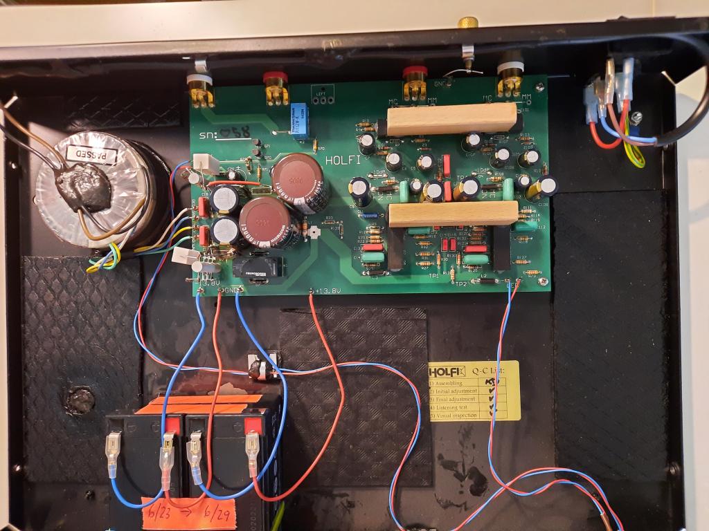

Ran into a strange issue last night while re-connecting my Holfi battriaa phonostage to my toshiba sa7100.
I lost the left channel from the phono input side so i took the cover off and found the whole chassis to be microphonic. If i tap on the metal chassis it creates thumps from the speakers.
Some kind of grounding issue maybe? The holfi is grounded via mains earth using a spade connection. The toshiba SA7100 has recently had its reservoir caps replaced with Mundorf AG+ (4 pole), so i'm not sure if this has anything to do with it? From what i could gather the transformer centre tap is no longer used with the 4 pole caps.
The turntable (rega RP3) grounds through the phono plugs as far as i know and dosent have a separate ground connection.

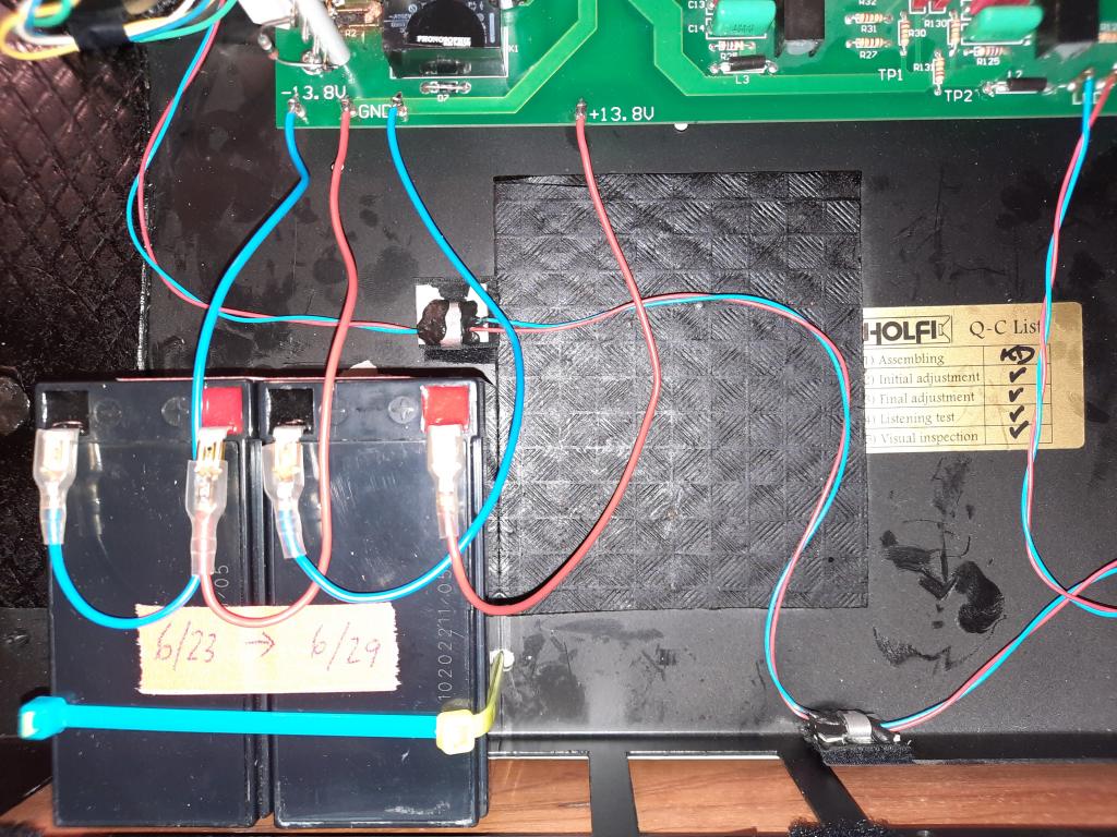

Thanks DF96, i resolved the issue last night, it was nothing to do with the amp.

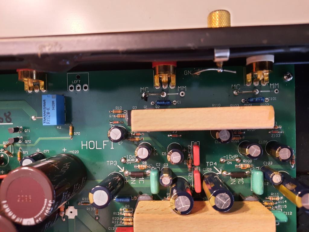

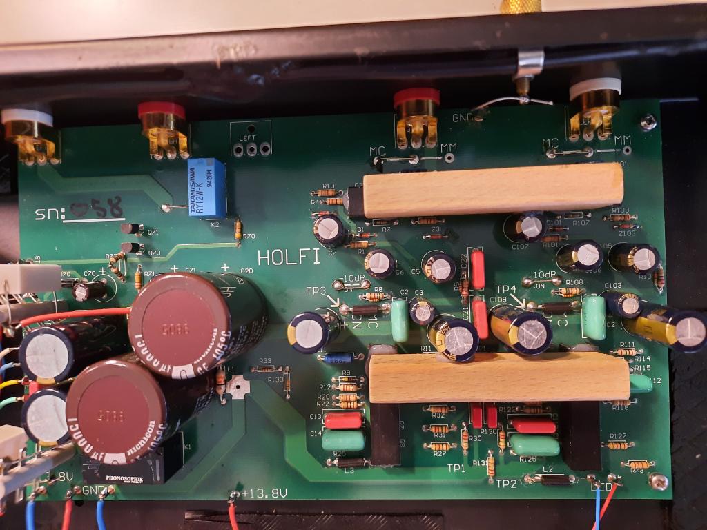

The holfi battriaa i have uses 3 pins at the back to select whether its MC or MM cartridge you are using. These pins are shorted with a small wire, rather than just using a switch. One of the solder joints was slightly loose so i reflowed it and no more feedback from tapping the casing.
Who would have thought!

A good approach is the avoid of switches for select MM and MC - instead this a soldered jumper.
