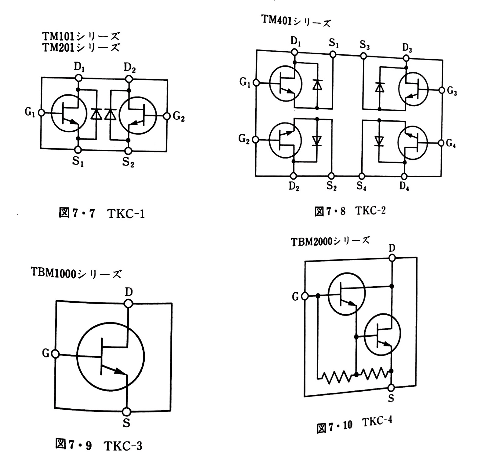

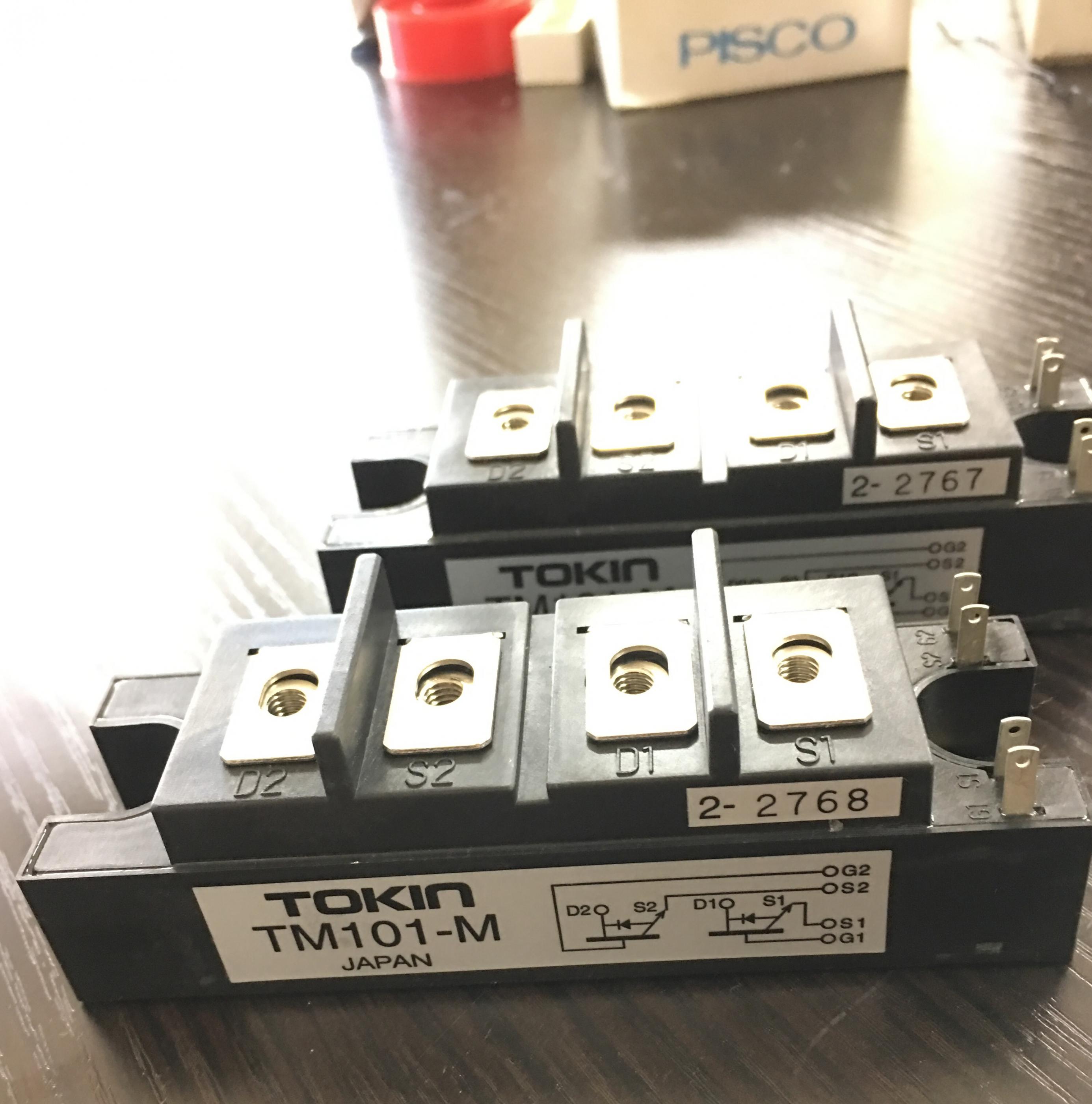

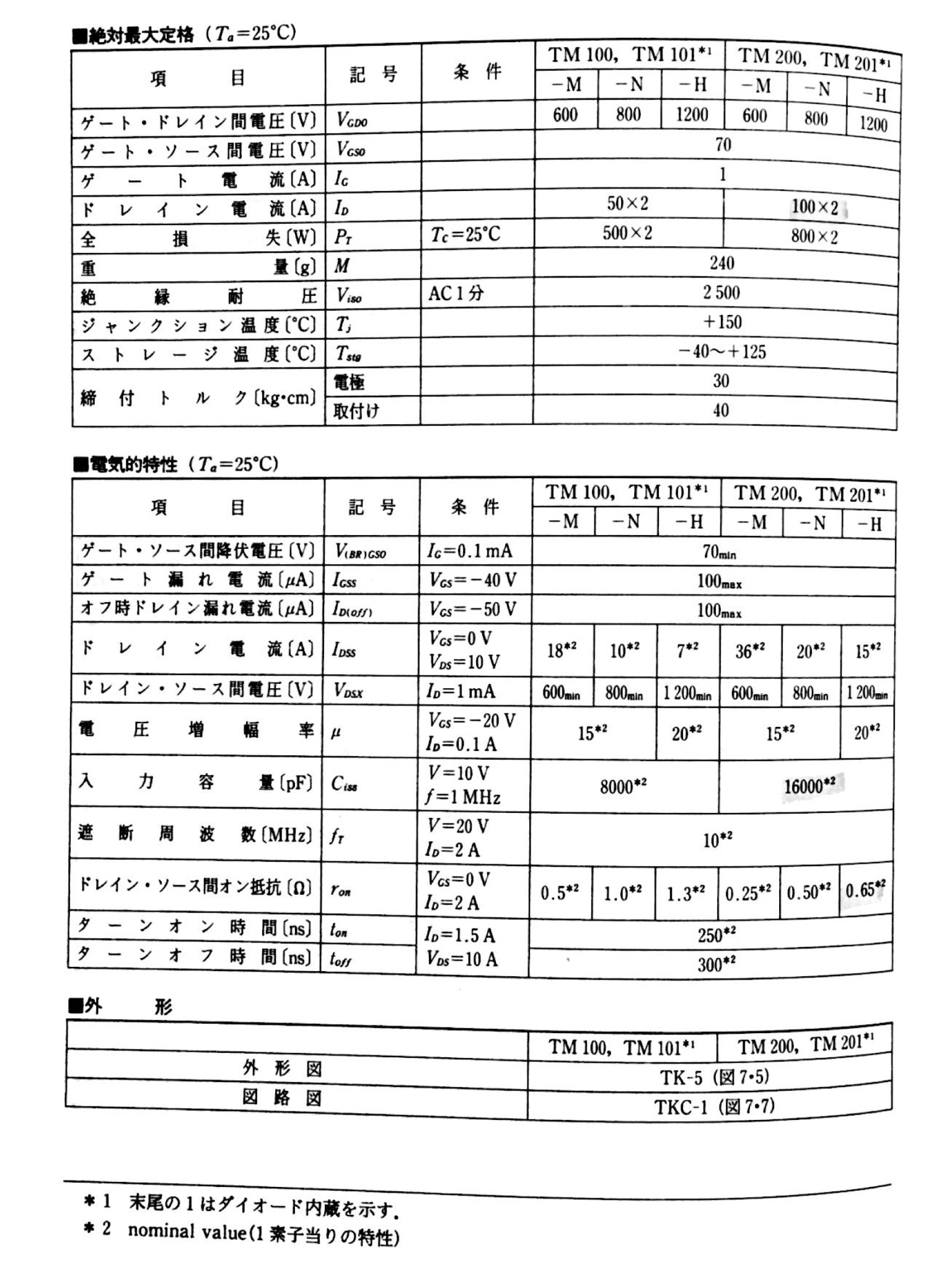

Datasheet of TM101-M Tokin.

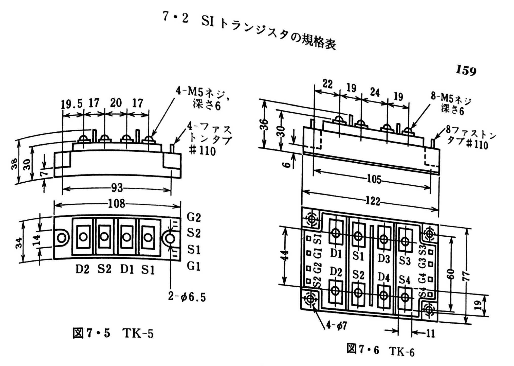

Two SIT's in one package 😀
One TM401 = four SIT´s = two balanced stereo channels
Giant

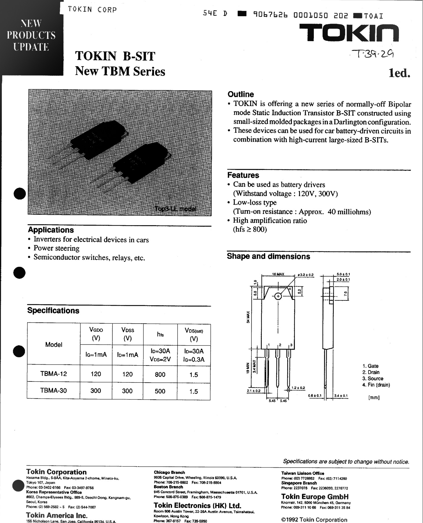

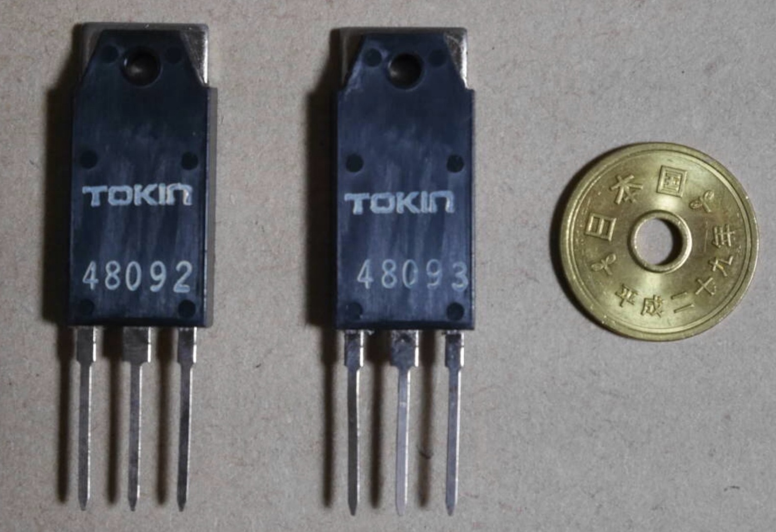

Tokin TBM2000 = Darlington SIT crazy 😀
well, I don't have these ........![]()
Exotica like for the Cabinet of Curiosities..

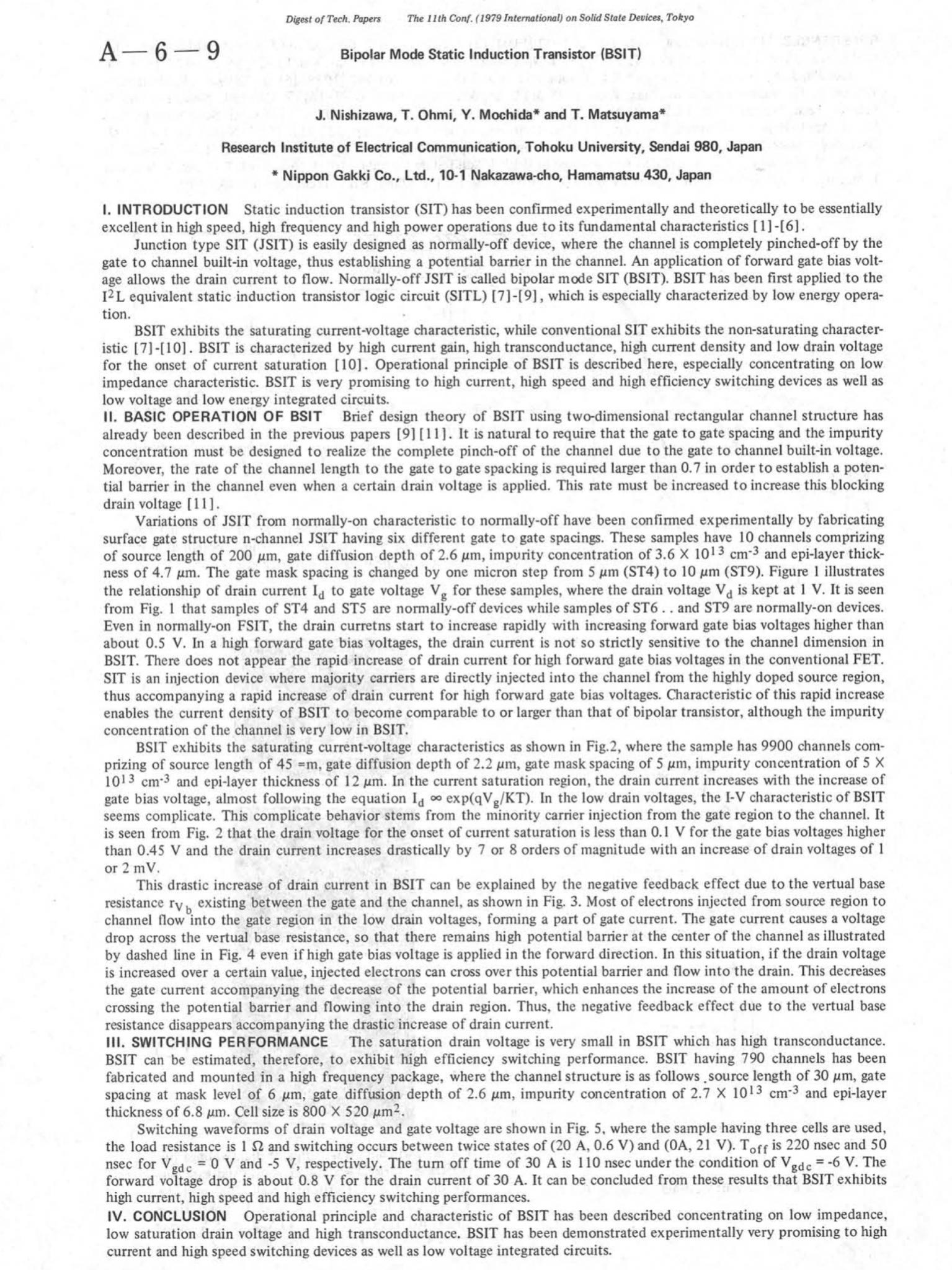

Bipolar Darlington SIT's 😀

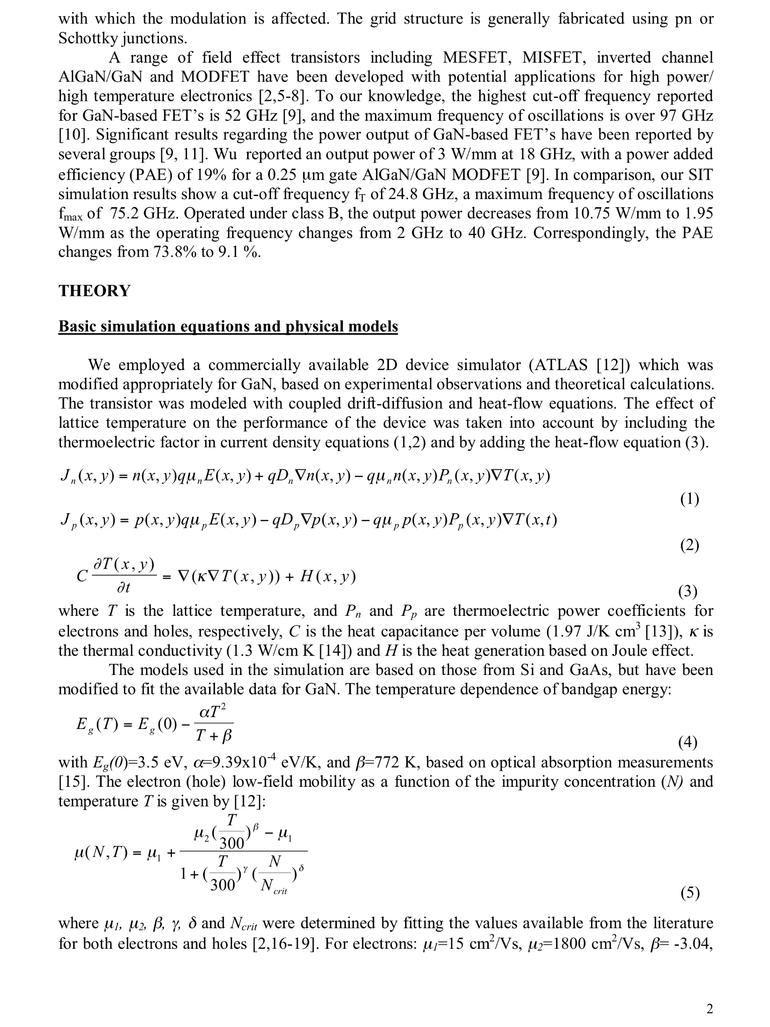

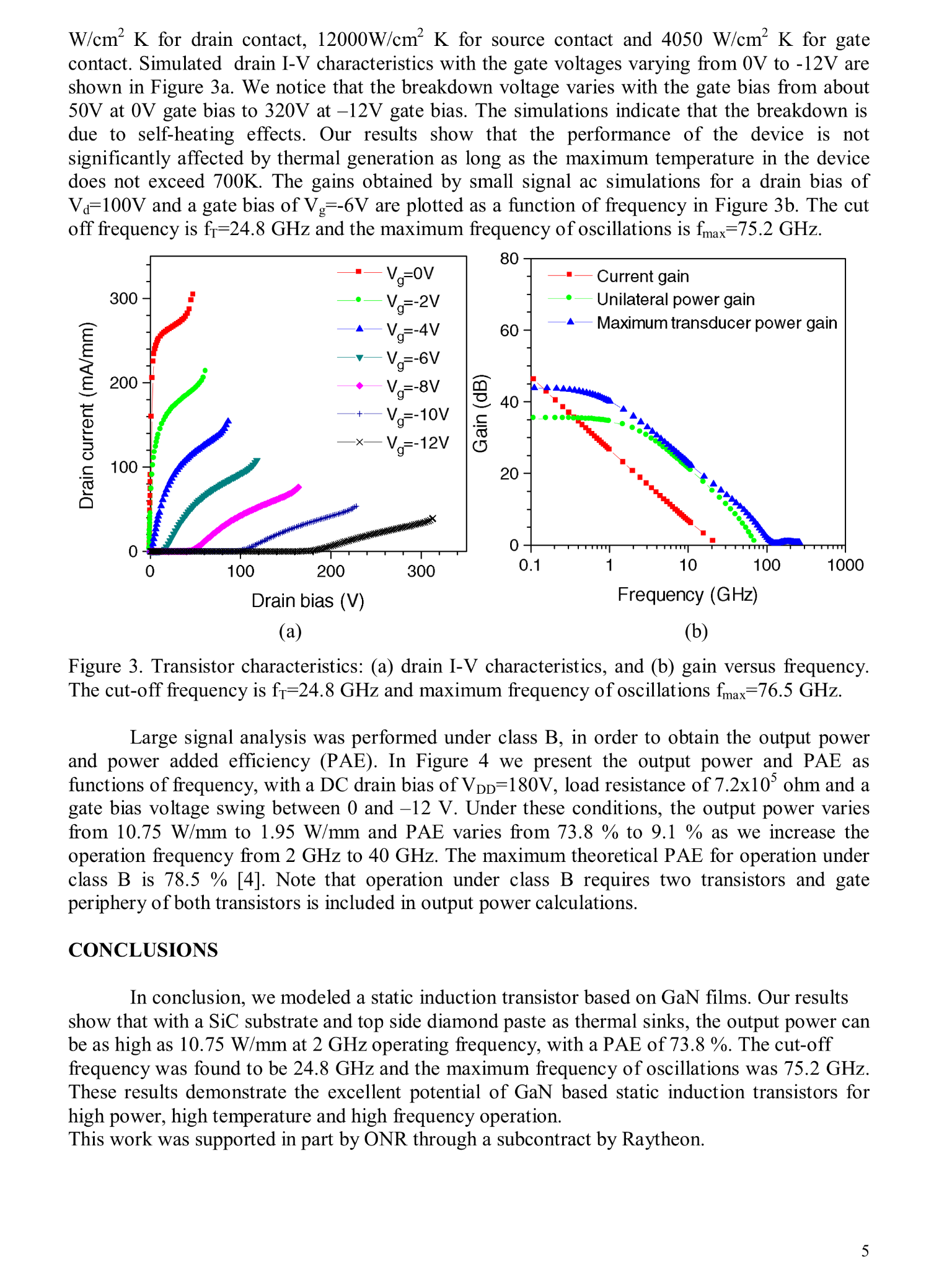

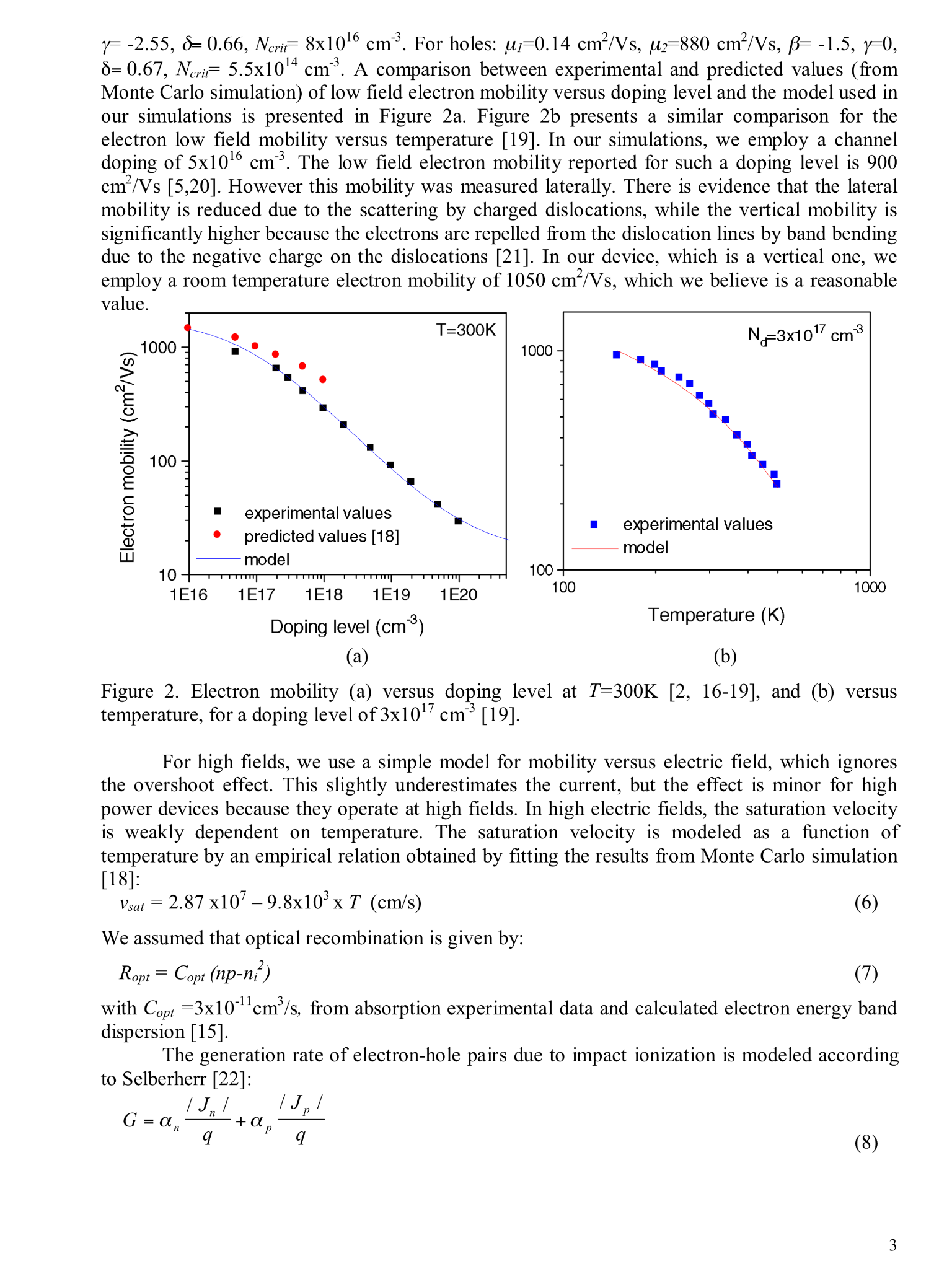

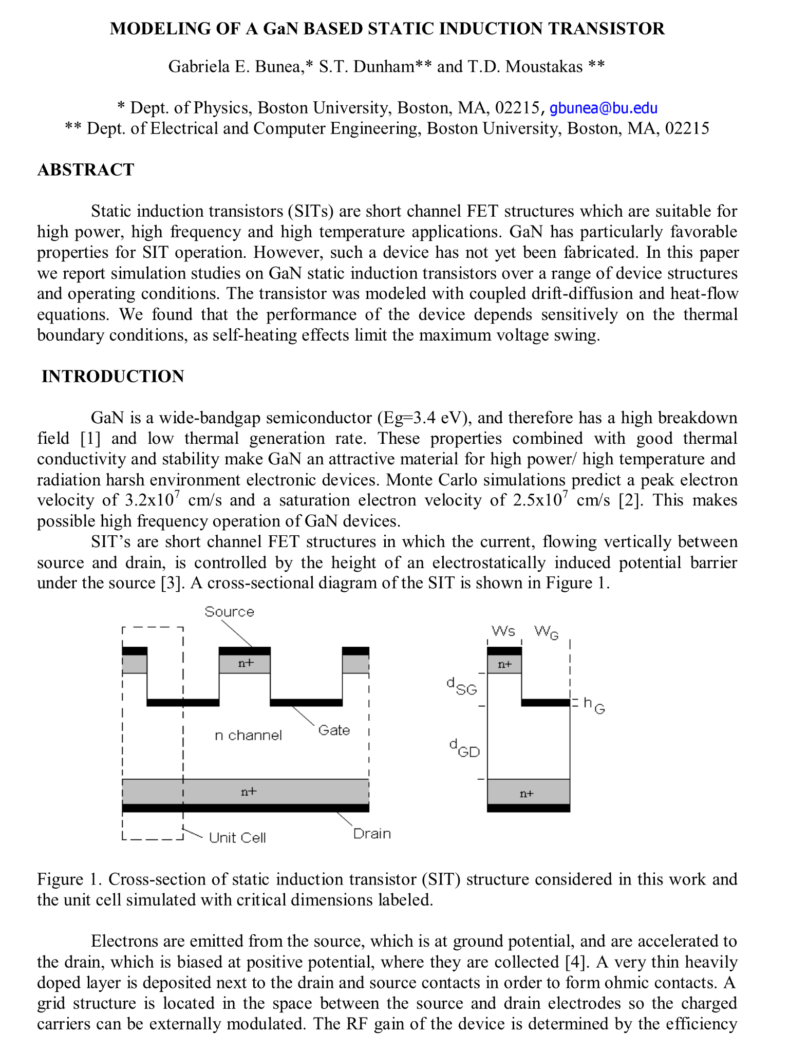

Edit: add curiousities about GanSIT's

It's probably been posted somewhere round these parts already, but as stated on page 9 of the attached PDF, the BSIT (at least the Russian ones) have pentode-like characteristics ("...выходные ВАХ БСИТ, как и у традиционных БМТ, имеют пентодный характер." ==> "...the output I-V characteristics of BSIT, like those of traditional bipolar [power] transistors, have a pentode character.").
Furthermore, they are enhancement-mode / normally-off devices, as conduction when VGS = 0V is considered a drawback in their intended application ("Из-за нормально открытого состояния транзистор со статической индукцией имеет ограничения по применению в ряде радиоэлектронных схем. Транзистор со статической индукцией с нормально-закрытым каналом, так называемый БСИТ, предназначенный для работы только в биполярном режиме, не имеет данного недостатка..." ==> "Due to the normally-on behaviour, the use of SIT in various electronic circuits is limited. SIT with a normally-off channel, the so-called BSIT, designed to operate in bipolar mode only, do not have this drawback...").

Do KP959A show pentode curve because like Tokin this is two SIT's inside of one package connected in darlington configuration ?
What curves transfer is with two 2SK180 or 2SK182ES or THF-51S if darlington ? Or darlington of two Sony Vfet's ?
