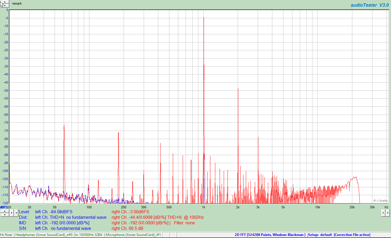

Two tests were performed on each tube type (12GN7 and 12HL7).
1. Distortion with UPT-2 as a plate load ( Spec 29H at 110mA)
2. Distortion with cascaded DN2450 Current Source
Test 1 UBT-2 plate load
Va = 250V
Ik=10.1mA Rk 344 Ohms w/ 1000uF cap in parallel
Plate load UPB2 with a 220 ohm resistor on the 8 ohm, output giving a reflected load of 132K in parallel with a resistor divider consisting of 100K and a 10K pot capacitively coupled to the sound card input.
The total effective load is thus 110K in parallel with 132K or approximately 60K This is probably low compared to most 300B Grid resistors (for cathode bias, but probably close for fixed bias), however I was limited by the UBT–2 as a plate load and the sound card input.
12GN7 (This was the worst of the 20 tubes I have)
Vo 70.4 Vrms
Vi 1.84 V rms
Gain 38.3
THD = 0.617

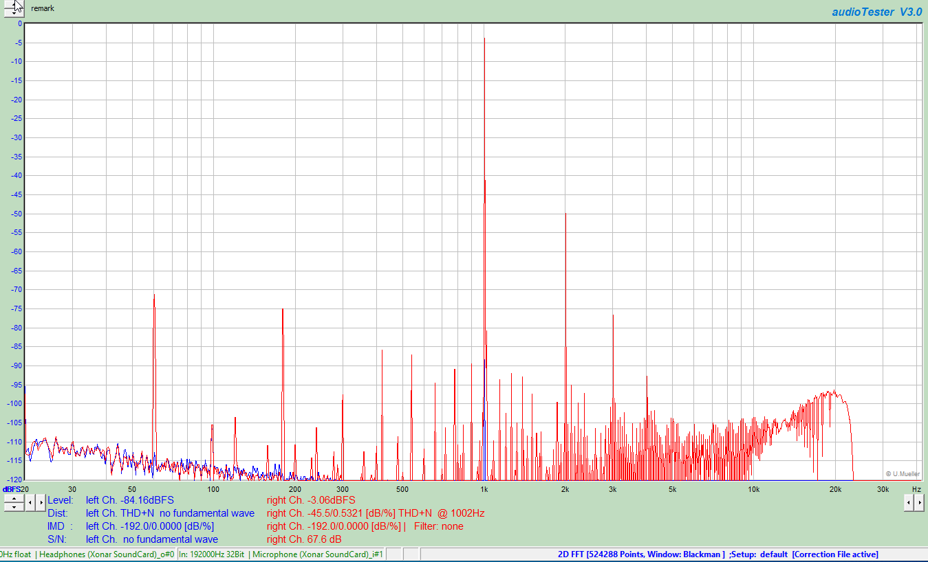

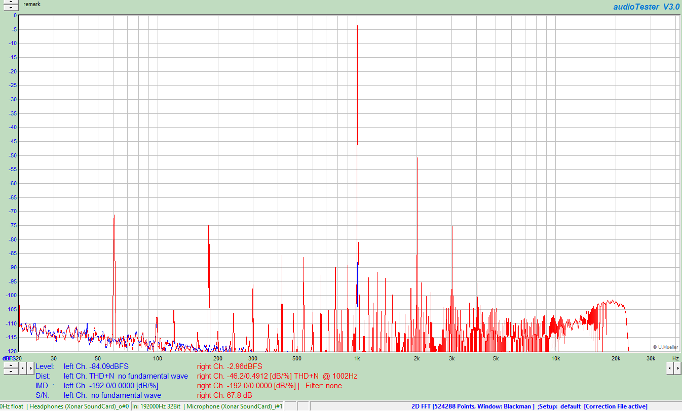

Test 2 Cascade DN2540 plate load
Va = 230V (Cascode adjusted with Rk kept constant)
Ik=10.3mA Rk 344 Ohms w/ 1000uF cap in parallel
Plate load equals capacitively coupled gate input and G-S resistor which for a source follower is in the 10s of meg ohms.This buffers the resistor divider consisting of the 100K resistor and a 10K pot capacitively coupled to the sound card input.
12GN7
Vo = 70.4 V rms
Vi = 1.80 V rms
Mu = 39.1
THD = 0.532
I made an interesting observation on the 12GN7 when driving the choke load. Somewhere around 14 ma the tube started running away. The 12GN7 is not a sweep tube, and has a Vg2 rating of 300V. As long as I kept the current around 10-12mA I had no issues.
The advantage I see to the choke load is it requires much less voltage than the CCS loaded topology. This is because the choke can swing nearly twice the anode supply voltage.
Both tubes show dominant 2nd harmonic with much lower 3rd and fourth. Harmonics beyond fourth were below the noise level of my test system and at least 100dB below the fundimental.

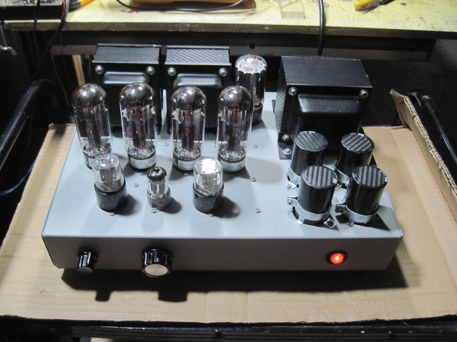

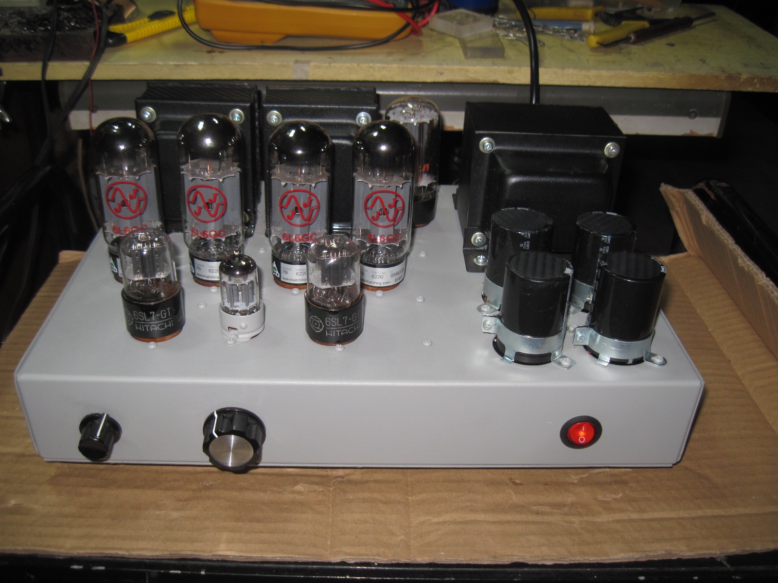

you may also want to try the 6SL7 long tail pair instead of the 6sn7, i made such an amp, that used the 5814 as voltage amp in the Mullard 5-20 type topology.....
What would be the advantage of using 6SL7 over 6SN7?
remember that the original Mullard 5-20 used the 12at7 as long tail pair, so that i merely switch to an octal sibling. but frankly o liked the sound better, i do not imply superiority over the 6sn7 but just that i liked it when i tried it...
and since i do not need the gain of the ef86, i went for the 5814 with lower gain..
