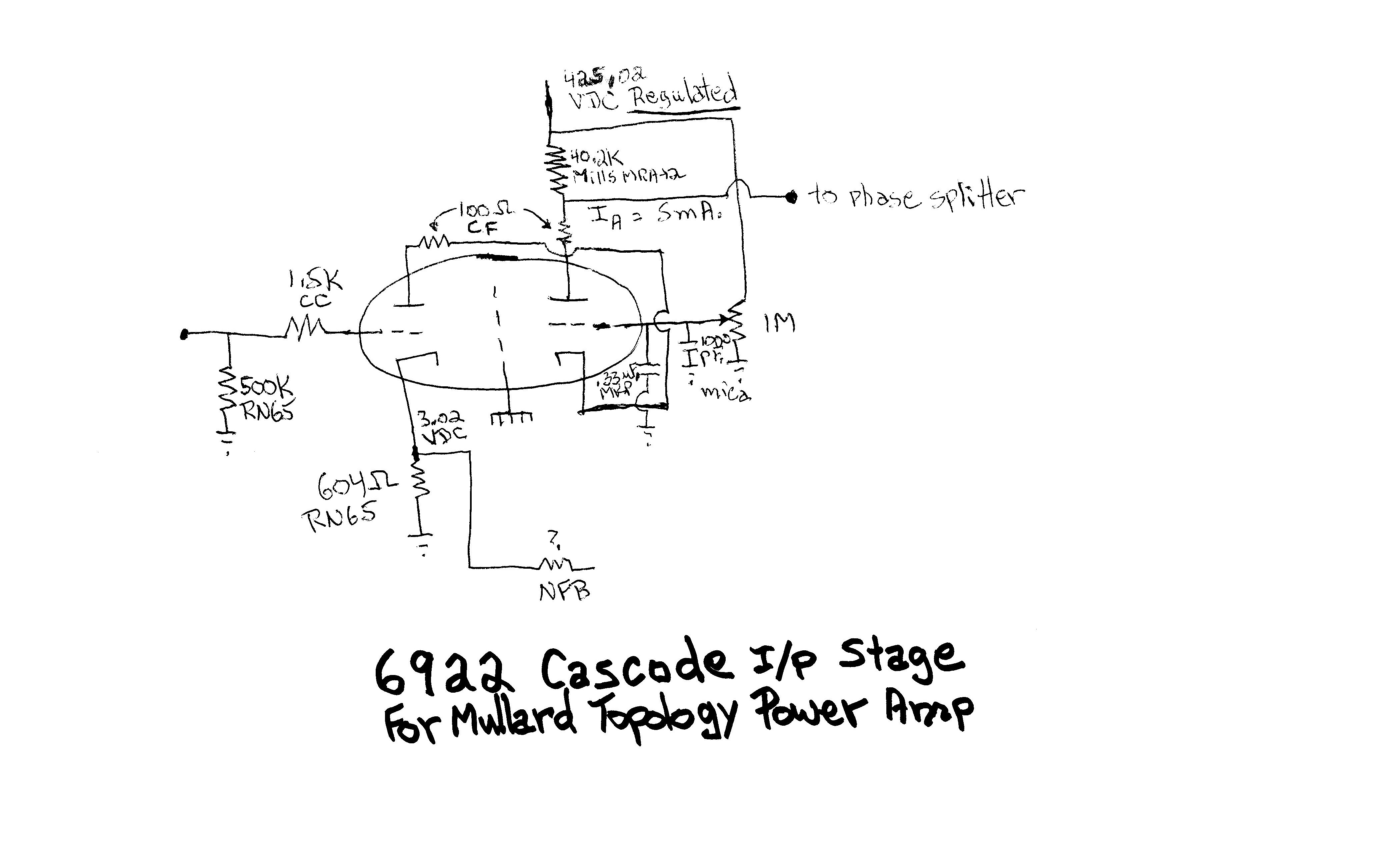

FWIW, I favor in production types, when contemplating a substitute. The provided "hen scratch" 6922 cascode is intended to replace high gm pentodes in units like the H/K Cit. 5.

Being one to like big pentodes for signal amplification, there are ooodles of tubes to run instead of the 12BY7. Gain will vary a bit if you choose higher gm tubes...and on that I will say *AT THE OPERATING POINT, DELIVERED GM that is. An 8233 is 45 mA/V per the data sheet, but at 5 mA I have noooo idear. The D3a is another...but at the OP, its gm will likely be less than the published spec.
On the cascode, if you're going to do that let me suggest a MOSFET instead of a second triode. The twin triode is going to have some issue delivering signal much below 2x the upper element grid voltage. A triode on the bottom( perhaps a 5687 section), with a FQP1N60 on top will swing to nearly its gate voltage. Type 6H6Pi will be similar. The real pentode, at the expense of g2 current has nooooo issue swinging its plate below the g2 voltage.
The upper triode grid voltage is what used to be labeled on maps where topography was unknown as 'Here be monsters'. Go past it knowing the circuit gets a wee bit wonky.
cheers,
Douglas

FWIW, I considered a hybrid cascode, but was approaching things from a perspective of what to do about keeping existing units functioning well using in production types, when the tubes they use are no longer available. The 12BY7 is fast disappearing :mad: (New Sensor please pay attention) and I wanted to preserve whatever supply is available for the more complicated H/K Cit. 2s.
FWIW, 12BY7 out and 6922 in (IMO) makes an ECC99 LTP more attractive, as the net demand on the heater supply is slightly reduced.
Speaking of hybrid cascode high gm voltage amplifiers, what do you think of using the Russian 6C45Π (6s45p) as the triode at the bottom of the "totem pole"?
The triode's suitability goes in about 2 pieces. Gm for gain, and low plate resistance so as to reduce the faux g2 voltage. Since mu basically eats plate resistance, I have not looked at the 6C45Pi...

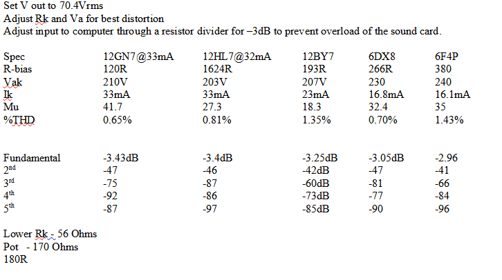

I just finished running characterization of the few (used) samples of the 12HL7 and 12GN7 along with new samples of 12BY7.
From my limited testing, they are not plug in replacements. Biasing and plate load need to change for optimum operation.
I have new 12GN7 and 12HL7 on order and will perform the test again when they come in.
My interest is in using them as a driver for a 300B.

A few weeks ago I was toying with the idea of using a triode strapped pentode to drive a 300B.
I dug out some candidates and ran some quick tests to see how they would do and was pleasantly surprised, particularly with the 6DX8 video amp pentode section.
This got me doing some reading which lead me to this thread.
Since several of the tubes I tested were used and I had no new samples I ordered 20 12GN7s and 10 12HL7s to test with.
Those came in recently and I have been testing them.
