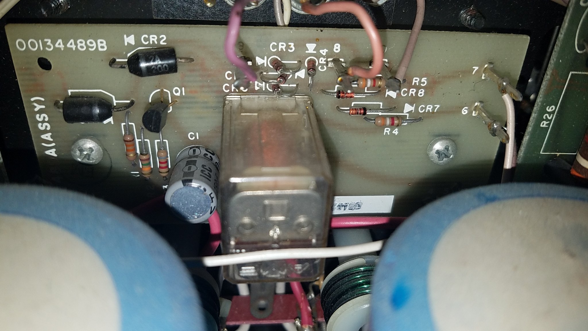

I am the owner of 2 of these monsters, I popped a cover off of one ( a 16A) to take a look around and...... found that, the "protect board" is a hybrid between the 16 ( delayed turn on only) and the 16A with DC sensing protection to the relay. The board I have, has the same assembly# as yours - 00134489B, which seems to be some interim config between the 2. That being said, it seems it has 2 red wires going to the L & R INPUTS from pins 8 & 9, ( Purple & pink wires on top) which, may have some strange input limiting arrangement because there are also small signal diodes near it. I would try to disconnect the wires from that board to the suspect channel and check it for any voltage coming off of the board.

Hi Huggygood. Thanks for the response. I fixed the darn thing in the end, more on that in a minute. Regarding the weird relay PCB's, I found two very interesting Service Bulletins from HK, Signed by Len Gaynor. You are correct, boards were being blown up due to input overload. They even provide a troubleshoot procedure to determine. Anyway, SB #208 (5/78) and subsequently SB #209 (8/78) explains it all. Guessing you would find it interesting. I found it poking around HIfiengine, but be sure to look at 16A, not 16 as we are aware of those differences. If you can't find, PM me your address and I'll slip hardcopies in the mail, no sweat. Regarding the fix, it was the 2916's the whole time. Whereas I had sourced and replaced those right up front, they must have been some Chinese junk or otherwise poor quality. I found two Motorola's from a garage sale (retired NASA engineer selling all his stash) and installed those. Bingo, problem solved and untold amount of beating my head against the wall was over. But I leaned something, non the least of which is a community of good and interesting souls here on DIY. Thanks again, take care.

I am a bit perplexed on how you stated that, the trouble did not change when you swapped boards, but you claim it was driver board Q's that needed replacing that fixed the issue. Regardless of that, I am glad you got it fixed. 2N2916's have no "modern day equivalent" , some are still in stock looking at an Octopart search ( link below) , but I am sure they could also be replaced with a matched & thermally coupled pair of NPN's with the right gain and voltage characteristics.

I can't figure out why they put a "Input limiting circuit" into the protect board like that, as I have seen that in no other amplifier, and it is not present in the final Series A protect board, although they do use a 2 X 2 signal diode config to limit the DC level driving the Op Amp that triggers the Q2 transistor to sink the turn on voltage on Q1 and having it shut off the relay on the last version board.

Oh, and if you haven't already done so, make sure you replace that "C1" cap on the protect board soon, ( 150uF, 16VDC polar), as if it is the original and shorts, which it it may be already doing, it will pull the base voltage off of Q1 and the relay will never get energized to close. I recommend a Wurth
