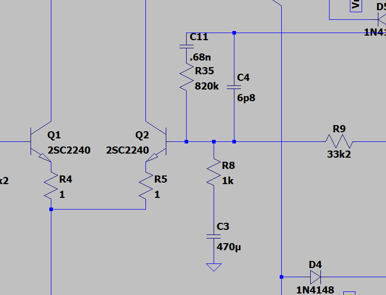

Sure! You just need to find C4, R4 & R5 on each board, that is where the modification is done.
-Jumper the LTP emitter resistors R4&5 (or replace with 1ohm resistors) change the compensation cap C4 to 5,6p or 6,8p. I prefer MICA, but NPO is ok too.
-Then you put a resistor and cap (I used poly cap) in series (C11/R35) and put them parallel with C4. This is the nested feedback. The values are a bit 'to taste' as I describe in post 5, 4 and 26. I used 0.68n & 860k. You could probably run some wires to the outside of the amp to play around with these values and listen to the result. The values do not effect the stability of the amp, just the amount and frequency response of the global feedback in the amp.

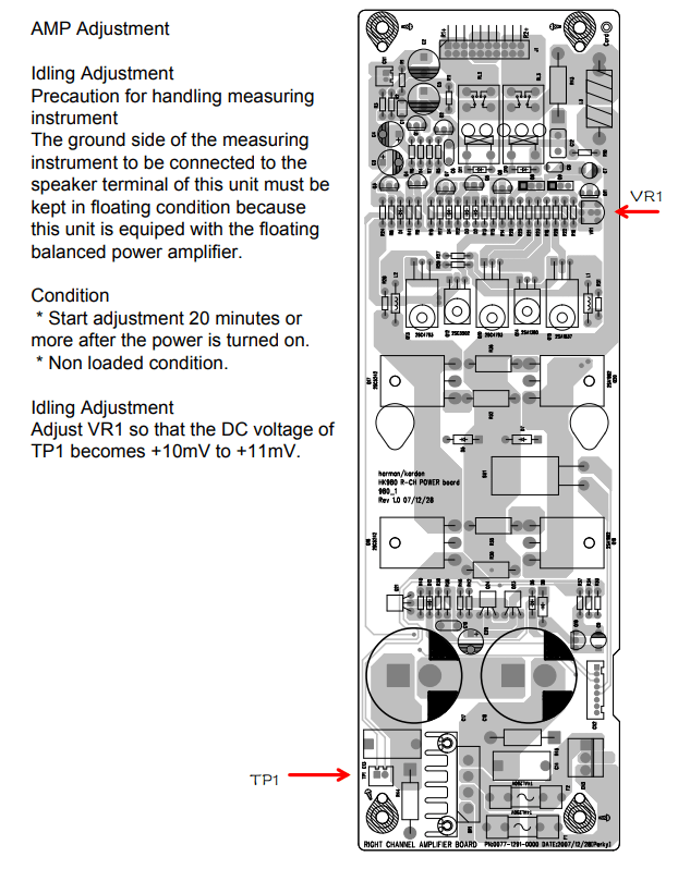

As mentioned earlier, I also adjusted bias and removed the muting circuit, but bias can be adjusted per manual to 30mV, and the muting circuit is not a significant change, I just wanted to do it :)

I think it will be fine. You get higher damping factor in the bass with the mod, mid and treble is about the same as standard (depending on R35) as the original amp.
You could say the R35 resistor determines the sweetness vs detail in the mid/highs. Higher value = more detail, lower value=sweeter sound. The C11 capacitor value determines at what frequency the damping factor starts to increase, lower value, higher frequency. You should end up with values not too far from mine I think.

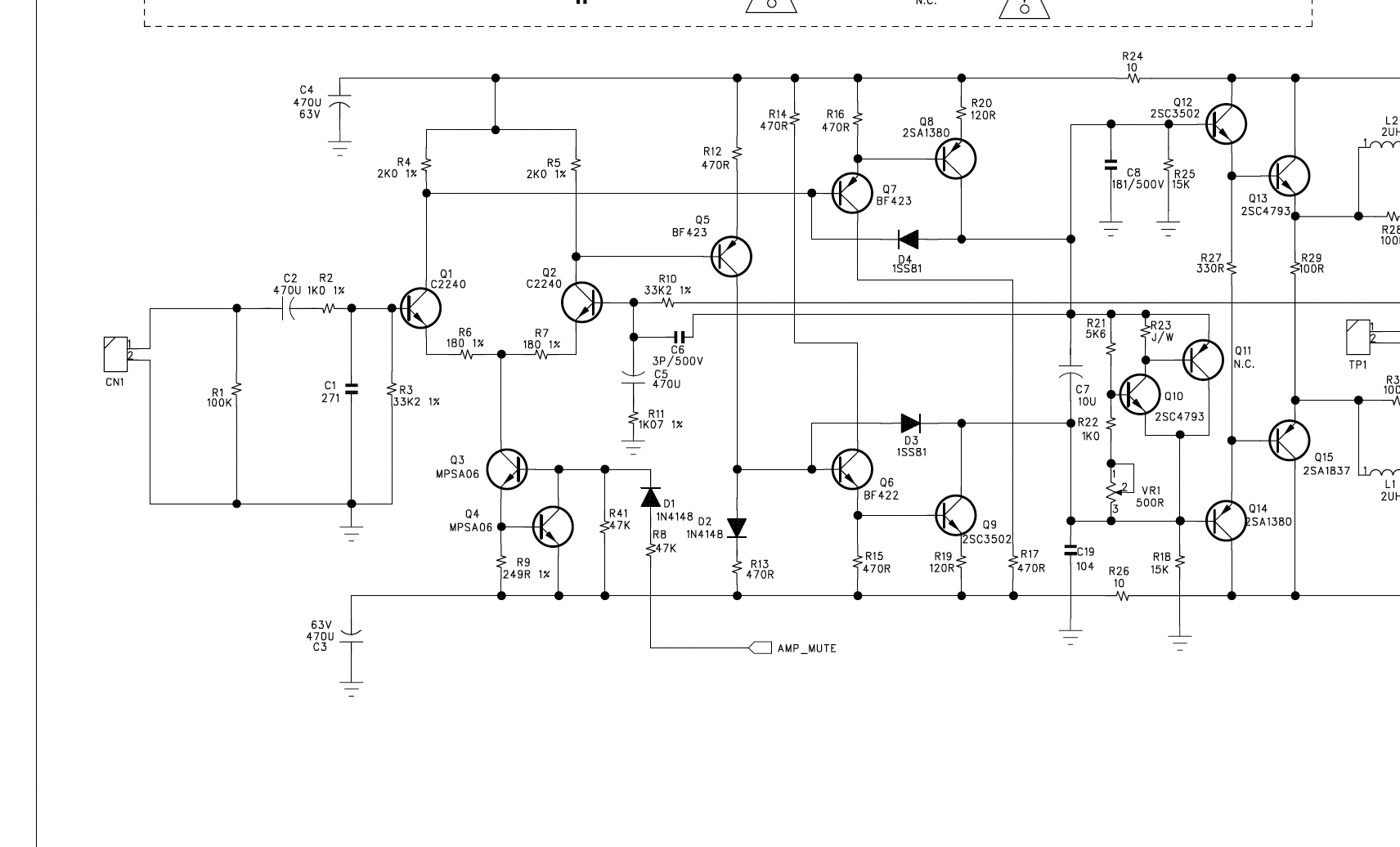

I'm looking at doing this on a HK670, so just wanted to confirm in summary:
Change R6/R7 from 180 ohm to 10 ohm, 1% 1/4W
Change C6 from 3 pF to 5.6 pF, 5% 50V
Add series 860k 1% 1/4W and 680 pF 5% 50V in parallel with C6.
The diagram and part numbers is a little different from what you had in your original post, so I'm going off the attached diagram.
Also - is Ceramic 50V ok for the capacitors? Using Mica and 500V is a lot more expensive.

From my supplier:
@ 680PF the Mica's are $10 ea or a minimum order of 10 units for Foil. There's a 680PF axial general purpose film one I could try?
other Mica's are only available @4.7PF, 5PF or 6.8PF...what value would be best? I'm using an 820k resistor as they don't have 860k either.
