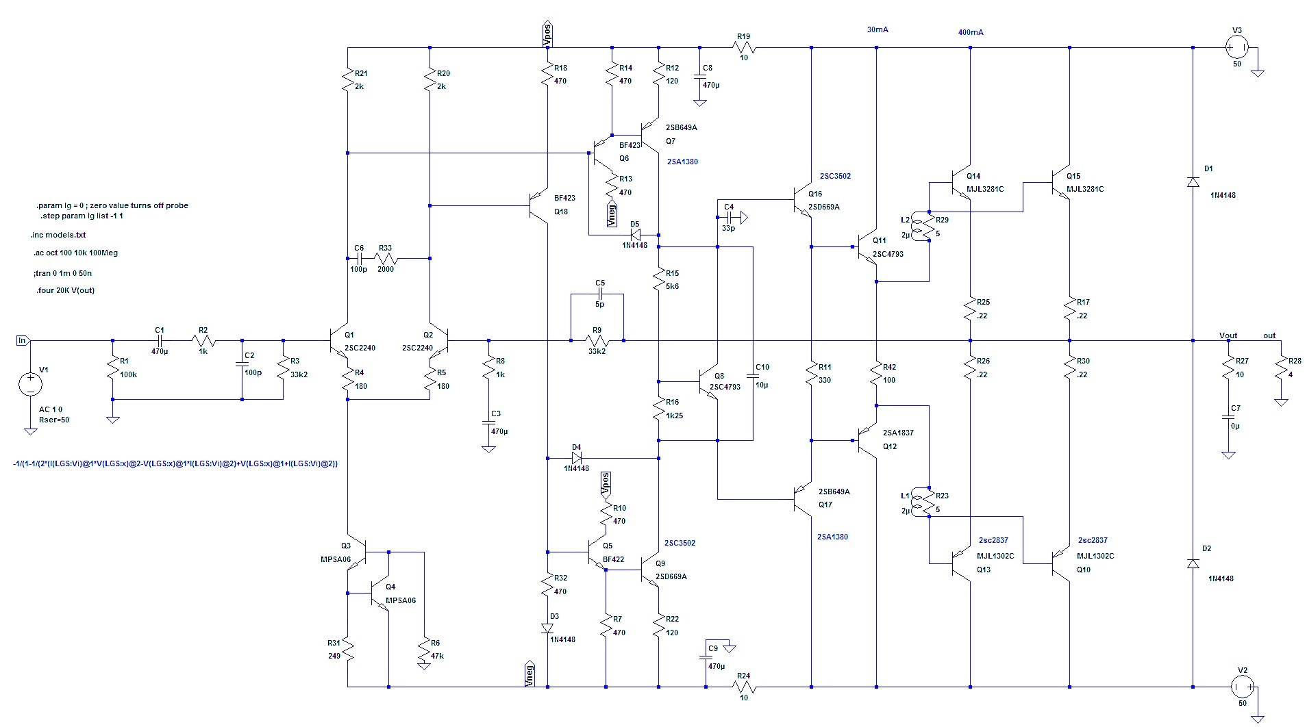

It's the loop gain (not open loop), so it's the gain available for feedback. It's low in this amp, as it is in many of the old simple and good sounding amps. Normal in a lot of modern amps is +50dB, and that usually gives lower THD numbers.
Most of the stages here are used for current gain instead of voltage gain, and that gives it low feedback even if it has many transistors. This is why I liked the design.

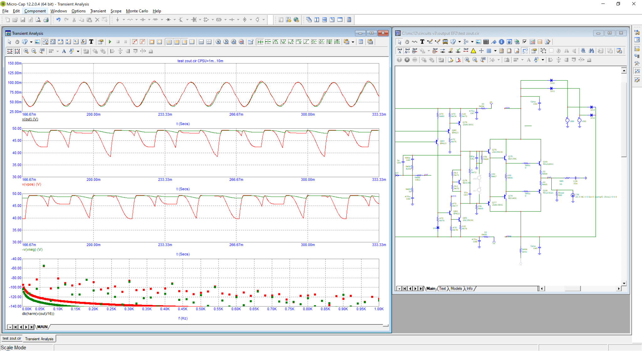

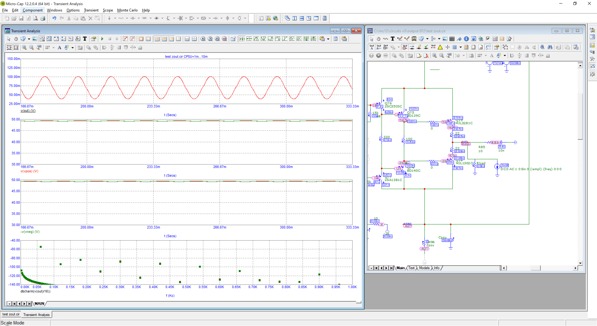

I'm gonna answer here rather than in the other thread. So, about this "bass and capacitors" thing... First with a DC power supply where capacitors don't matter. Signal frequency is 60Hz. I'm feeding 2A peak AC current into the output, so the output voltage is due to the amp's nonlinear output impedance. This makes distortion a lot easier to see.
Then, activating the "transformer" and the rectifiers, at 50Hz. I'm using 30 signal periods, so we can see a complete beat of 50Hz signal versus 60Hz mains. Green is with 10.000µF supply caps, red with 1000µF which is clearly not enough. The harmonics plot in the bottom left looks a lot nastier!
So that supply cap makes non-harmonic distortion... I don't know if that's the cause of the bass feeling less solid, who knows.
Feeding the drivers from a cleaner supply makes no difference.

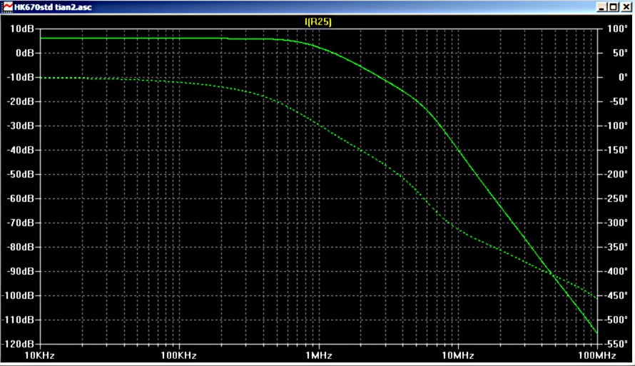

Ah, now I see you wrote here too 🙂 I already answered how I did my sims in your output stage thread: increased impedance DC-supplies to the PS caps, and injecting current (1A) to the output, and plotting the AC voltage of the output vs frequency. I also tried changing the loop gain of the amp, and it has a lot of influence on the output impedance. My guess is that it would influence the distortion too, with less loop gain there is less gain available to correct the supply ripple, so more ripple products get through to the output of the amp.
I'm not sure what you mean? What is better than what?

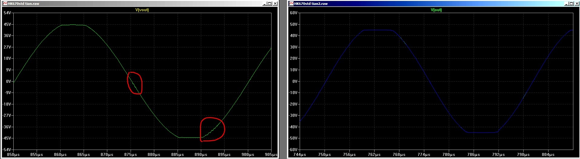

If you are referring to some instability in the sim, I mentioned before that the models for the transistors are not correct.
I did measure distortion before and after, and also basic checks of stability on a scope after the mod, and it looked good. I just used the sim to alter the compensation to have unity gain at the same frequency as before.
