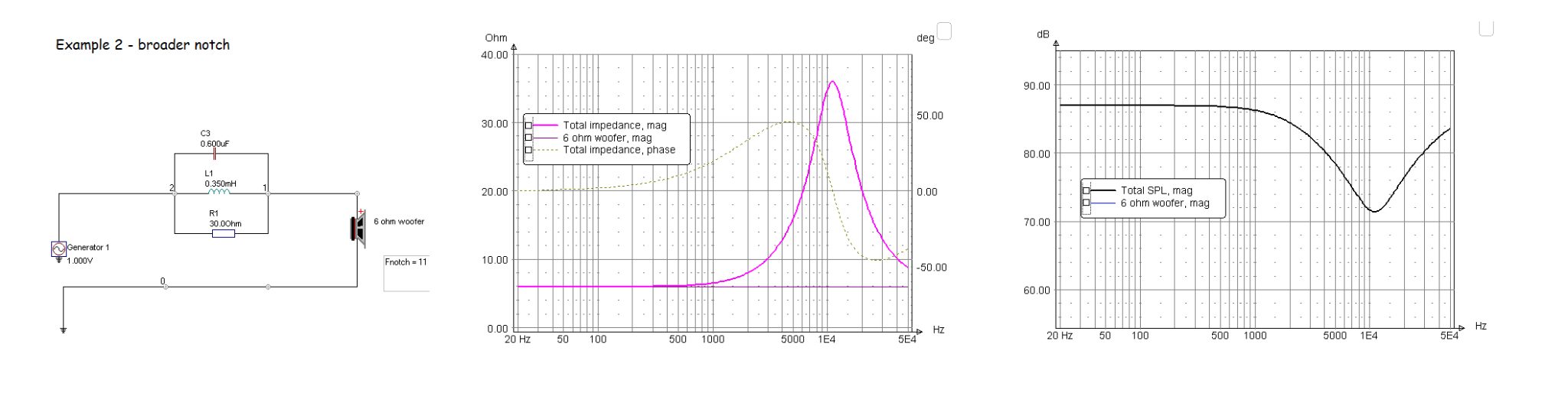

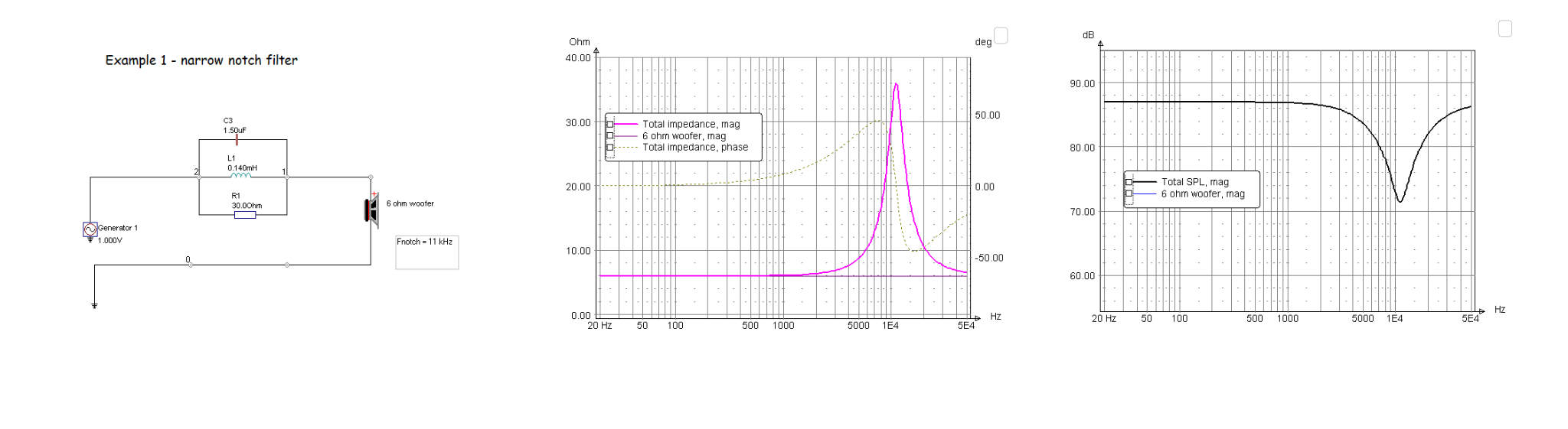

Here are a couple of examples. In each case, the "ideal" driver is 6 ohms (constant), and 87 dB efficient (constant).
The L and C values are changed but maintain the same center frequency. The 30-ohm resistor is used in each case.

The idea to use a notch filter is good.
Paralleled RLC in series, broad enough to give the right Q.
I guess that it can be used alone as the passband filter, but the " high volume" matter puts doubts about the effectiveness in a real design.
