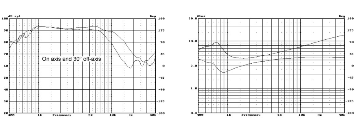

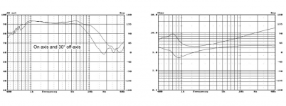

HiVi DMB-A dome mid
Here are a couple of examples. In each case, the "ideal" driver is 6 ohms (constant), and 87 dB efficient (constant).
The L and C values are changed but maintain the same center frequency. The 30-ohm resistor is used in each case.
Reactions: GM
