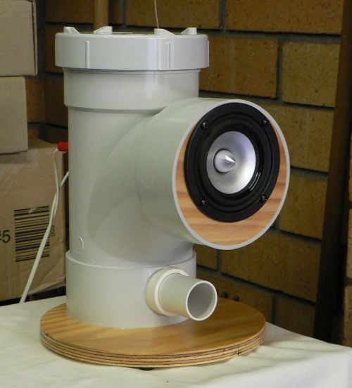

I'm not hijacking the thread, but since someone asked about the Tang Band W3-871SC I thought I'd throw this little one in that was built as a computer speaker. 2dB BSC was a must and a zobel to sort out that impedance rise from hell.
It's a surprising little driver and I don't venture into fullrange territory very often (FR125S, FE127E the only ones), but I had to try a TB driver. It's called the hydrant and no dogs allowed within 10 metres.

Rabbitz,
That is a loudspeaker straight from the comics store. I love it!
Paint it red! It is a vented design? Please post details in a separate thread (it's worth it, I think).

A pair of those would make a great birthday present for my brother. He is very much into home improvement diy stuff, and we share a weird sense of humour together
I'd appreciate if you posted some details on the dimensions of the PVC pipe and port. Schematic of the required correction network would be nice too, I wouldn't be able to figure that out myself.
Originally posted by rabbitz It's called the hydrant and no dogs allowed within 10 metres.
