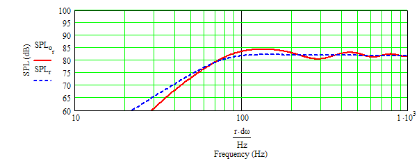

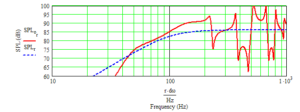

After Planet10 posted the drawing I tried modelling this speaker using MJ King's TL_Offset_Driver MathCad worksheet. I think I must be doing something wrong because the results were terrible (see below). for those familiar with the worksheets I used L = 110.4 cm (a guess), E=0.25, with closed and open ends that are 4.0 x 7.6 cm. I tried no stuffing and then various stuffing densities w/o success.
Any ideas what's wrong?

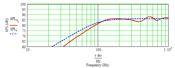

By comparison Zaph's design (a sealed box) for the HiVi B3N looks like this:

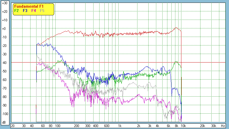

Zaphs tests indicate the NS3 is the best 3" driver for full range use.
The NS3 main advantage is the 5mm one way Xmax and :
compare the low end 3rd harmonic above for the B3S to the NS3 below :

holdent said:After Planet10 posted the drawing I tried modelling this speaker using MJ King's TL_Offset_Driver MathCad worksheet. I think I must be doing something wrong because the results were terrible (see below). for those familiar with the worksheets I used L = 110.4 cm (a guess), E=0.25, with closed and open ends that are 4.0 x 7.6 cm. I tried no stuffing and then various stuffing densities w/o success.
probably not much, since the original design by Udo W asks for a lot of stuffing over the entire length of the line. In addition: which sheets did you use? the old or the current? the current can take into account that the port is on the rear, which might help getting a nicer sim
Greets!
Apparently nothing. That, or I screwed up in a complementary way using the Hobby HIFI dims (no stuffing)/TB W3-315SC published specs:
GM
Ok - I'm getting close to the same sim results as GM using the stuffing density and placement he suggested. (Note to Henkjan - I am using the current worksheets). The sim results both GM and I have posted are probably the "best" and don't account for interactions with back wall and floor.
I went further with the worksheets using Planet10's cab dimensions and did a detailed SPL response calculation to include the back wall and floor with the rear firing port. The best results are acheived when the cab is sitting flat on the floor and as far as possible from the rear wall (at least 1m). Placing them on stands and close to the wall creates deep nulls.

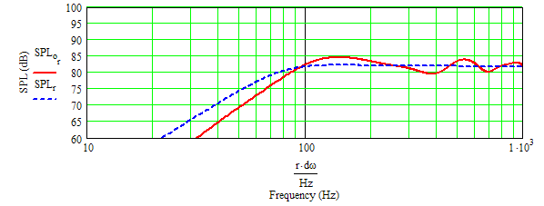

Here's a sample of this design modeled at its best (which is very good) 100m out from the wall and on the floor:
And here it is in a more likely scenario 0.3m from the back wall and 1m up from the floor:
For comparison here's Zaph's sealed box design modeled against the wall 1m up:
And, "the best", against the wall 2m up (which is interesting because Zaph noted that these speakers would sound best "at least 16-18" from the wall" on stands - see http://www.zaphaudio.com/audio-speaker18.html):
Of course these are only modeled results - "in real life your mileage may vary"!

Mine are just simple half space sims using the old freeware PORTED WS since I haven't had the time to get comfortable with the more advanced WSs yet.
I take 'PCTL' to imply sitting on a computer desk near a monitor and other computer accessories, not to mention a big bag of dense damping material (you), so their combined LF/mid-bass/lower mids response will probably look more like a can of worms than a HIFI plot.
That said, I'm kind of partial to this end loaded TL stuffed with my 'best guess' approximation of what it would look like stuffed its entire length with R-19 fiberglass insulation:

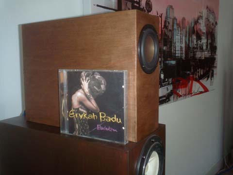

So, this small friend is a beast to tame if I interpret the graphs (Holdent, Sreten, GM; thanks for your work) correctly. Currently, I'm still damping them with just this tiny bit of sheep wool directly behind the driver, on stands and close to a wall (ooh horror; Doc will you never learn?) and I must say it doesn't sound bad, at all. Not big, not completely fullrange, not too smooth but still it images, it produces moderate levels of bass (given its size a surprising amount) and it is a real pleasure to listen to acoustic and jazz music. Even a bit of easy pop/rock.
I reckon from the sims, lots of damping may smooth the freq/SPL graph and I'll certainly experiment with the sheep-stuff the coming days but I hate to compromise dynamics. What do the experts recommend/suggest?

ps. On the pic below you'll see the effect of waxing the veneer and also the kind of music it will not be able to reproduce faithfully (love the CD though).
