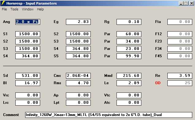

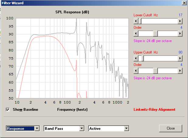

Hi chris661,
Maybe a OD-MLTL (see bjorno's work) would work for you. Here is an example to play around with:
Thanks Oliver, that looks like exactly the thing I'm after.
I've been playing around with tuning that design slightly lower, so that I can run the port along the bottom of the cabinet with a side exit, using the width of a 4x8 sheet as the width of the cabinet.
When time allows I'll fire up Google Sketch-up and see if I can make something of this.
Chris

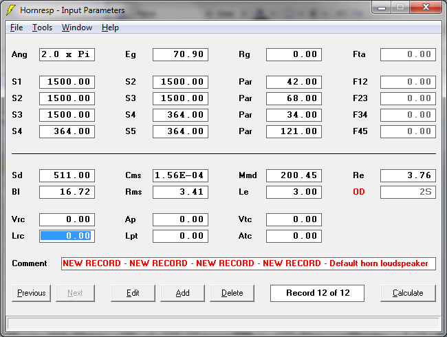

Hi Oliver, attached is a .zip folder that has my sketch-up model inside.
I kept the cross-sectional areas the same, but changed the lengths around a little. I found the alignment was very lenient of the ratio of L12/L23, so, while I made some attempt to keep the drivers equidistant from the port, I didn't put that much effort in.
I'm also using slightly different T/S parameters to you. Presumably you're using a different driver.
Either way, I get a gentle slope down from 90Hz to around 30Hz, and the response rises slightly below that before falling off rapidly. Given comments earlier about low Q sealed boxes, I figured such a response wouldn't be undesirable, with the slight knee providing a "powerful" sound. If I don't like it, I can eq it out. But hey, free headroom.
The port length was changed so that I could use the width of a standard 4x8 sheet as the width of the cabinet. I haven't checked yet, but I suspect this'll go on to one sheet of wood, so I might splash out and get something half-decent.
I'm planning on having the port firing out of the right-hand side, as the entrance to the room is that way and I'd like to add some bright colours.
There's no internet at my new place (yet), so I'm having to travel to the university library to post things.
Chris

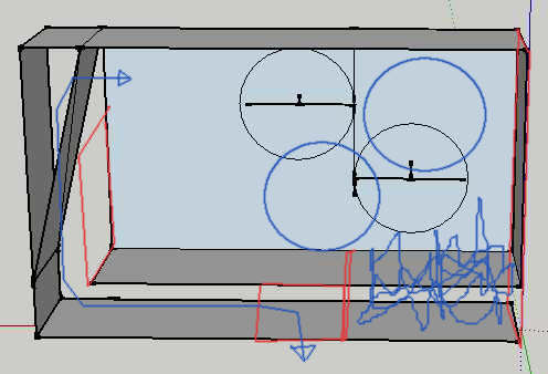

Hi Chris,
That basically looks good to me, and very straight forward. You may want to play around a little with L34=.01 (or so), and the modified layout suggestion in the attachment; I have not put any numbers to the fold, or the (free-hand) filling.
Hi Oliver,
The port will be running along the floor, so I figure a side or front exit is required.
Taking a hint from your suggested layout, I could achieve a front exit by adding a shorter board and keeping the diagonal one. I'll draw this up and see what can be done.
I suspect this alignment is almost acting as a standard bass-reflex, as altering L34 alters the tuning and response shape as reducing the volume of a ported box would.
Rather excited about putting saw to wood some time soon, though of course there's still a bit of work to be done before that happens...
Chris
Hi chris661,
Post #51: "...this alignment is almost acting as a standard bass-reflex,..."
Yes, that's what it looks like, but Martin J. King who did the basic work on the mass loaded transmission line is adamant about the fact that it is a transmission line. It also benefits (needs?) from some stuffing (filling) along the L12 path. Here is a link to his web site: Quarter Wavelength Loudspeaker Design ; and, bjorno has been very helpful in determining the amount and location of stuffing necessary, etc.. For indoor use you may want a lightly slanted response (lower at the bottom end), but in the Hornresp simulation a little hump at the bottom cannot do any harm, as it will be atttenuated by the stuffing, and by the necessary HP filter.
