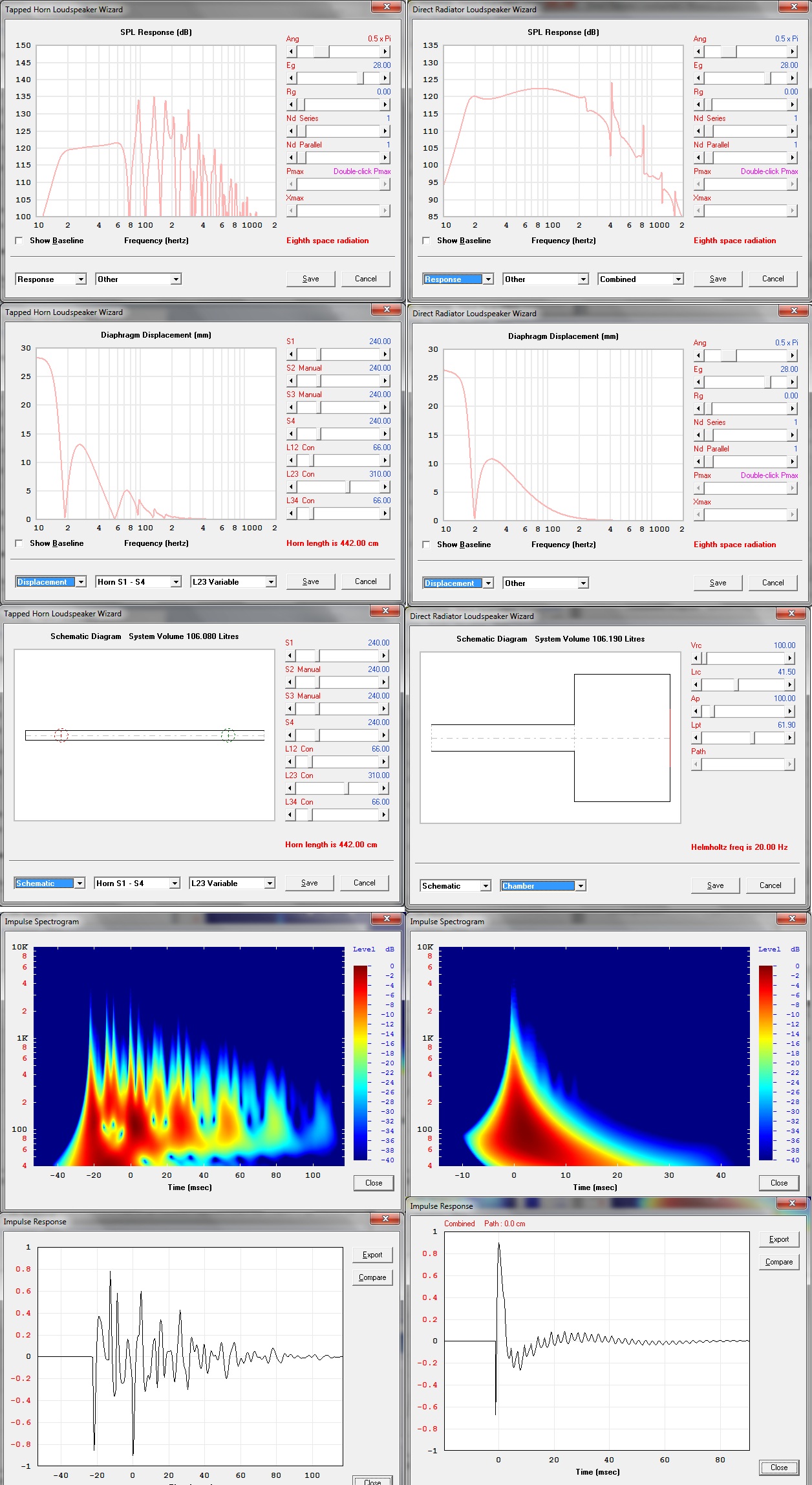

For a ported design, the diameter (and length) of the port would have to be huge to keep air velocity below 20m/s: a pair of 10cm dia vents would be just over 1m long each to get a 20Hz tuning at ~100L cabinet volume.
I could try using these passive radiators, but WinISD reckons that, to keep PR excursion sane, I'd need 50 (yes, fifty) of them.
I think there's an error in the simulation - I'd guess a pair of those PRs would be sufficient, but I have no direct experience with PRs, so if someone could shed some light over here, that'd be useful.

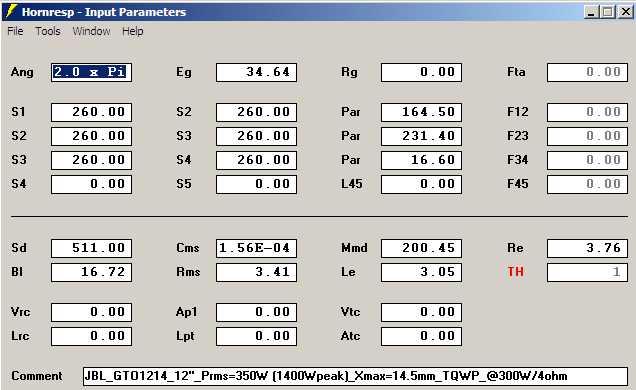

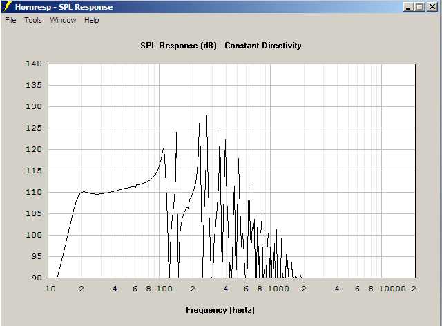

I also tried getting something usable out of Hornresp. A 2:1 compression ratio TQWT (I think that's what this is) comes out quite well, though folding it will be a challenge. For a 240cm^2 cross sectional area, and a 30cm diameter driver, the depth must be 8cm.
The driver's mounting depth is 16.5cm, so I suspect something clever must be done to work around this, if the design is viable.
I have attached some screenshots from Hornresp - comments/criticism welcome.

Hmm.. Been playing with the same woofer with winsd in a ported box and ruffly same size with 3slotports (12cm by 5cm) running on the sides of the box looks doable. Air velocity keeps under 21ms at 350W of input power, only groupdelay spikes at 41ms@20Hz
a 20hz tuned ported box will be smaller but less total output than a tapped horn.
And it is tough tuning that low in a small-ish box with decent port diameter without chuffing.
Then again, a 20hz tapped horn usually gets really nasty around 70hz, eventhough your pics look good.
PR's work very well in that application (small box tuned waaaaayyyyy low), but ideally the pr moves 3 times the air, so use tripple the cone area (passive radiator) for the same xmax of subwoofer, or use a 24mm xmax pr with an 8mm xmax subwoofer.

I noticed, that you simulated one of bjorno's favorites in Post# 23, the tapped quarter wave pipe (TQWP). I've been messing around with this driver (JBL GTO1214TD) in Hornresp for a while, and have a simulation with drawing using this enclosure type w/ a long L12 (offset driver). I'll attach it for you information, you might find it interesting (you are correct, it's hard to fit the driver into that shallow a duct). Bjorno is the expert on these enclosures, he suggested doubling and tripling up on the driver baffle in another thread.
Also, for PR boxes I like Bagby's software Loudspeaker Design Software.
Three of your 12"PRs would work, but they would take quite a bit of additional cone weight.
For simplicity it's just hard to beat a simple BR.

There seems to be something odd happening with Hornresp - when I simulate your design in 0.5pi space, there's a large peak/dip combo at 60Hz, where there's only a tiny notch in 2pi space.
Nothing whacky on the impedance chart, and the displacement shows a tiny ripple at 60Hz.
Very strange.
The long offset does appeal, though - it'd reduce the height compared to the long L23 design I was considering: the only space for this is under my desk, and I'm not sure a 2.5m long cabinet would fit. No tape measure to hand, either.
Using myself as a ruler, I estimate about 5'8" length available.
The full-height option of your design would fit, but I'd probably build it with the top section removed to keep the build easy.
As you say, though, a ported box would be the simplest option, and will probably be the one I go for - PVC tubing is cheap.
