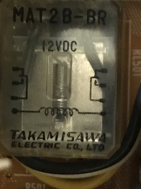

Thats the good news, bad news is I was trying to figure out the current to the lamps so I could source new ones and when I touched the multimeter to the bulb leads the unit went dead. I had already checked voltage at 5.96V.
I've checked all the fuses they are all fine, not sure what to check next, the protection circuit? Main power switch?

If there's a protection circuit which has electrolytics I would think about possibly replacing these - if they go out of spec the protection circuit can play up, which could lead to issues, and even lead to it failing to protect (or spuriously going into cutoff) - this seems to crop up regularly as an issue in older amps here and is probably worth anticipating.
Its only electrolytics that go dry with age, and if there are many you can wait for issues to arise (replacing them all carries some risk of track-lifting or error and can be quite tricky and arduous). But I'd suggest making an exception for protection circuitry.
Thanks for the reply Mark, here's a picture of the "device" that doesn't seem to be doing its job anymore. It used to be engaged when first turning on the unit (a corresponding red light would light up) and after 2-3 seconds there would be an audible click from this unit and the unit would be operating, red light out.
Now there is no red light and nothing from this device, circuit?

Hi, John! Have you fixed problem with protection module of your SR-804? If not, I'm think you need check protection circuit of IC501(HA12002). I mean, you need check fuse F002,then measuring Vcc on resistor R504, then check cap C502. By the way, you have got the Service Manual SR-804 ?
