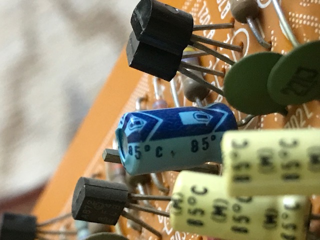

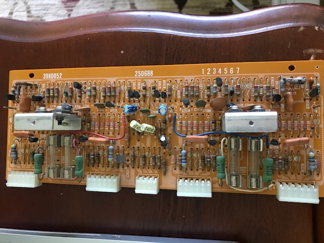

I had a look inside and the only caps that visually looked like they might be bad are 2 on the main P.W.B. #'s 703 Left and Right.
Pictures attached.
They are listed as Electrolytic 47uF 6.3v
Pictures attached.

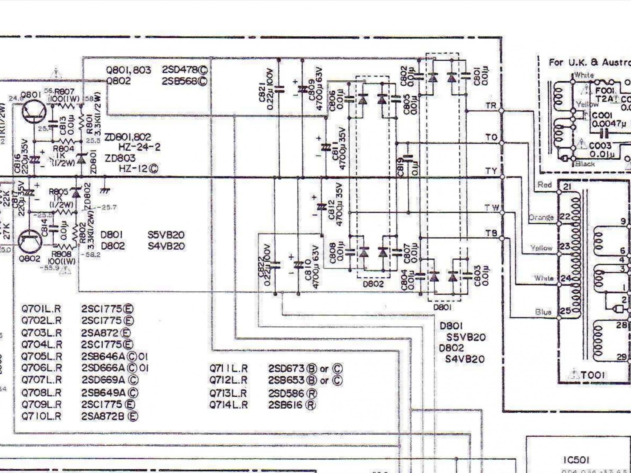

gannaji is right! - So is amplidude. When powe supply caps dry out, their capacity goes lower - as in less uF effectively (100uF measures 5uf for example) - then the B+ or B- rail can become modulated by the amp's circuit. As the circuit draws current, the amp starts behaving like a low frequency oscillator. Your bass driver starts pumping back and forth as +/- 50 peaks are being pumped out by the amp. After a while, your voice coils in the speaker will fry - as you describe. It sounds like the put-put of a motorboat...! So YES: start recapping and see if the problem does not go away. - Even if it turns out to be something else, your old amp will benefit from a cap overhaul. Good luck!
