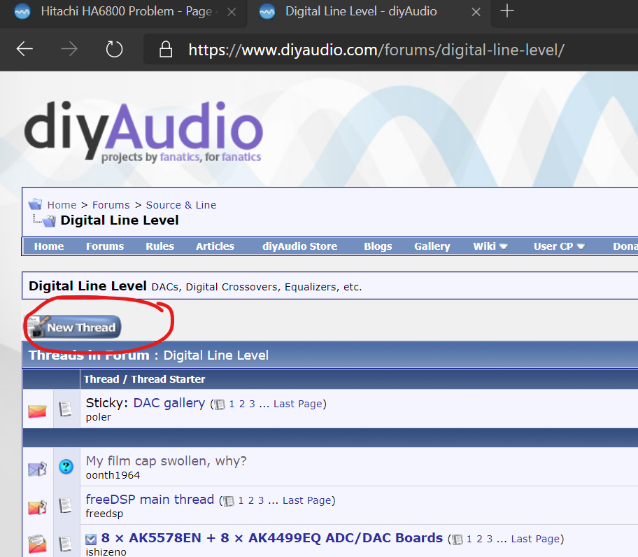

Hello, Everyone
Just to change the subject for a while, I need to start a new thread on another topic -- How do I do that?
Thanks, and Kindest Regards
Telnet100
Telnet100
